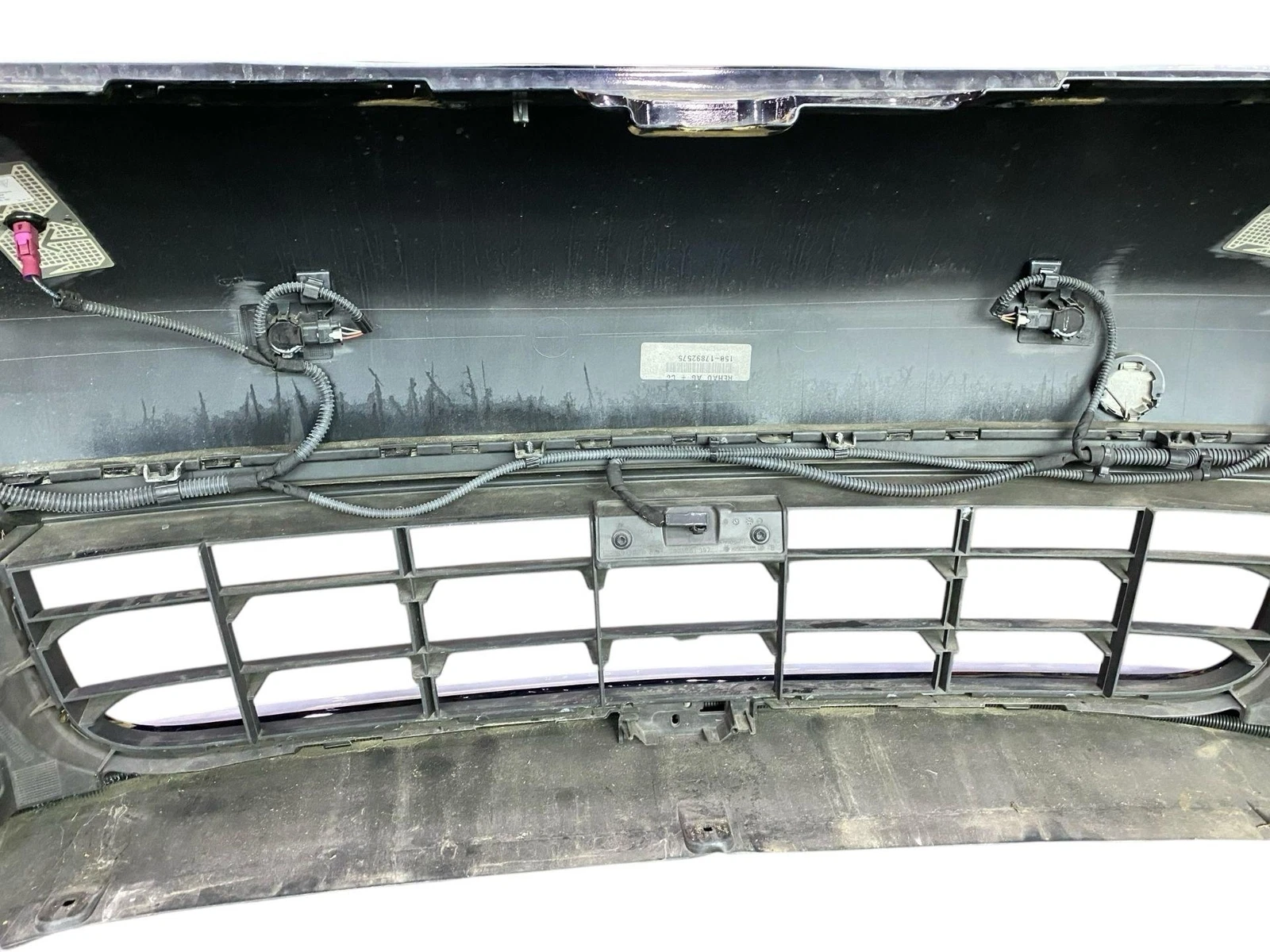

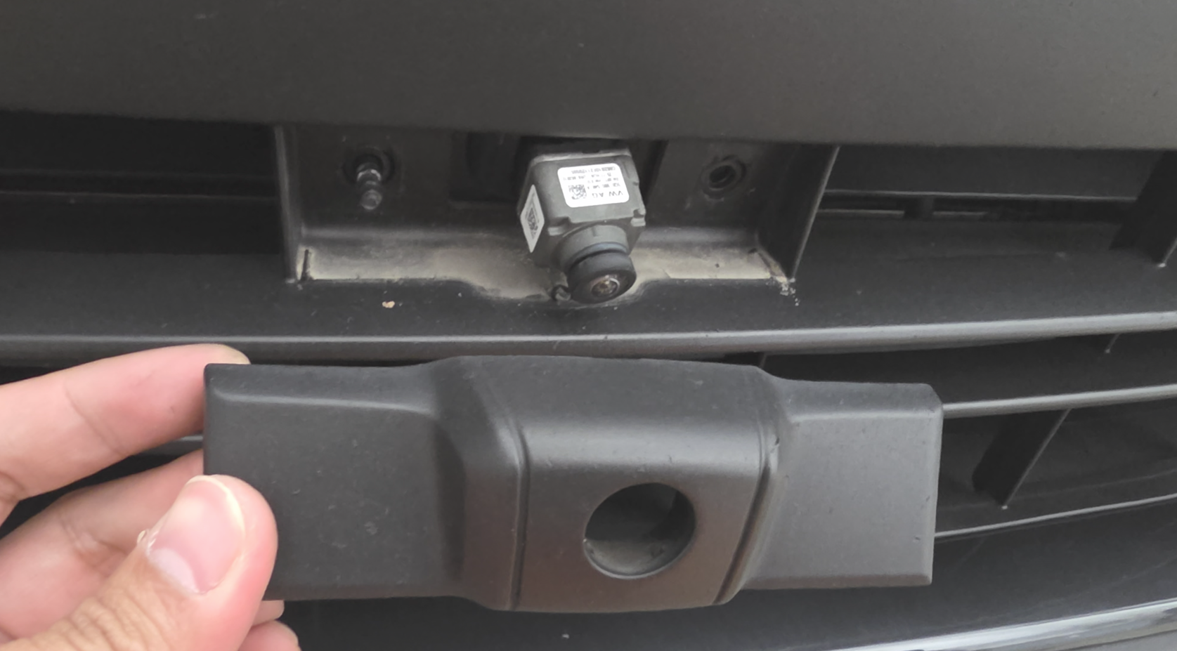

I have been meaning to do this with my 971.1 Turbo (non Sport design bumper, but I do have night vision assist for more room) -- for me there is enough room in the grille spacing for me to stick my hand in and feel around. I was able to unplug the connector and feel the torx heads. I have the same part 5Q0 980 546A, superseded by PAB-980-546 according to online parts sites and I verified the part numbers on PETKA.
This is on a non-Turbo, non-Sport design bumper for reference, it may be harder here since there is less space in that grille:

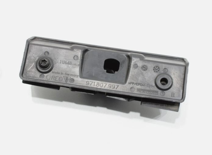

Here's the housing for the camera on 971.1s at least.

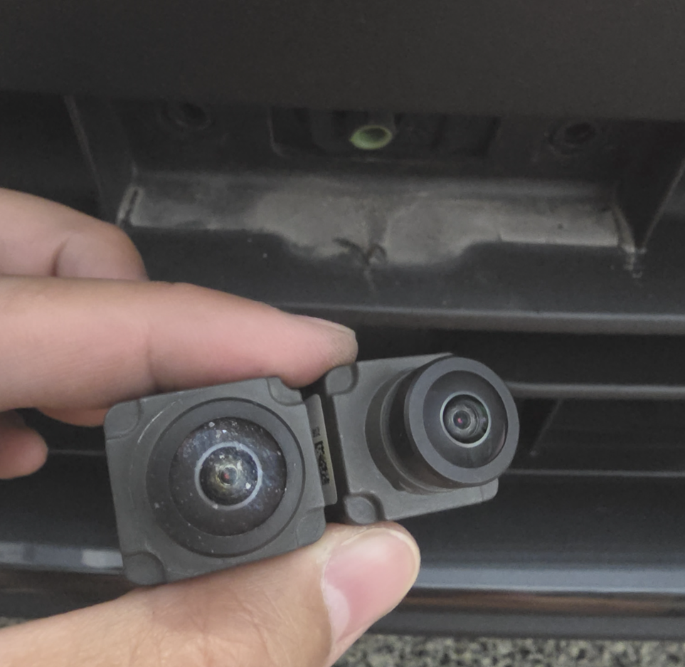

I did this today, was able to R/R the front camera without taking the bumper off. Two T30 screws from behind.
Amazon has these for cheap -- 5Q0980546A
