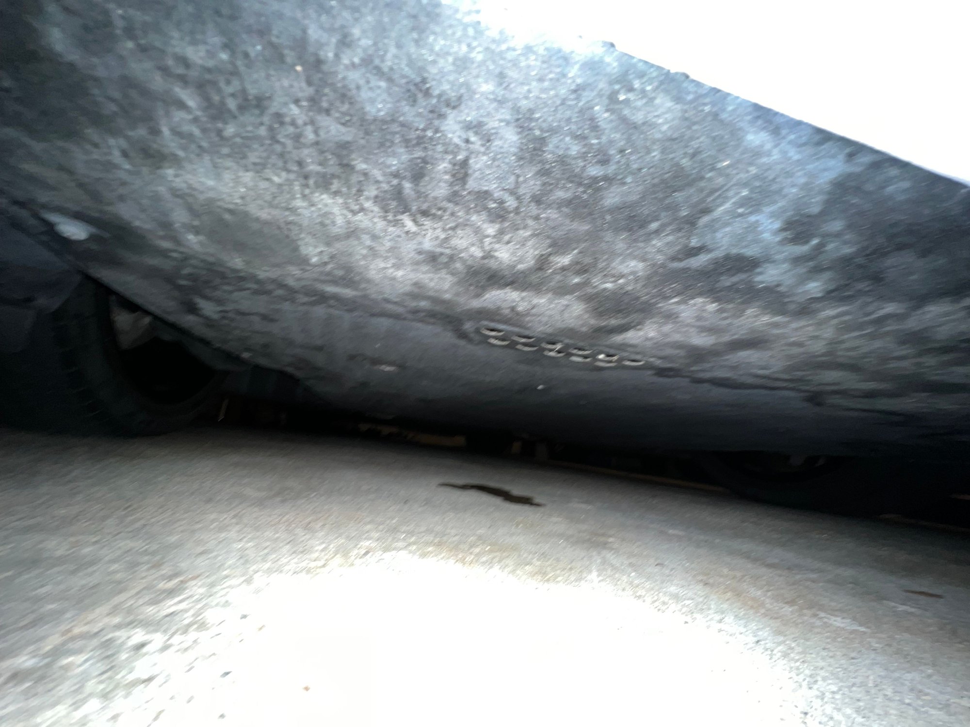

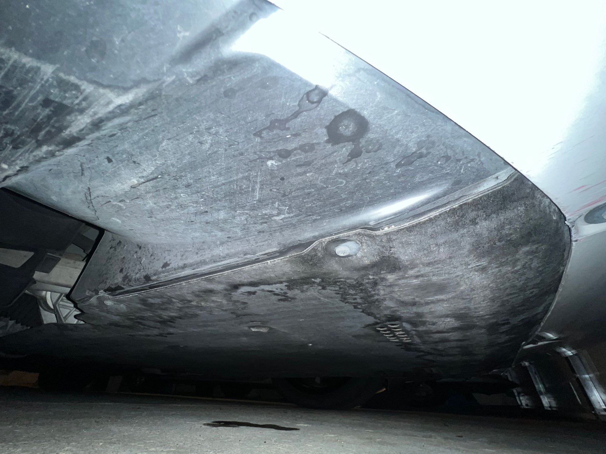

2022 GTS
20k miles
realized a small puddle as I pulled out. Definitely oil and seemed fresh. I don’t see any very wet areas under the car but anything I should tell the dealership? New to the Porsche brand.

Need to find where it is coming from, or take it to the dealer.
Did you have a recent oil change done?

The underbody cladding should removed for a better look before the speculation starts. Take it to the dealer.

If its leaking through its a much bigger oil leak than you think. The under engine cladding has a pretty good absorb felt pad built in. It takes quite a bit of oil to soak that to get your garage floor.
My best guess is its coming from either the oil filter housing or one of the oil lines running in the V of the engine, could be an oil cooler or one of the lines. These seem to be the most common places for leaks on this engine.
Get it to the dealer since its still under warranty. None of the parts are expensive but labor is what gets you on these oil leak repairs especially if its one of the examples above if your out of warranty.

My dealer said it was old residue that may have came off from the undershield. They could not find any signs of leaks or anything. Even showed me a video of the underbody and I also couldn't see leaks. Ever since, I've had no problems. Hence, why perhaps the cold is just causing some "melting" from cold/snow from your underbody... at least that's what happened to me. Good luck and let us know if you're scenario is any different.

My SA just called. It was the oil filter housing. He also said my water pump is leaking slightly. I have been smelling coolant just barely for a while now but never did see the level drop. I am guessing the oil housing gasket shrunk up from the cold and either started leaking or went from a weep to a real leak.
