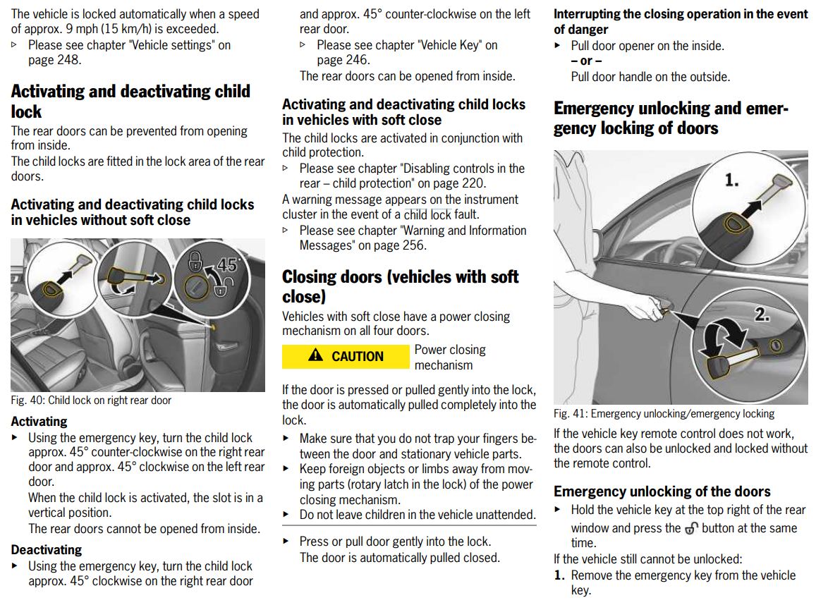

The power window and non-functional side markers are concerning. Is this a brand new vehicle?
I have not experienced these issues all at once.
For my vehicle, I know LCA errors appear when I have a lot of dirt on the sides of the rear bumper:
ACC not available has appeared for me separately when the radar sensors are dirty:
As far as child lock fault, I haven't had issues with that but that's because I don't use this feature:

Thanks for the reply mate, it's a 2018 Panamera. 54,000 miles so I'm just out of the warranty period if I'm correct.
Radar domes are clean and nothing really out of the ordinary.
I notice that the small light on the drivers door, to set the memory function isn't illuminated also, so again, leans towards no power on the drivers side?
I'll try disabling the child lock with the key like the illustration you posted, hopefully that removes one of the notifications temporarily at least.
