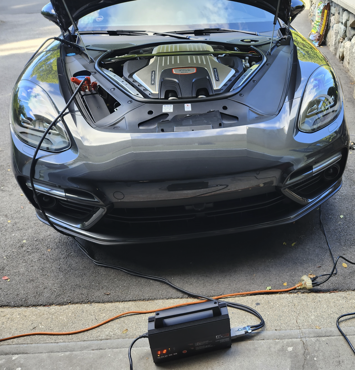

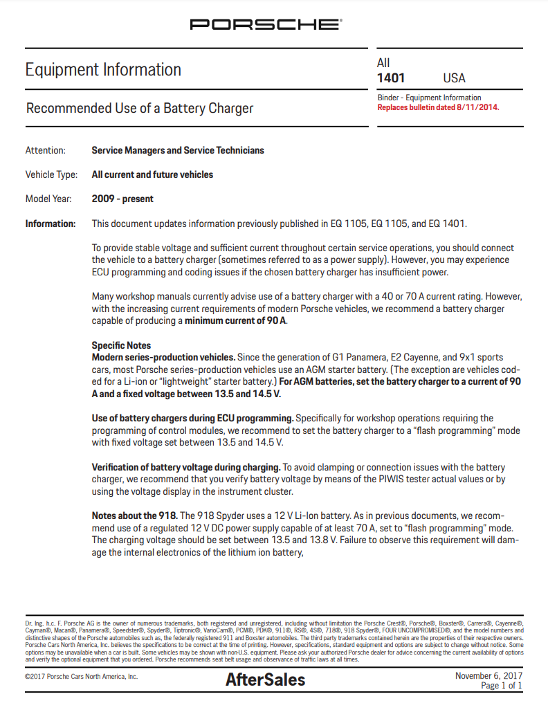

You'll want something that can supply 90A of current at a fixed voltage between 13.5-14.5V
Personally, I went with the
Schumacher INC100 Schumacher INC100

I use a power source. Battery charger may work but also may not work — most are not steady power sources. A few higher end ones have that feature but probably not at the amperage you want. I have an MST 80+ but there are others of you google 12v power supply for car programming.
