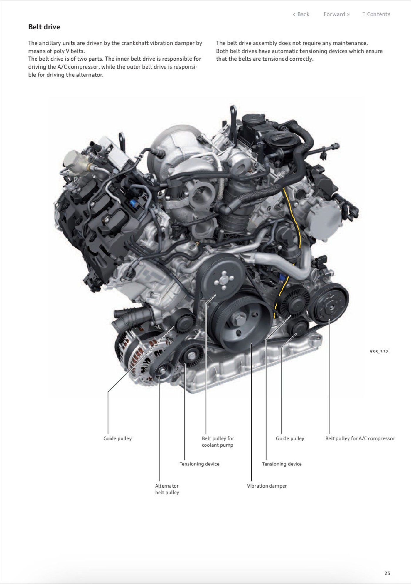

Originally Posted by PanameraCharger
Oh and another thing. There’s no fcken oil dipstick. Smh. That electronic level isn’t always accurate
There is a dipstick tube on the V6 audi engines (yellow line in picture below), just no dipstick. The tube is plugged. I have seen people pump out oil through the dipstick tube during oil change. I am going to try that next time. Save a lot of time removing the bottom cover.and remove drain plug.
