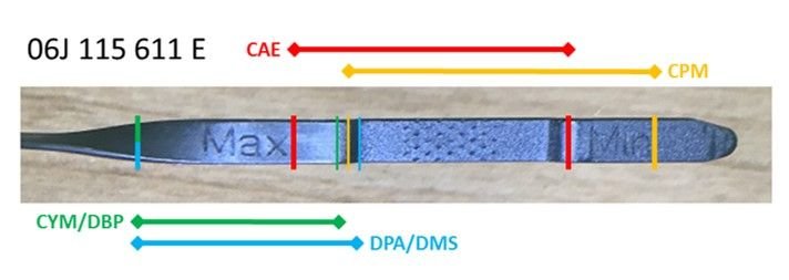

For longitudinal applications (Macan, Audi A4, A5,Q5, A6) of the EA888 2.0T engine, there is no dipstick that was made for this engine. All these applications have the electronic oil level monitoring system.
For transverse applications (Golf, Jetta,Tiguan, Arteon, Q3, A3, TT) of the EA888 2.0T engine, there is a dipstick available (many of these models do not come with electronic oil level monitoring), but the markings need to be "adjusted" for use in a longitudinal engine application, due to the different shape of the oil pan. The longitudinal and transverse engines are identical, EXCEPT for the motor mounts, turbo ducting geometries, coolant pipe geometries, hoses, and the oil pan.
I use dipstick pn 06J 115 611L in my 2019 Macan Base 2.0T (my engine code is DLH), and the oil level readings correspond to the picture below, for the blue DPA/DMS range. Your engine code, sn, and production date can be found on the white rectangular decal on the front of the engine, on the black plastic upper timing cover.
And yes, the above picture indicates that this is an "E" dipstick, and I have an "L" dipstick, but the blue range seems correct, based on me refilling the engine with 4.2 litres (min) and 5.2 litres (max).
This picture came from another VAG enthusiast on the Audi forums, so I can't verify really what the difference is, if any, between an L and E dipstick.
Make sure you buy a genuine VW/Audi dipstick from a VW/Audi dealer, not a knock-off, as some of the knock-offs are not the correct length.
Also note that you can't keep the dipstick inserted when not in use, as the yellow handle hits the plastic engine cover.
If anyone buys a genuine E dipstick, I would like you to measure the dimensions so we can compare and see what the differences are.
