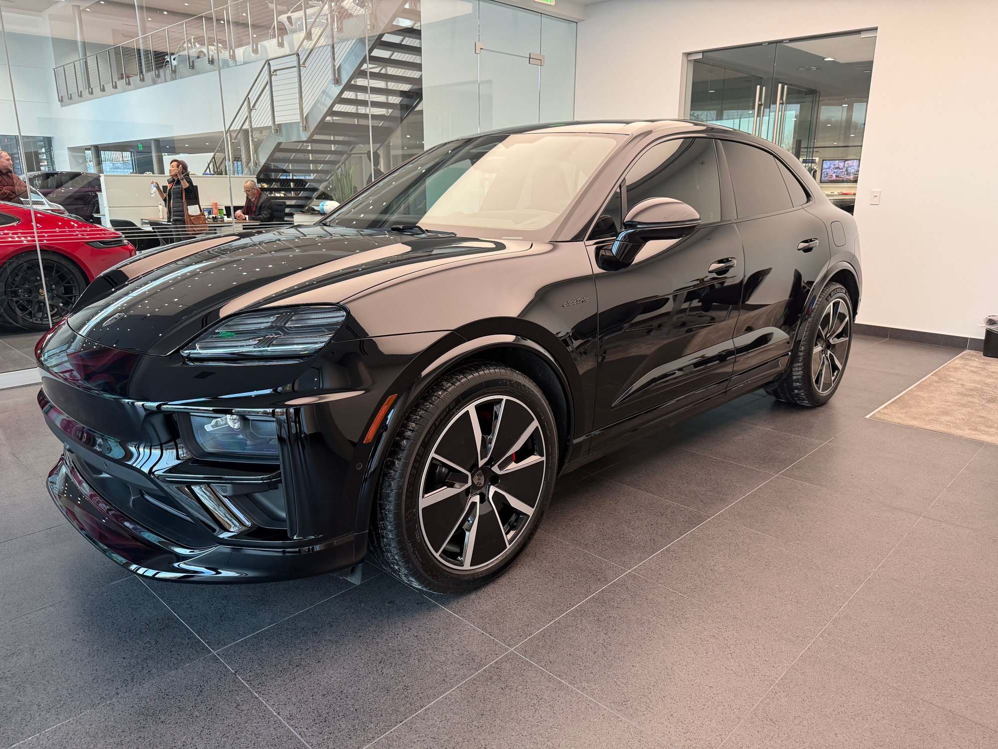

Picked up my Macan Turbo EV today. Looks, feels, and drives like a Porsche. It's fast, but not too fast (acceleration is less pronounced at high speeds). I'm happy (so far) with the purchase. Kind of reminds me of the 992.1 Turbo S.

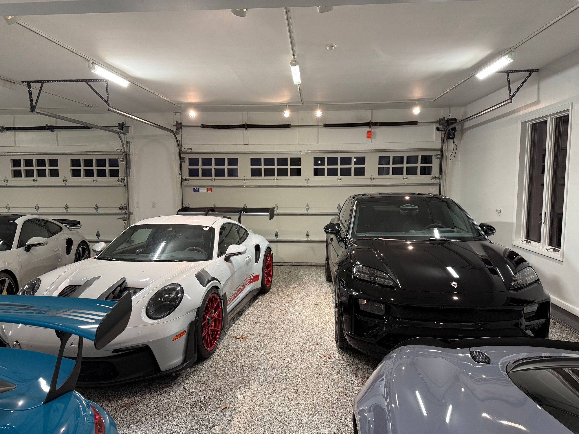

Wow - congrats, and what a garage! I’m not a black car guy but I sure appreciate how great they look for the 30 seconds that they are sparkling clean!

Yeah, it's very black, like drug dealer black, but I like that for this menacing turbo ethos. My plan is drive it in all weather (will get the winter wheel/tire package for next winter) so, sadly, it won't be clean very often.

I've highlighted my preferred EV charger (EVSE) locations in your garage…in the pic below.

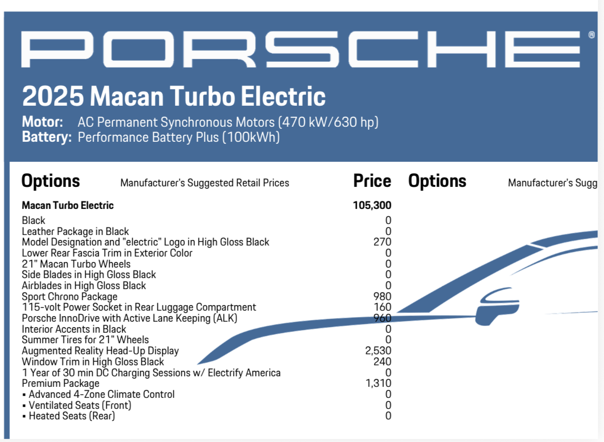

window sticker please? for options list ;-)

Middle position seems best for the charger, gives more flexibility on where to park the Macan.
Window sticker MSRP was about $113k, building it today would be about $123k MSRP, I paid $95k as a CPO with 4500 miles on it. I think it's a great vehicle, but at $123k Porsche would be asking a lot, given that the rear seat legroom is pretty limited, so the utility is significantly less than a Cayenne.

I agree on the EVSE location - a good EVSE with 25 ft cord will allow maximum flexibility for parking location and still being able to charge.
the Porsche Universal Charger that's included with the vehicle is sufficient but no one's favorite chioice…
I recommend one of the following EVSE's on a hardwired circuit 60 amps if you can…
  • Porsche Wall Charger Connect - for that Porsche design language "feel" - J-1772 25ft cord - adjustable amps from 20-100 amp breakers…
    • hardwired
  • Tesla Universal Wall Charger - many many features - Dual charge port support - NACS & J-1772 - future proof - 25ft cord - adjustable amps from 20-60 amp breaker
    • hardwired
  • ChargePoint Flex - many many features - can be J-1772 or NACS cord - swappable - 25ft cord - adjustable amps from 20-70 amp breaker
    • ​​​​​​​hardwired, NEMA 14-50, NEMA 6-50 choices
if you're going to run the EVSE included with the vehicle - get a NEMA 14-50 Hubble Commerical grade NEMA outliet _OR_ EV rated Leviton outlets - "lesser" $12 NEMA 14-50 outlets don't handle the thermal loads of multi-hour charging session and can fail in spectacular fashion…don't settle for a non-commerical outlet - Porsche specifies part numbers in a tech bulletin I can share if you like…
the Macan's maximum charge rate is 9.6 kW which is 240V at 40 amps on a 50 amp breaker - but installing a high capacity EVSE 60 amp or more is preparation for future EV/Hybrid's which support higher residential charge rates - the Cayenne EV for example has a 19.2 kW on board charger option - that would require Porsche Wall Charger on a 100 amp breaker as an example.
the main hassel with an EVSE install is not the size of the circuit but rather getting the work done and permitted - my philosophy is do it only once and get a high capacity install so you don't do it again in the future:
  • Good - NEMA 14-50/6-50 EV grade outlet - 50 amp breaker is max size for plug-based EVSE install
  • Better - Hardwired EVSE 50 amp breaker or larger - 60/80/100 amps would be good
  • Best - 125 amp sub-panel in the garage and one breaker in the subpanel for your 'first' EVSE - 50-100 amps
    • the subpanel makes it less work to add a 2nd EVSE install in the future…
