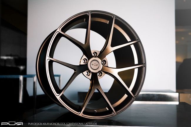

Thank for the help i am debating on the following wheels in satin bronze.

is the rear flush enough or do i need to have a more aggressive offset?

The stock rear wheel already sticks out a tad from the fender, so I definitely wouldn't go for a more aggressive (lower) offset. The front is already basically flush too.
