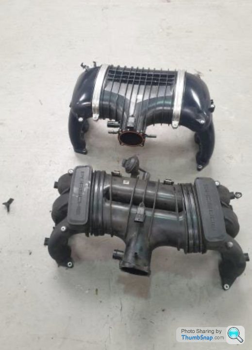

various threads here indicate that the IPD alone did not make a lot of difference, need to add Dundon intake runners to it to get the benefit. Alternative is the porsche 718 GT4 clubsport intake (available thru BGB Motorsports budget USD4k plus fitting and tune) but I haven't seen the dyno runs yet to understand the trade offs.

I am looking at the Soul performance race headers. Are these the clubsport intake runners your talking about https://www.ebay.com/itm/Porsche-Cay...8AAOSwvxBel2VL ? I want to take it to the track few times. I want to add power mods first. I race kart's so that is my fun for racing. Does anyone make a 93 octane tune?

^Don’t touch those intake runners, they got herpes

just asking what is wrong with them, Are they just stock ones wrapped with heat resistant material?

they look anemic compared to the girth of dundon intake runners or the 718 CS IM

Here is a comparison. Possible the Ebay ones are for 981 GT4 clubsport but the above compares standard 981 GT4 and 718 GT4 intake.
To me the 718 looks smaller but that engine makes more power than the 981.
