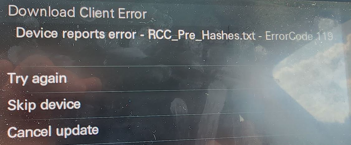

Just tried to update, no luck.
After inserting the SD card it reboots then I get this error. I can't find that file on the SD card.

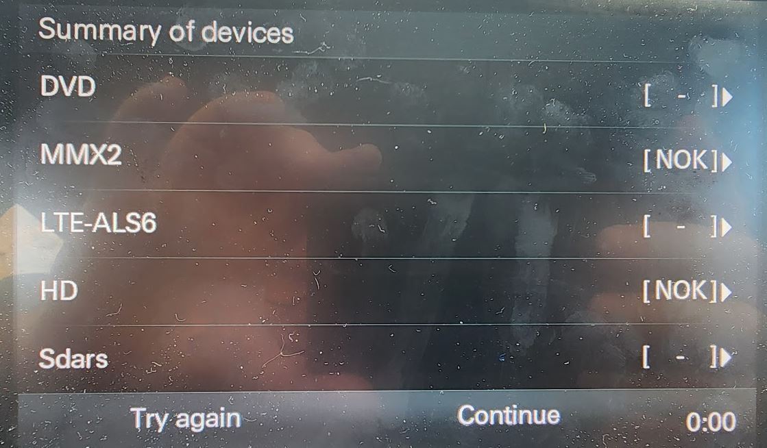

Hit cancel and it reboots. Then it goes through summary of devices. Some have just a dash, others have NOK.
MMX2, HD, IOC, RCC, Gracenote2, SpeechAppRes, SpeechRes, sirius, MUConsistency - all have NOK on them.
After touching Continue, another reboot, asks about doing a backup, press cancel. Then it reboots again and goes back to the normal PCM 4 screen.
What am I missing??

Joined the Telegram chat. Evidently what I grabbed off the GitHub page is just source code, about 15mb. Full AIO is 1.7gb. Hopefully the download page will come back up.
Unless someone has the 1.7gb download... Bueller? lol
