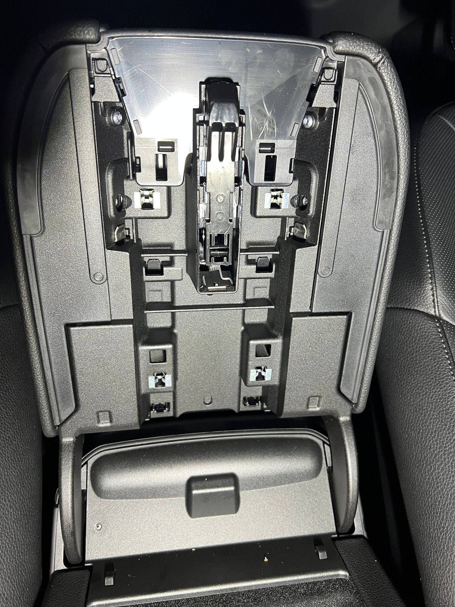

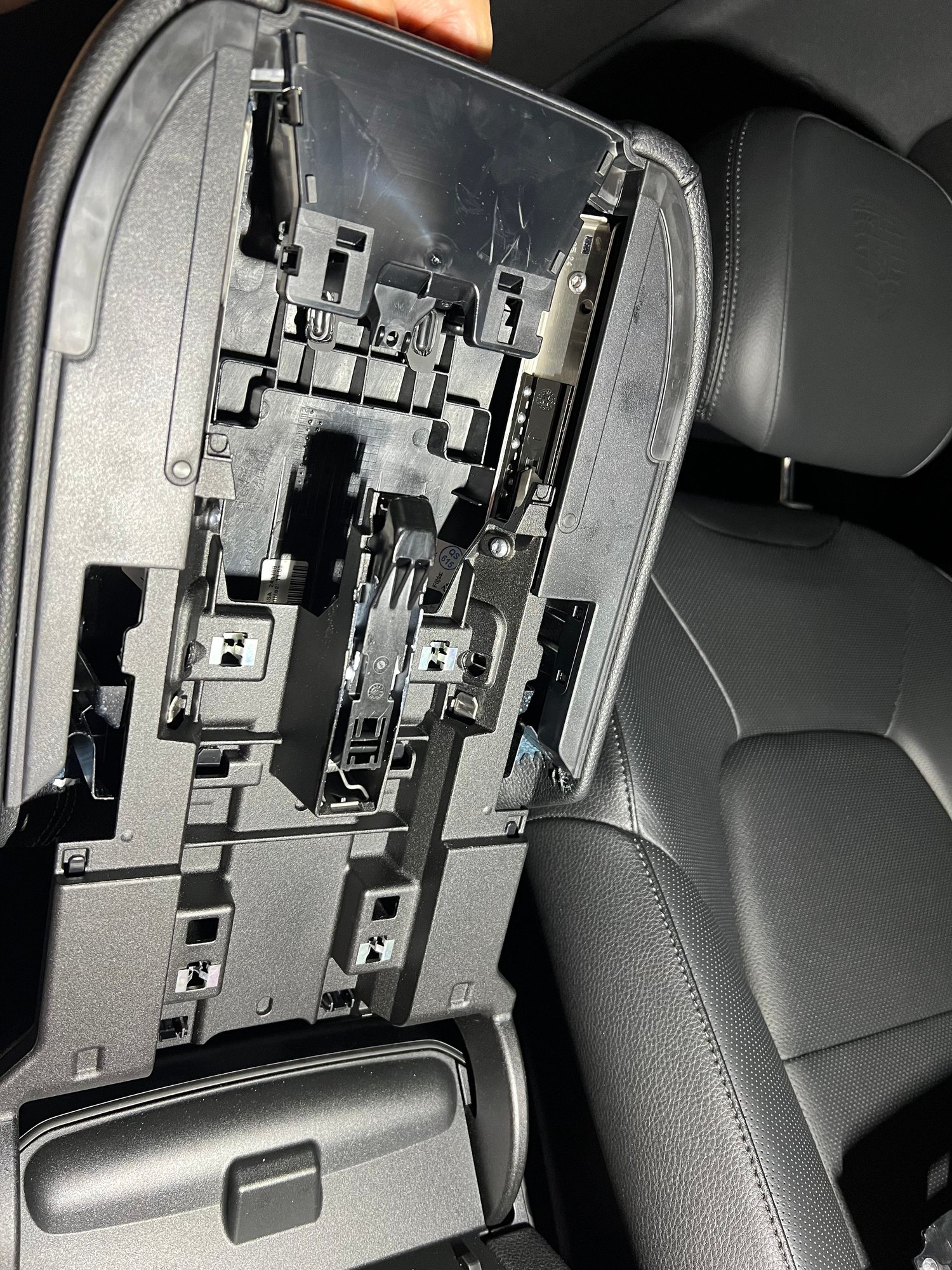

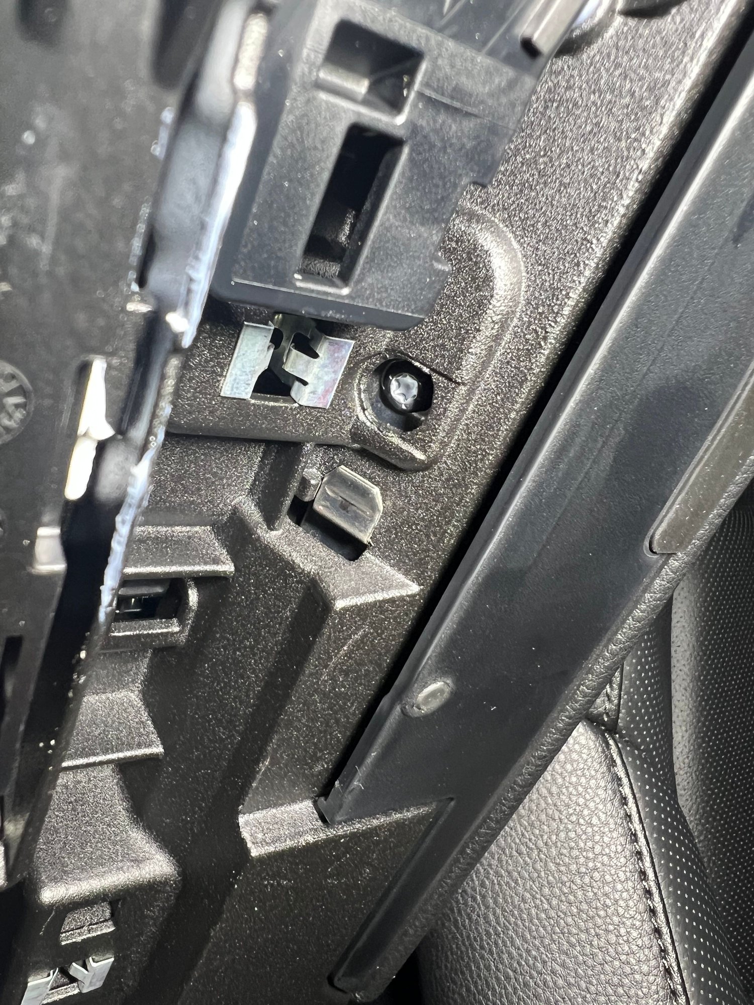

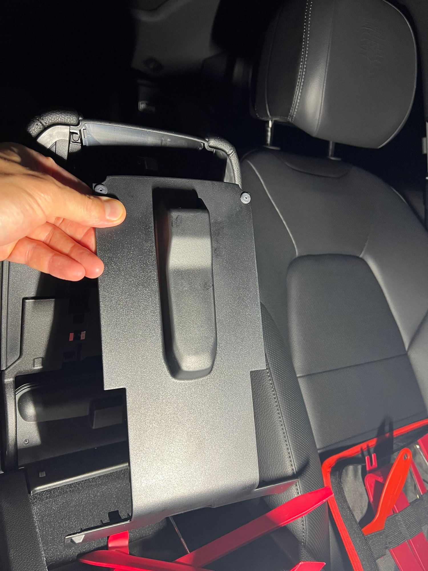

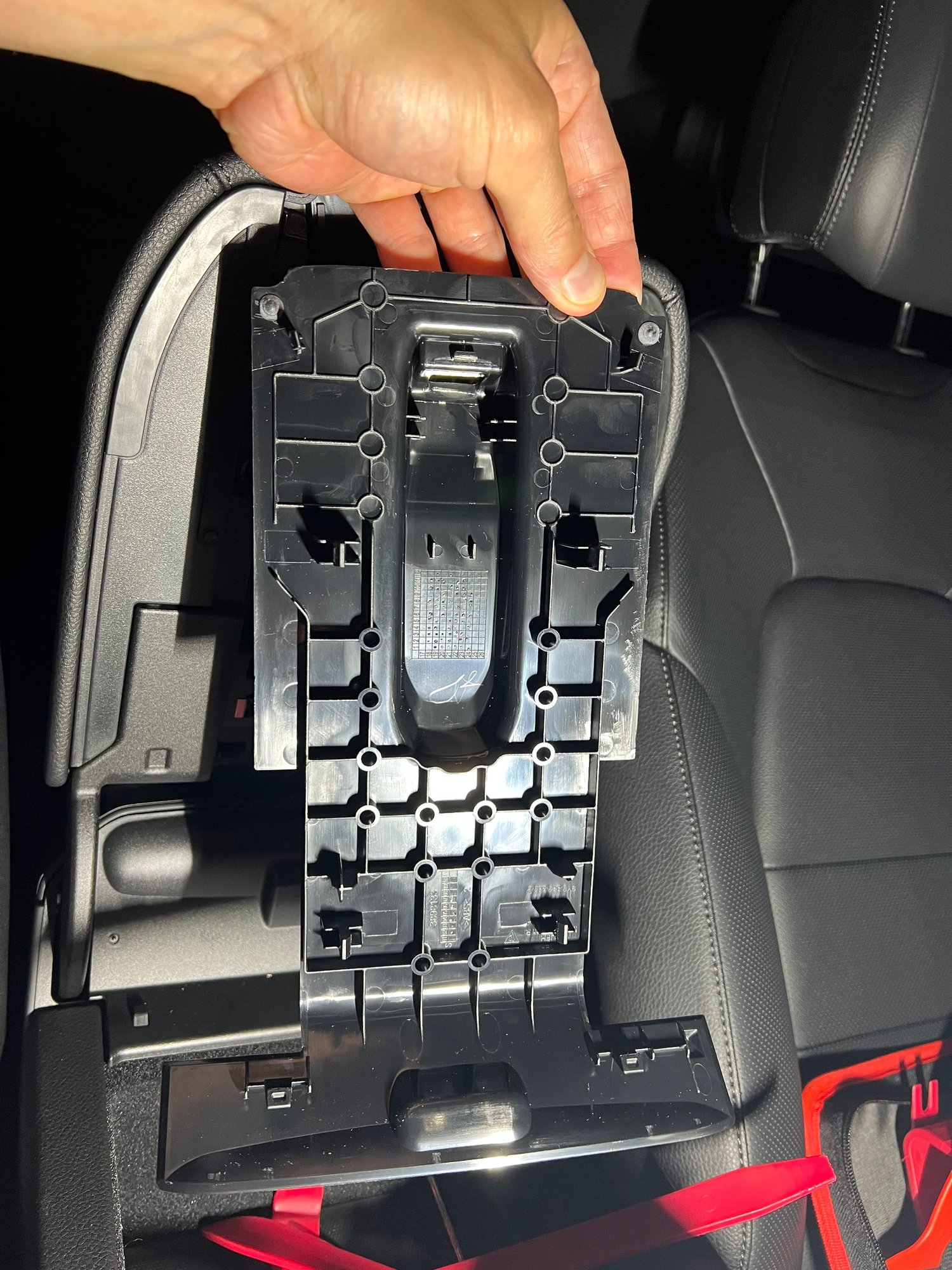

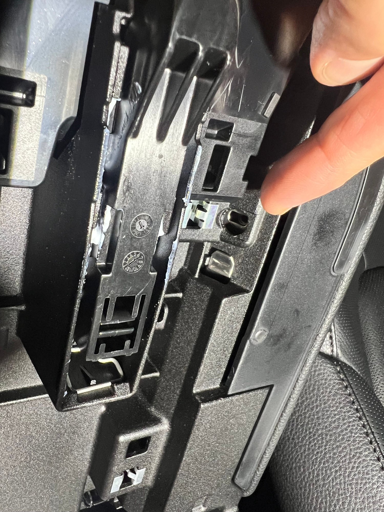

One of the things that bug me in my car is the squeaky center armrest. I had a bit of time and decided to see if I can disassemble the armrest to check what it looks like and possible solutions to be applied to my car when I get it back. I searched the web and the forums but couldn't find a guide, so I dove in.
Please see my pictures (sorry dark car at night) but I was able to very quickly remove the first cover with plastic tools (insert plastic tools around the perimeter and then gently push up to unclip, depress the locking tab so the cover can slide out) and then identified two T15s which I removed. As I lifted the armrest to see what other bolts/clips I need to touch the armrest extended! I couldn't believe it! These two T15th is all that is standing in a way of going from fixed to sliding armrest. It really is that easy. Plastic cover then snaps back on and that's it!
Please keep in mind, this is on a 2025 US model, so other years may differ. I will have to try it on my 2023 once I get it back. Outer plastic cover - held by clips
the other side of the outer cover
underside of the armrest once the cover is removed
this is the T15 that you need to remove
T15 removed - one on each side
underside view - not extended
underside view - extended
final view
final view
