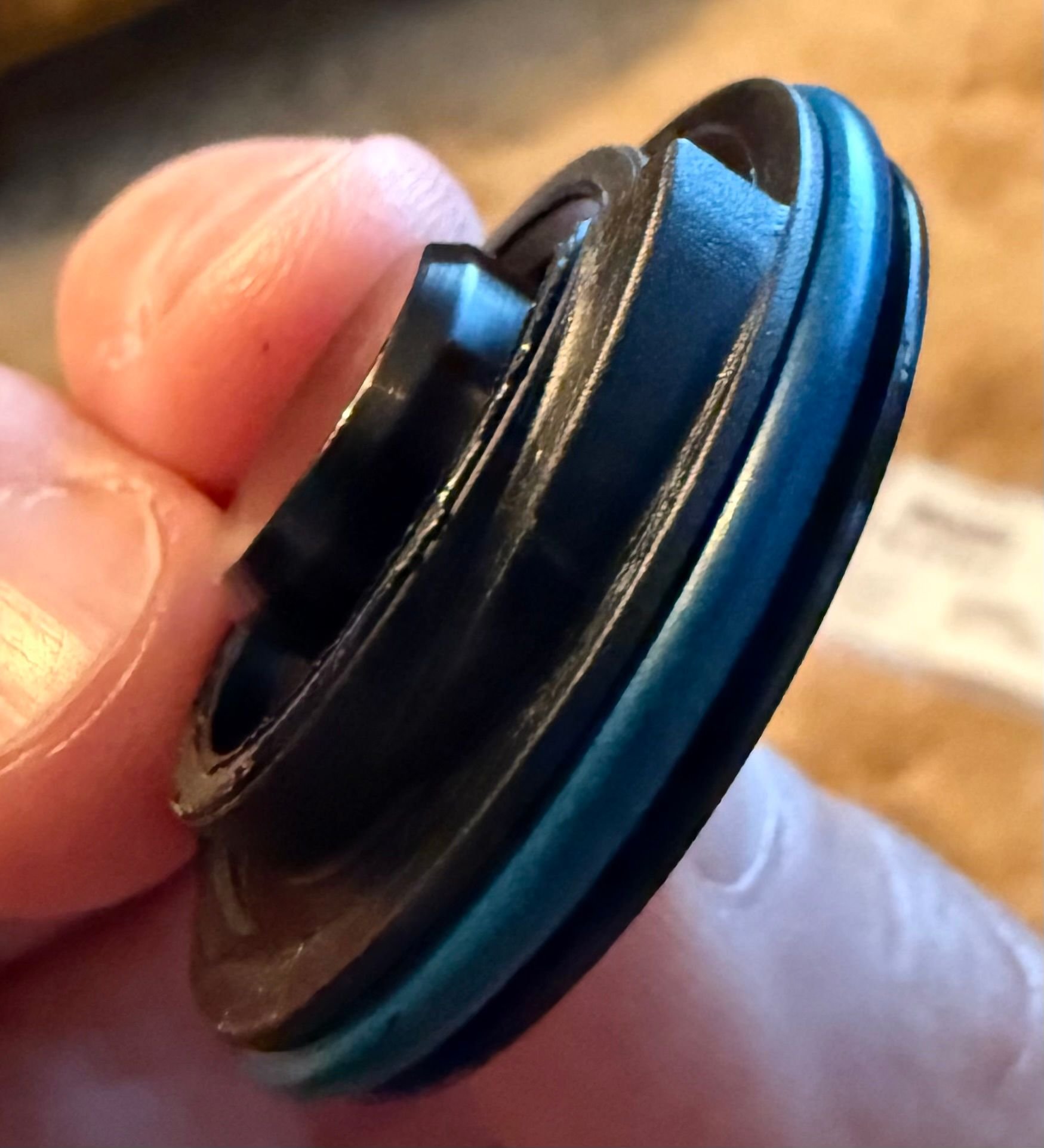

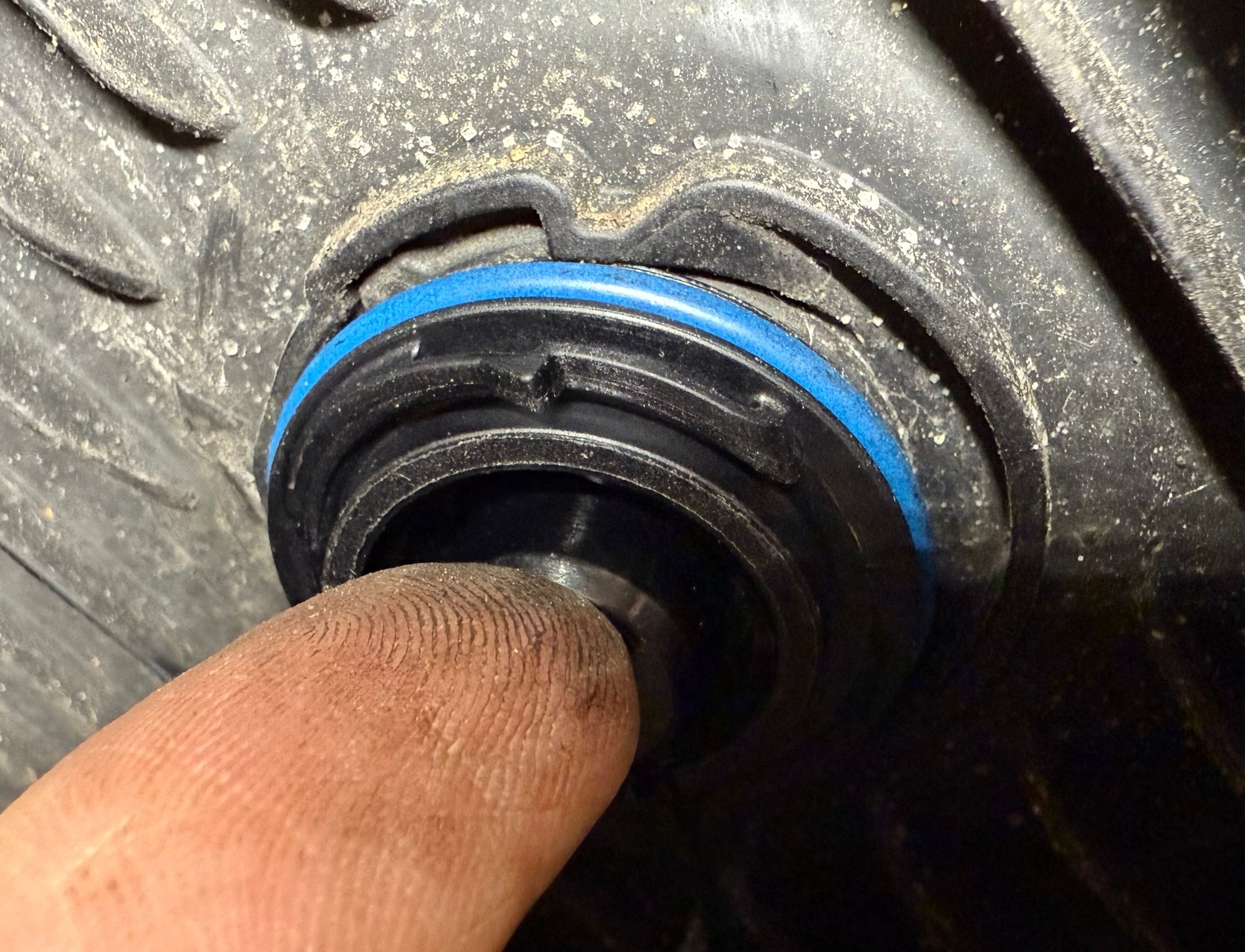

It's not the same part.
Pedigree of the part I ordered: my VIN --> partslink24 --> part number --> Porsche Delaware --> my hands.
We will see if it fits.
Plan A: use the new plug + new o-ring after I drain the old oil
Plan B: use the old plug + new o-ring if the o-rings are interchangeable
Plan C: reuse the old plug + old o-ring

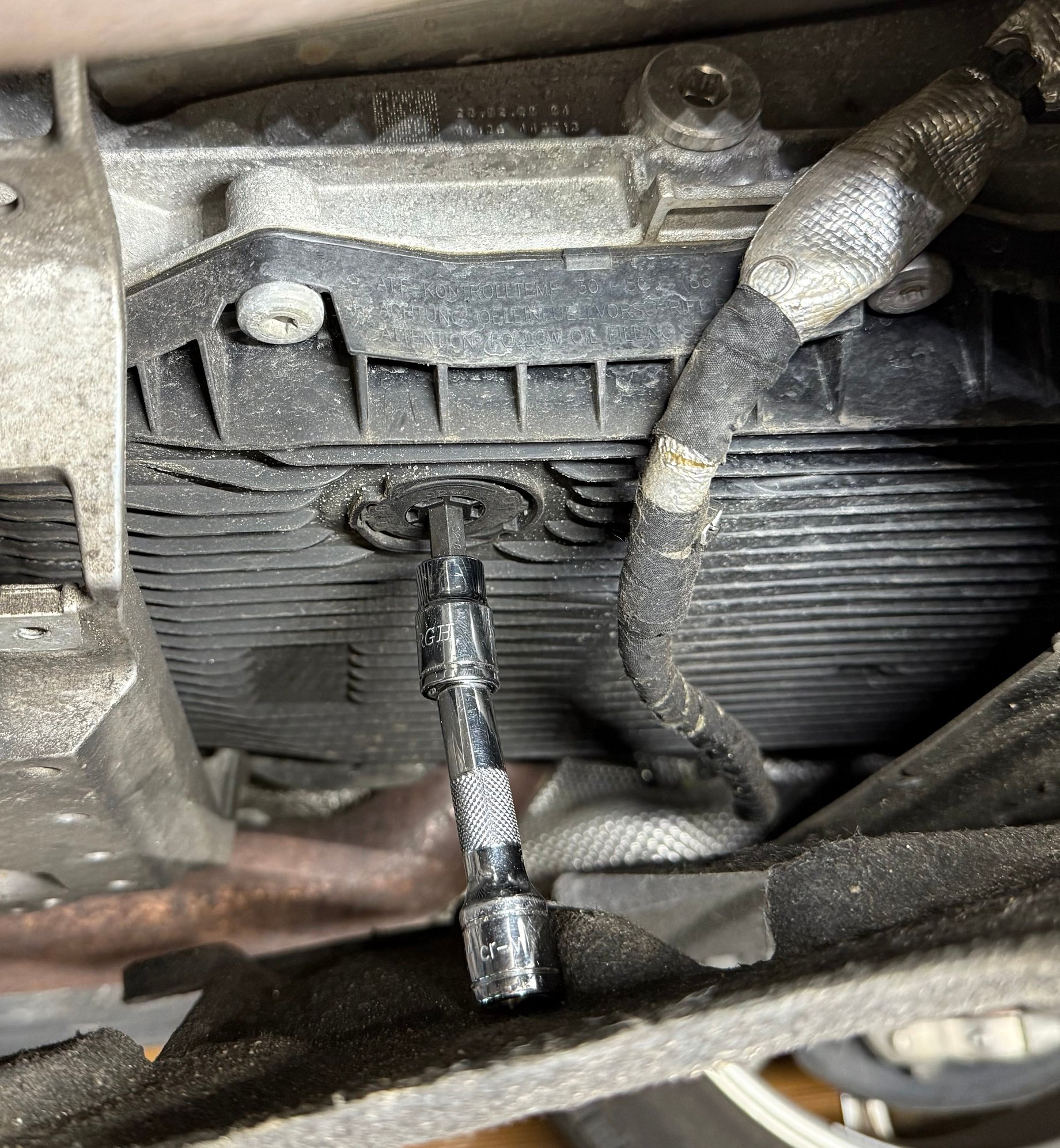

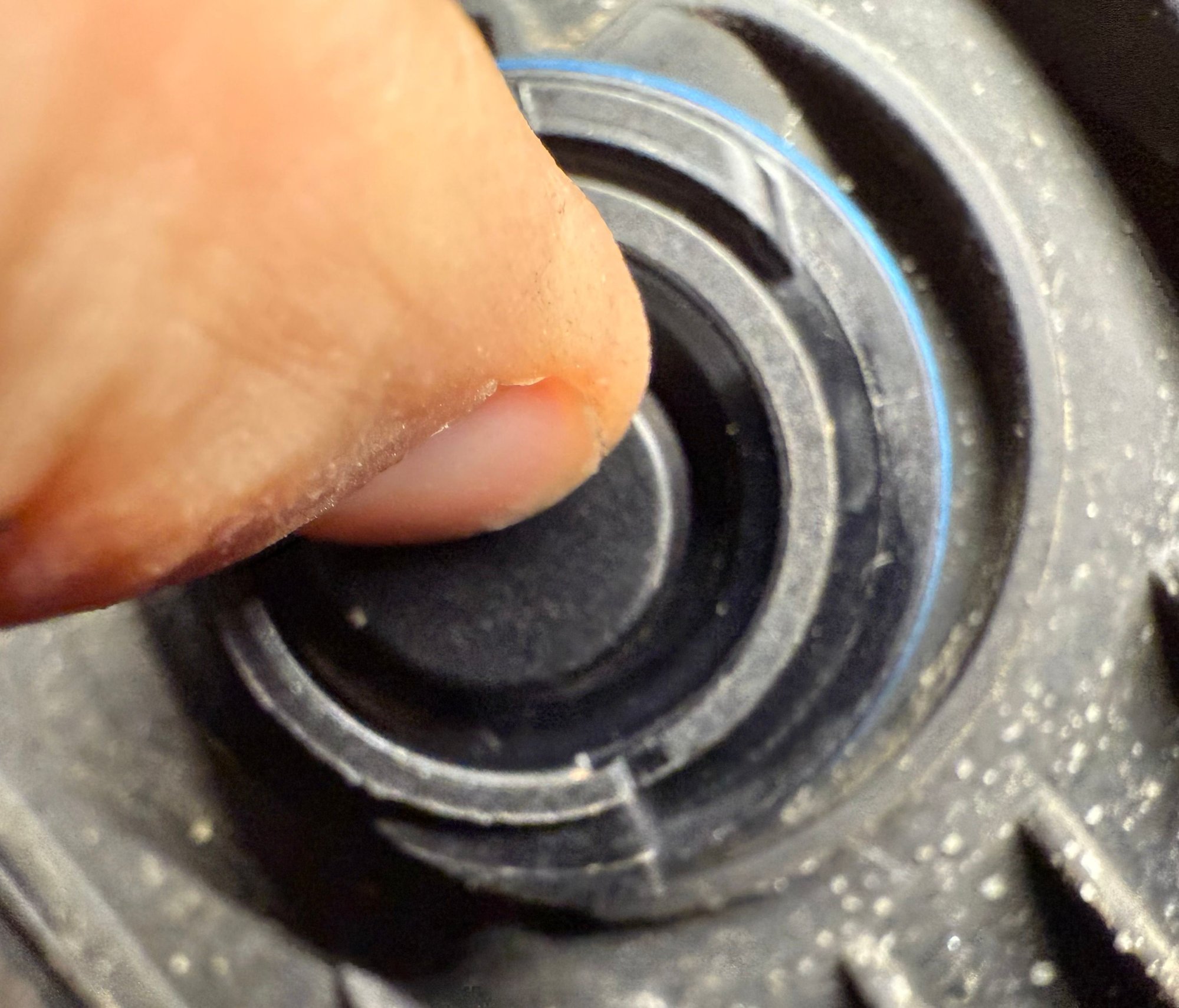

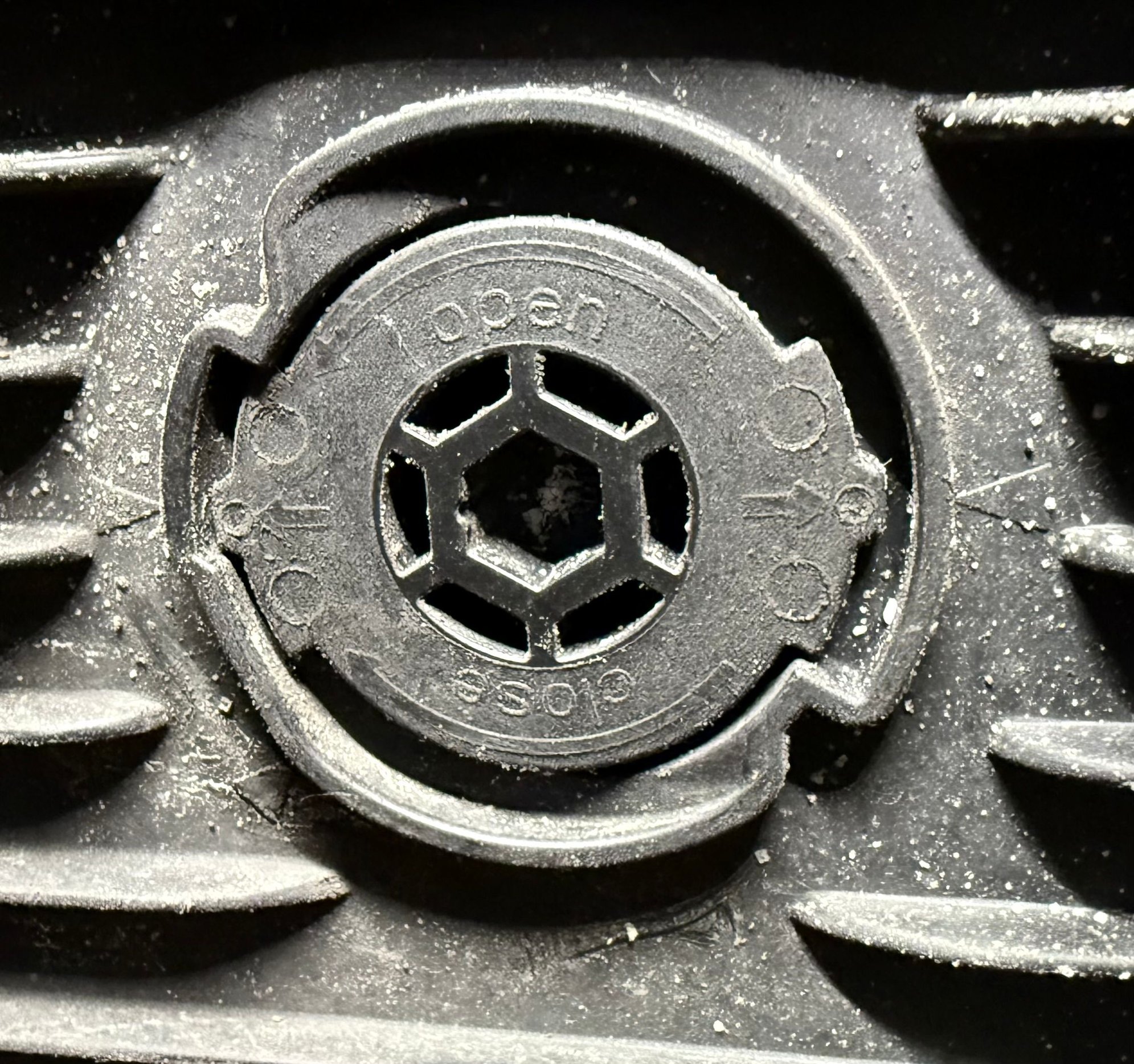

Overall the job is pretty easy from an access point of view. I removed half of the transmission bellypan screws and was able to see the drain and fill plugs. No crossmembers to remove.
Drain plug, fill plug and 8mm hex bit test-fitted

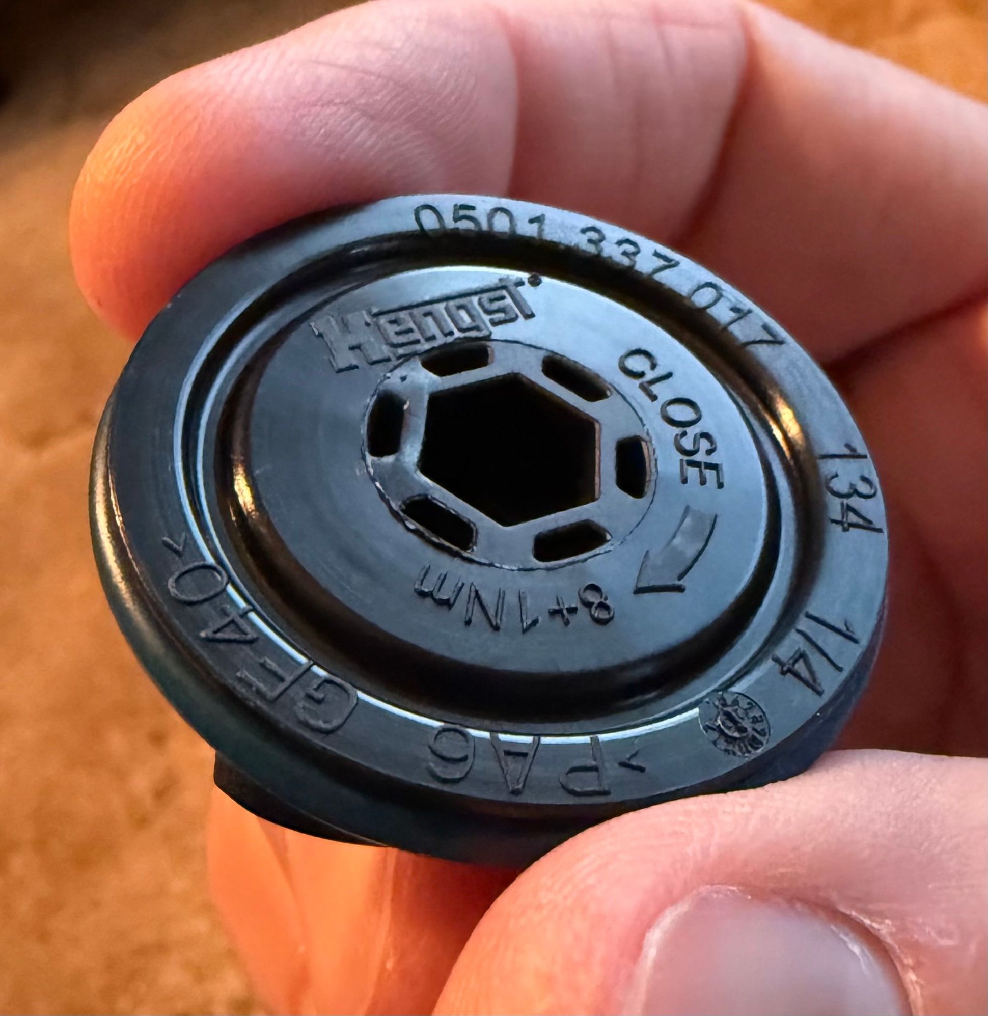

Factory drain plug - not the same as the plug I ordered using a Porsche part number from a Porsche dealer using my VIN on partslink24.
New plug fitted against the factory plug, not a great photo.
Different view of old plug against new plug.
Last view of new plug against factory plug.
