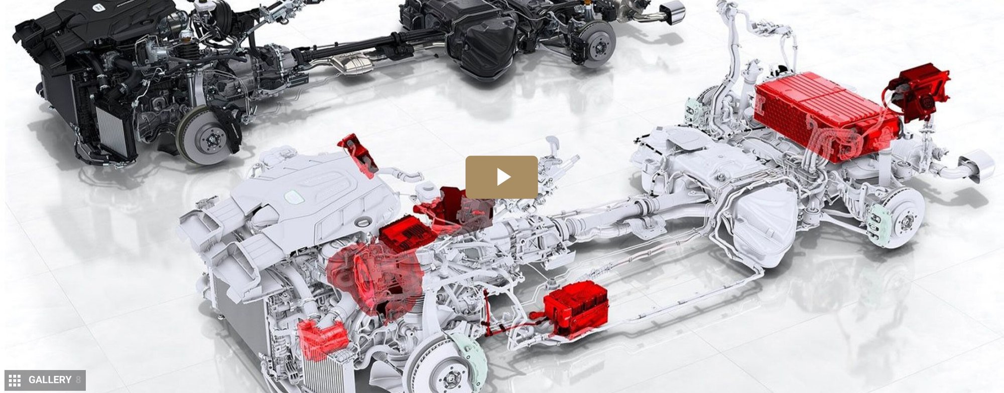

elements in "red" in the photo below are the new Hybrid components - most of which are electronic non-mechnical elements - the ONLY mechanical element "added" to the Cayenne hybrid is the EV motor in the transmission - the rest is control modules that are solid state elements and mostly control modules and since the original Cayenne have demonstrably lacked any actual failure/reliabilitiy issues…
the Cayenne Hybrid design is mechnically simple, not complex and lacks any consequential change in mechanical complexity or maintenance - now the software to manage all of this is yes very very complex…but largely sorted at this point in time.
