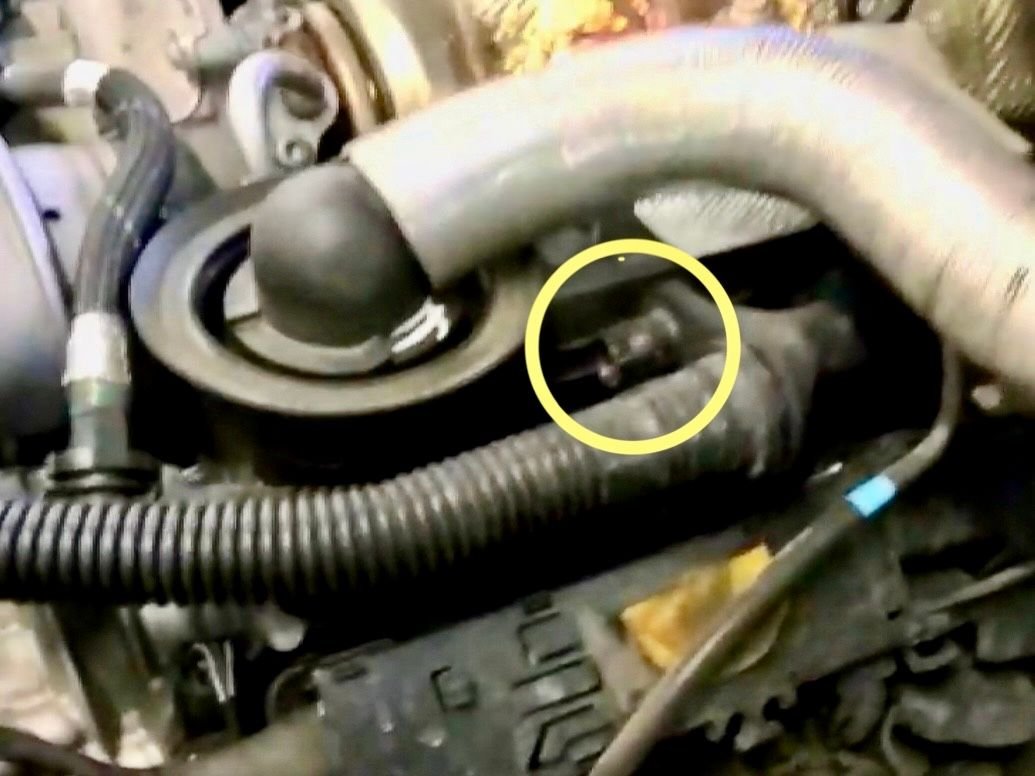

Changed my plugs today using the instructions above, THANKS @dgjks6 and others. Took about 2 hours, not too difficult, but hard to work around the wiring harnesses, remove the engine brace, pulling coils out, etc.
I noticed a hose connector underneath the air filter (near the oil filler) with no hose attached. However, looks identical to the picture post by @dgjks6 , see red arrow in pic below? What is this, and can someone confirm there isn't supposed to be a hose attached? Am I missing something obvious?
Thanks
Lee

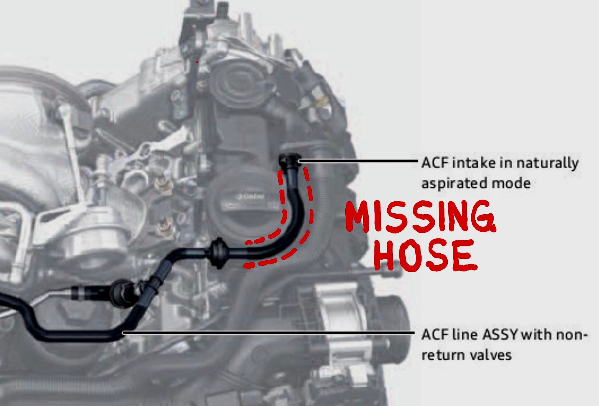

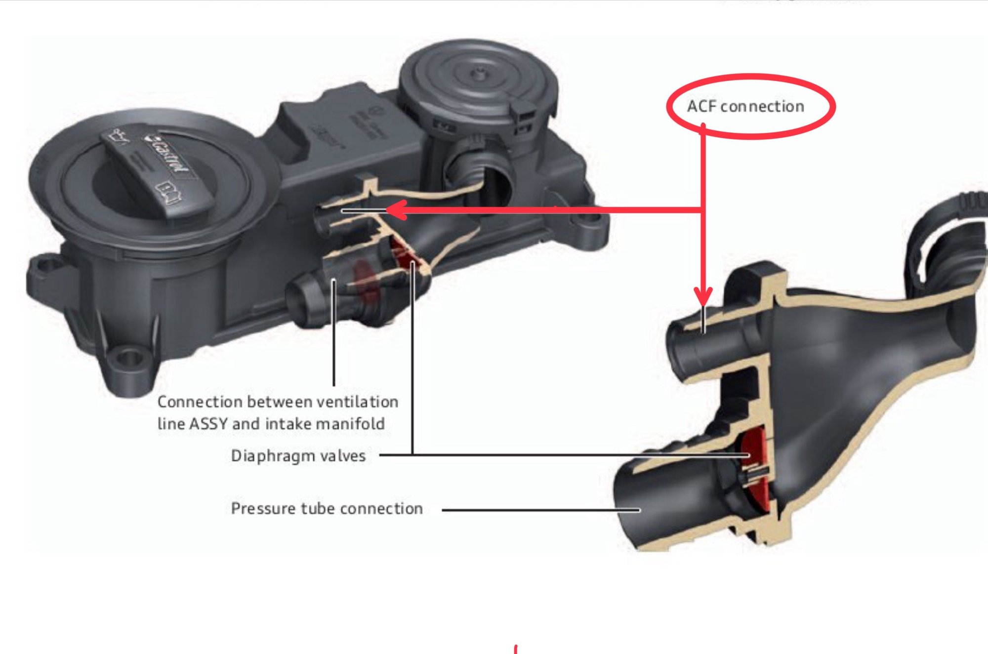

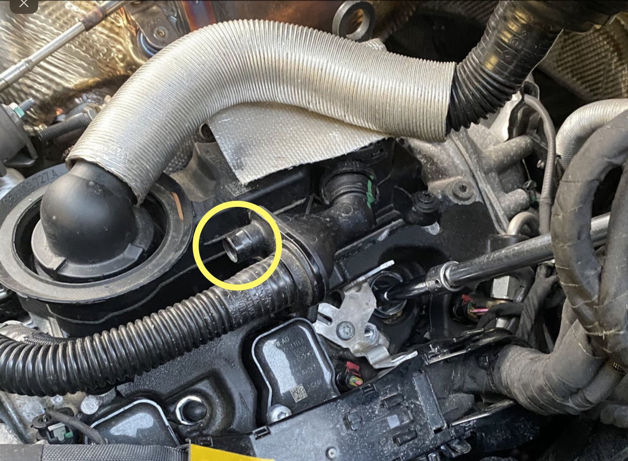

No worries. From this thread:
https://rennlist.com/forums/cayenne-...sing-hose.html
In Audi installations, these fittings are for the Activated Charcoal Filter (ACF) purge line. The ACF absorbs fuel vapors when the engine is off. It is purged during engine operation by venting those vapors into the intake system. In this case, the vapors are vented into the fitting on the air / oil separator.
Reference: Pages 21-23 of Audi EA 389 Self Study Program, attached below.
However, in each photo I could find online, the Cayenne configuration does not use this hose. Presumably, Porsche uses a different hose connection to purge the ACF canister. I’ll save that research for another day.
Photo posted by @95_993 here: https://rennlist.com/forums/cayenne-...-change-3.html
​​​​​​​Screen grab from @PorscheACC video in same thread:
