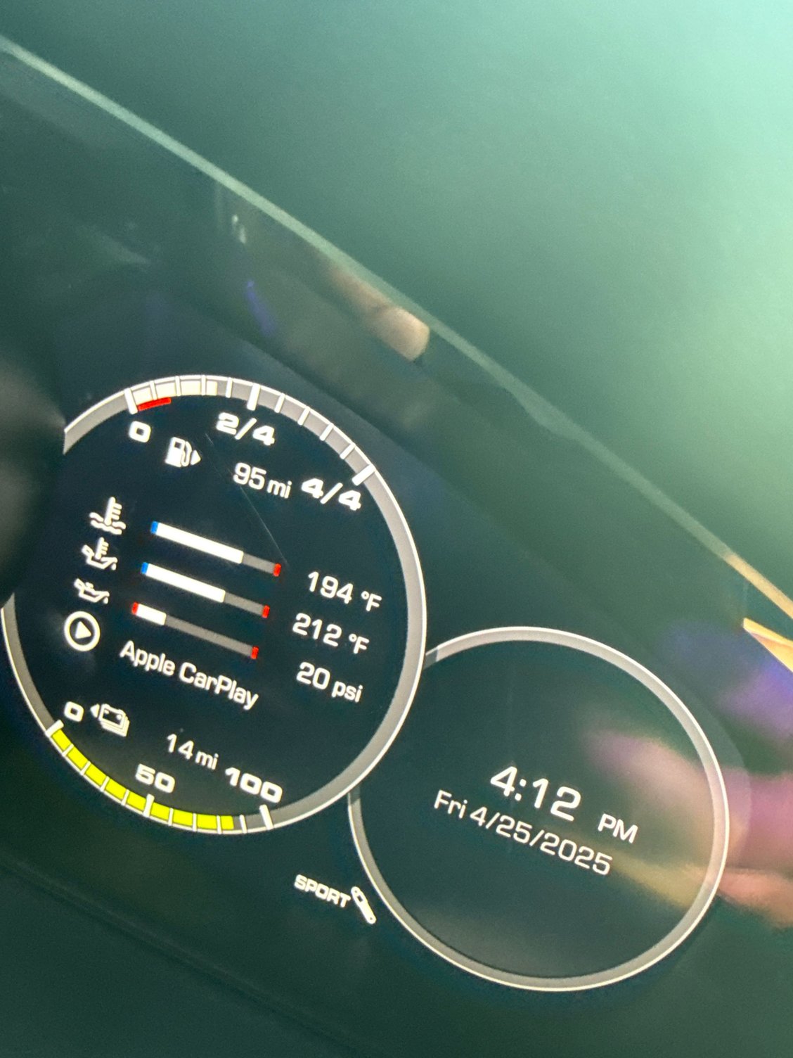

Coding for correct display of coolant temperature on the 9Y0 Cayenne appears to require one additional step. Thanks to Kaefer for showing me a 992 thread where this is discussed. On older Porsches you have to go into the instrument cluster module and the coolant data section and make X1, X2, X3, X4....values = the out-putted values Y1, Y2, Y3, Y4.... However on the 9Y0 and 992 that's not enough; the temp is still buffered at 194F. Moreover X did = Y on my car already. This next step is apparently necessary:
Go into "instrument Cluster," then "Coding Value" then "Extended Codings II," then "Coolant Gauge" and change the value from ITM to Standard.

correct display meaning what? The stock coolant temperature is not actually the temperature? Ty

The temp gauge reads actual temp until you get to 194 degrees and then it doesn’t go any higher. Not sure what happens if it truly overheats, but 194 is where it stays all other times.

mine is always around this when fully warmed up.

If you are able to do the coding I mentioned you can see where it really resides. With in-town driving on our Cayenne S today (ambient temp about 70F) I am getting 205 to 217F. The fact it gets above 212 is a little scary. No wonder they buffered it to sit at 194F. It probably is a little lower at highway speeds. Will check on that tomorrow.

Thank you for this. I use Thinkdiag and the menus are a bit different. Instead of "Coding Value" you choose "Rule Coding" but all else is basically the same. I have made the simple change and now it is a real gauge. I just took a 7 mile drive, and it is a 73 degree morning, and saw 216 degrees! Man this Hot Vee engine gets warm! I have the base with one turbo, so I can image with two, the numbers would get even higher in a load condition. I'm sure Porsche used this approach to keep the customers from worrying too much but how hot it gets.
