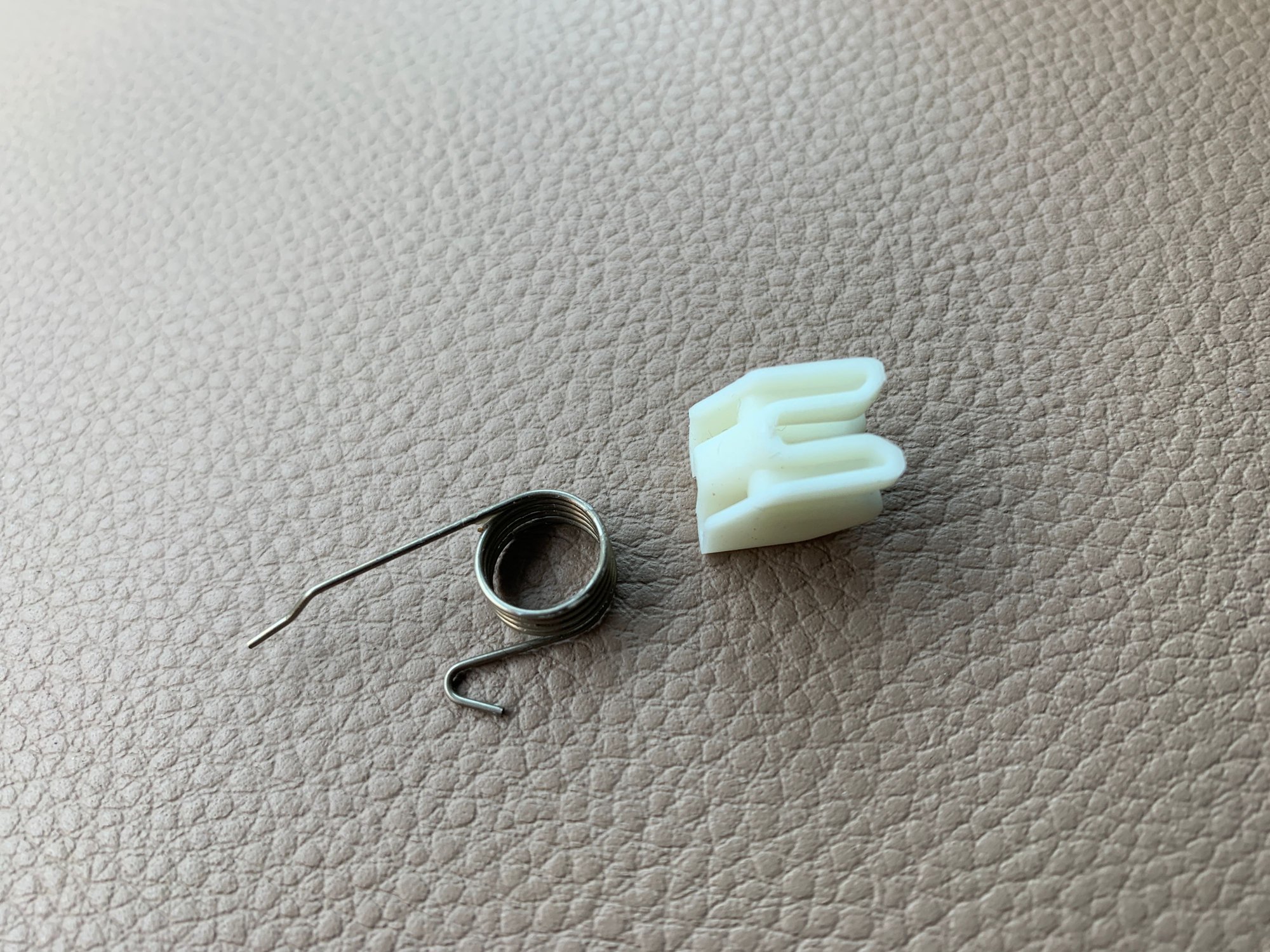

​​​Hi @tato97 , would you mind posting a photo of the ashtray you removed - specifically where the spring is. I am not sure where the spring should be. I’m posting photos here of the part I’m curious about.
I wonder where that spring and white rubbery plastic part should be installed.
I’m guessing the spring slides somewhere on the circle.
Thank you very much.

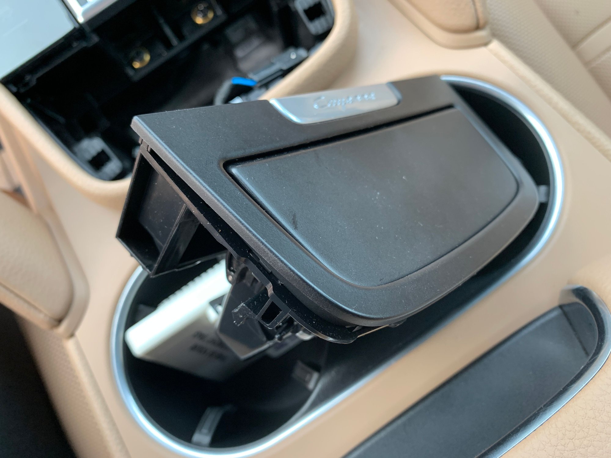

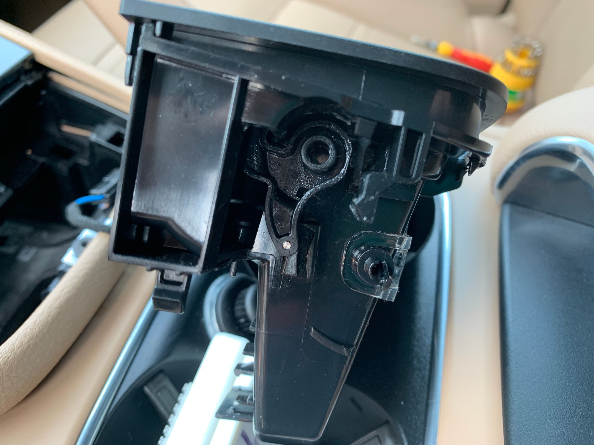

Here are the pictures of the spring. The white rubbery part you have in your picture above is to prevent rattles. It goes over the sharp plastic extensions in the center of the ashtray right bellow the Chayenne log
