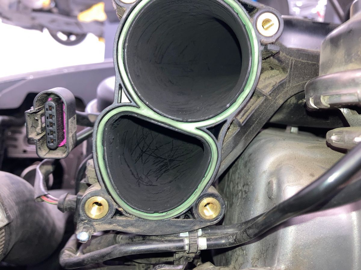

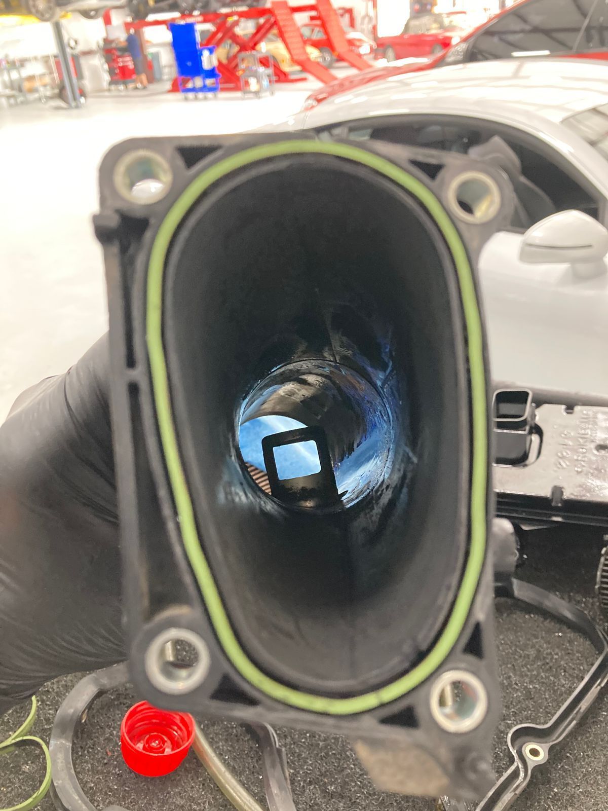

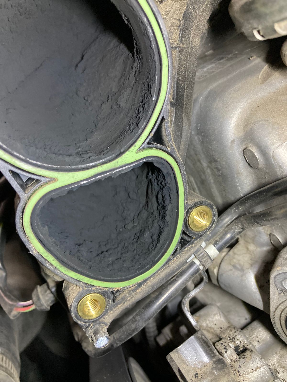

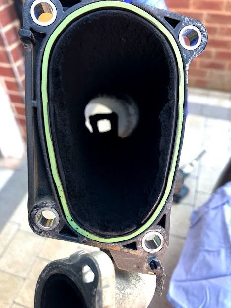

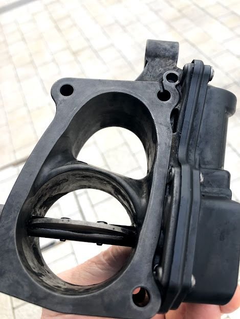

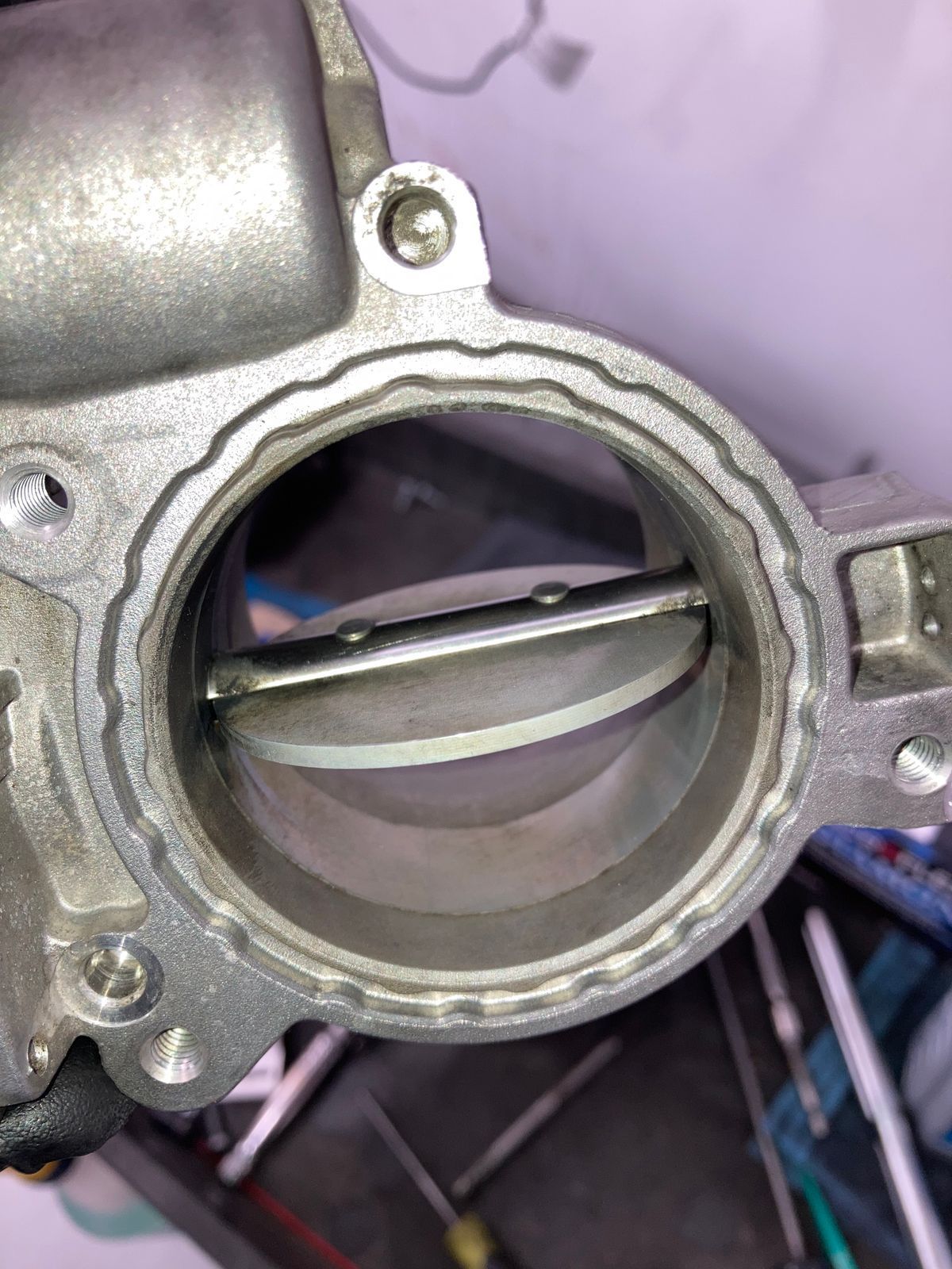

I had lots of repeat 'recurring' DPF codes 2 years ago in my CD, I did lots of research and fixed it myself and the codes have not returned since.
The solution followed a long conversation with a guy who cleans/flushes DPF's for a living. He explained that most of the time flushing the dpf or replacing it wont fix the problem, the issues lie elsewhere.
Basically the dpf is designed to clog with soot, thats its sole function, then a regen burns it all off. Short journeys prevent the regens from starting or even worse the regens start but dont complete.
The guy told me the car guesses the amount of soot in the dpf, there is no way to measure it. The way it guesses is to measure airflow restrictions at the dpf via the 'Differential pressure sensor'.
There lies the problem, the airflow is already restricted before the sensor due to carbon build up in the air intake / egr system and turbo. So if you only deal with the dpf the codes will keep coming back, as you have found.
I removed some of the easily accessible pipework/ducting from the air intake and found the walls full of carbon build up. cleaned it all up with brake cleaner and not had a problem since. Messy 2 hour job but worth it.
I also did my own dpf flush and emptied a few cans of carb cleaner into the air intake ...but cleaning the intake pipes was 100% the long term solution.
This fixed my dpf straight away, not a single CEL since.
heres some before/after pics of my soot build up.
So as you see the air flow will be restricted way before the DPF due to the nature of these engines (EGR system mainly), and the dpf sensor thinks the dpf is blocked due to the reduced airflow.
Good luck, let me know if you need any more info.
