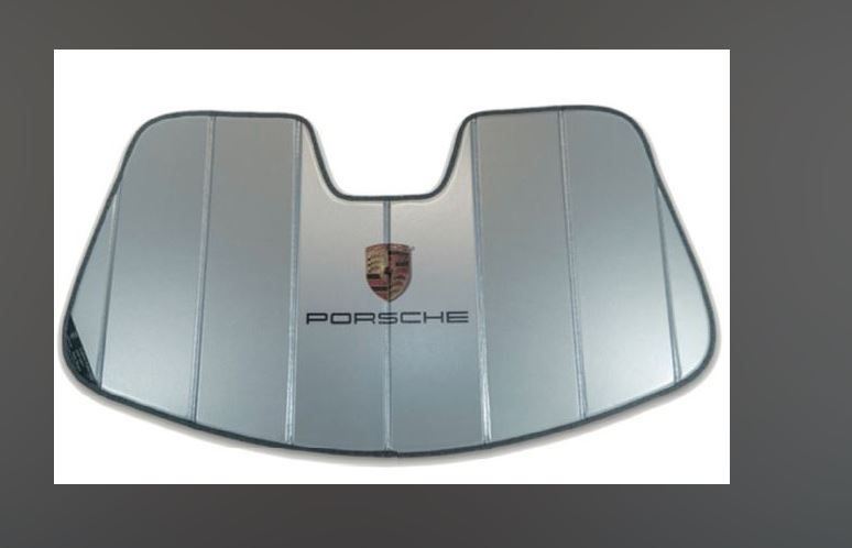

I don't know if this helps, but I always use a sun shade
https://www.suncoastparts.com/mm5/#m...-1509415744826

Ordered it!
Thanks!
It will be useful for an upcoming road trip!
