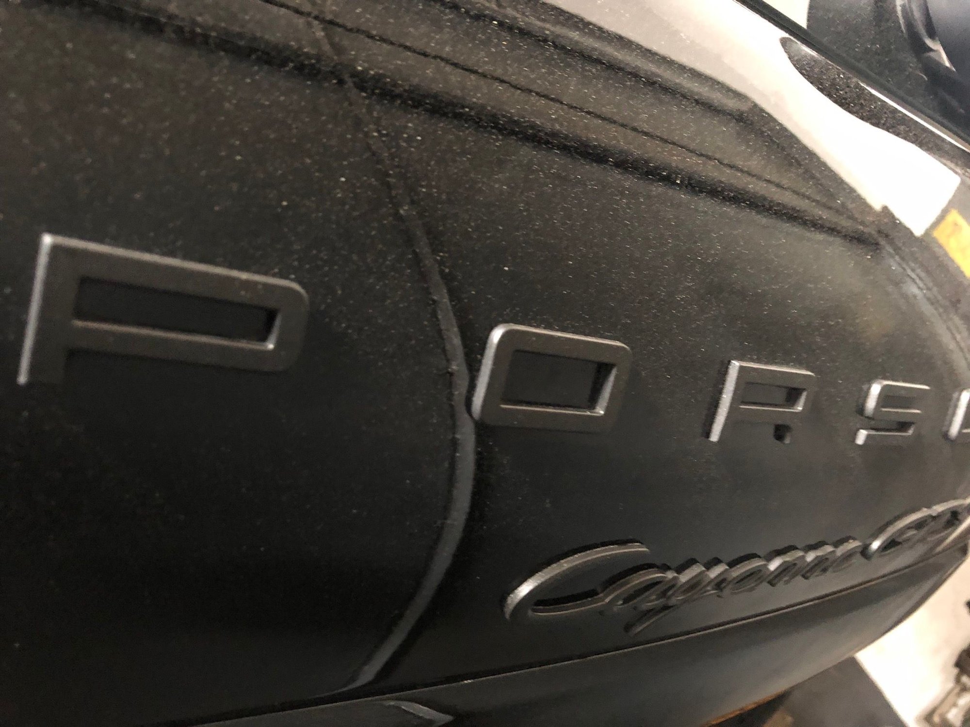

Did these tonight.

Originally Posted by Galion
Plastidipped mine a year ago, so far so good.
Galion, the edges of your letters look clean and sharp, compared to some other Plastidipped letters I've seen on youtube. Do you have any tips?
Do you recommend roughing up the letters with fine sandpaper first?
Did you tape off the body around the letters first, or did you let overspray land on the body and then peel it off? If you peeled excess off of the body, did it come off cleanly around the letters or did you need to score the edges for a clean cut? Did you peel it off of the body after each coat, or at the end? Maybe I should just try it, since it is reversible.
It’s a very simple procedure, but a common mistake is that most of us are anxious to see the results and peel the plastidip too early. Let it dry overnight,
Do not sand the letters, just clean with isopropyl alcohol and a Q-tip, mask a large area around the letters, apply 05-06 coats, 15 minutes between coats, let it dry overnight.
PIck a corner and peel at an angle, it will come off cleanly. I used a toothpick to work on some edges.

What Galion says, no roughing up, just clean up well. Mask the rear of the car and don't do it in windy conditions. I did 8 light coats at various angles from about 6'' away. Use a softer toothpick to score the Plastidip before peeling off the excess. Don't worry, the paint on these tanks is plenty tough for soft toothpicks.
Galeon, did you seal the Pastidip? With Glossifier or something like that?
Yeah, I applied just one final coat of satinizer, not necessary though. I just wanted a more satin finish like my wife’s Macan GTS black emblems, turned out nice.
