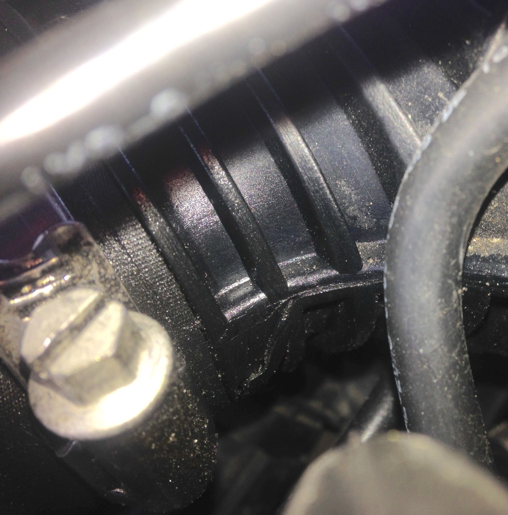

Hard to see, but I'm pretty sure this is a plenum crack. This would explain all the oil I've found in this area. I also have a lot of oil collecting/dripping on the driver's side down by the inter cooler. I think that is something about a charge pipe o ring?
Old May 30, 2015 | 02:27 AM
seankrider's Avatar
seankrider
Joined: Aug 2009
Posts: 724
From: El Dorado Hills, CA
Definitely charge pipe o-ring.
