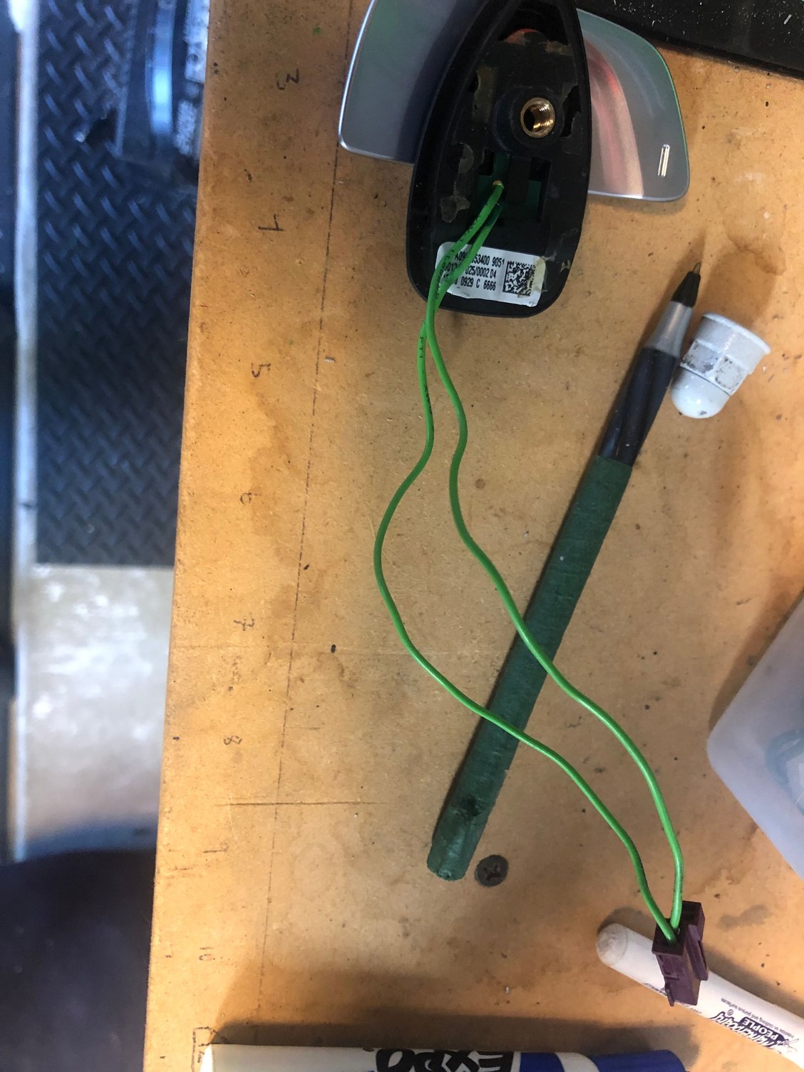

I purchased a set of Benz paddles in attempt to retrofit to my CTT per the couple writeups on the forums. No avail.
There was a good write up from the non Multiwheel from the cayman which had SIMILAR wiring to tap into... although it was mentioned some models needed resistors etc.

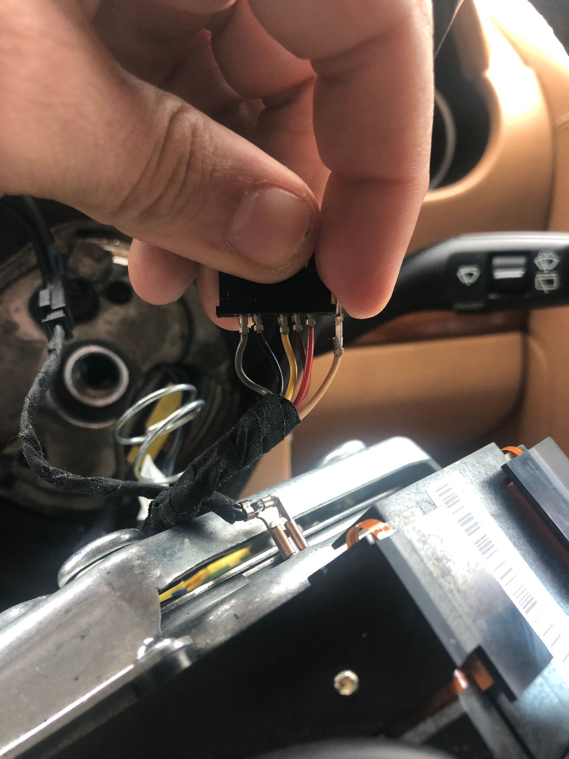

The paddles I purchase had two leads from each paddle that were the same color (green) for both wires, not the black and blue/yellow from others shots. Additionally, my wiring harness within the wheel includes black, grey, brown, yellow,white, red. A voltmeter showed 12 VDC on the grey.
I tried using using the attached schematics, thinking that my two green wires of the paddle were a ground, and blue/yellow per the diagram. I attached one green to the black and the other to the white (upshift) and one to black and the other to red for downshift.
Result: nada. Even with reversing the green wires (not knowing which was “black”/ground”.
Anyone have insight on this on the 955 wheel?
TIA.

I dont think it is as simple as you are trying to make it. I believe, and I definitely might be wrong, that the shifters in the oem steering wheel talk to the PCB inside the bottom of the steering wheel, which converts the command into a CANBUS command which is then sent to the trans computer. Again, I could be wrong. I went the below route on my CTT 955. If you want to tie in a 2 wire switch, you can attach to exactly where the microswitch is in the steering wheel. If you are replacing the steering wheel you will need to create a pull up/ground bypass circuit. Also know that BOTH sides need to be connected on that PCB.
