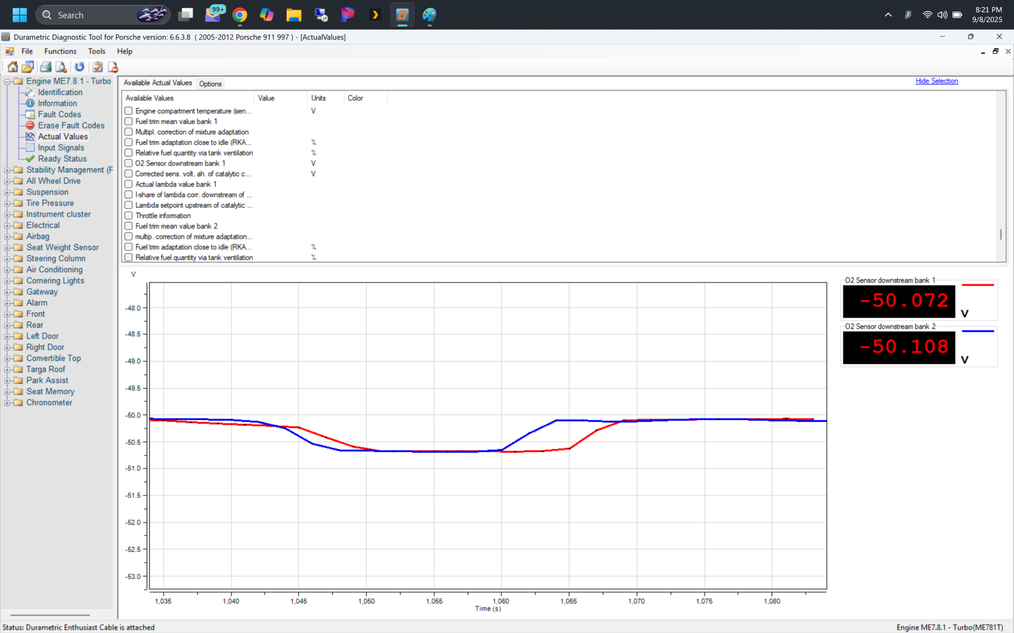

I looked those codes up, and they say my cats are bad. I have a hard time believing they would all of the sudden be bad. I tried looking up what the O2's are saying, and I only see downstream O2's in durametric, not upstream (should I see those?)
And when I looked at the voltage, this is what I see (is that saying -50 Volts?), that can't be right, but maybe I'm reading it wrong? And where are the upstream ones in the durametric?
My plan is to replace the pre and post 02's (if I'm doing the work, I'm going to replace them all), look for any exhaust leaks, clear the codes, and see what happens. Could the P0420 & P0430 be related to putting back on the factory tune, seems like the only plausible explanation?

997.1? Read the voltage on the post-cat 02 sensors (narrowband). They should read between 0.0 and 1.0 volts. Based on my research and experience, a normal reading before they trigger a cell is between 0.5 and 0.8 volts.
Your pre-cat sensors (wideband) should read between 0.0 and 5.0 volts. I think it’s about 0.5 to 4.5 volts, to be honest.
Values in your screenshot seem funky. Show me front O2 sensor values, if they’re funky as well, we can hopefully un-funk them together inspector gadget style.

Like OP, Durametric gives me no upstream O2 values to read, only downstream, and I see numbers in the -50 range.
It flutters around slightly but for the most part just hums along right here in both banks.
Are we sure about "They should read between 0.0 and 1.0 volts" ?
yes, durametric will show both upstream and downstream if you select the correct boxes, I've used that function many times. Sorry, I don't remember which boxes to check, but I think they were easy to find.
upstream should vary, downstream should not +/- 0.2V
