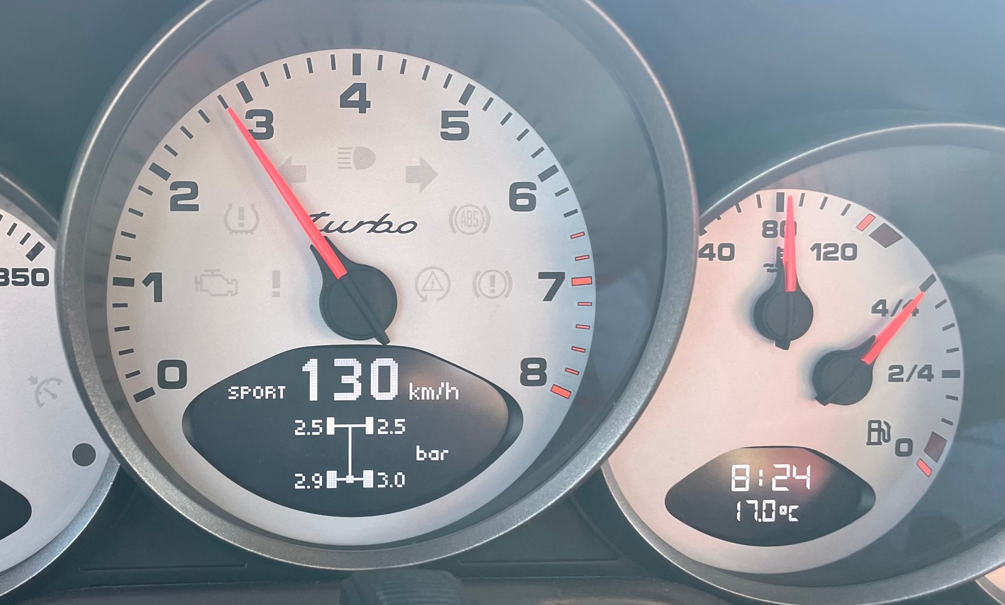

I was ordering the HUF RDE001 sensors (exactly the same as OEM) for my 997.1 Turbo when I got a message from the shop. They advised me to use the newer generation HUF UVS4050 sensors (433 MHz in Europe) which are multiprotocol, have a longer battery life expectancy, are rated at 300 km/h and at € 37,- p. piece much cheaper. Unlike de OEM/RDE001 sensors they need to be programmed for a specific car type, which the shop did for free based on my VIN number before sending them to me. They can be programmed for any 997. They work fine without any issue.
When I bought the car TPMS was disabled because the battery's of the original sensors died and the owner didn't want to pay the Porsche dealer. After mounting the news sensors with the new tires I reconnected the TPMS module, and I was surprised I automatically got a message in the display that the system was learning........ although the TPMS module, gateway module and display module where still coded out! When the learning was finished, no light, no messages, nothing. As it was before. But I was able to see the ID's of all 4 sensors memorized in the TPMS module with a OBD tool. So the sensors where recognized and learned correctly.
Then the TPMS module, gateway and display module where coded in. This was the first time I could see TPMS function in the menu, the TPMS warning light on together with the message "TPMS Inactive". After driving for I few miles a could read the actual pressure in the display. Great.
