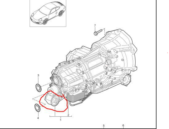

Hello. I have a 2010 997.2 TT and have an interest in replacing the PDK trans mount now having replaced the aged/worn engine mounts...learned quickly that it is a much different job than the .1 given the part does not appear in any source I've used (e.g. Porsche parts manual, Sunset, Pelican). Any and all guidance is welcome short of replacing the entire transmission.

I did not. Pelican was helpful but, in the end, neither they nor their Porsche contacts could find. Assuming it does not formally exist yet.

For anyone following this, I think this is a flaw with the PDK as a whole - not being able to replace a mount. I see the function first solution, which I'm now considering, and the hack solution by thatilgarage guy (respect his work) but I'm pretty disappointed in Porsche for this. Great car (997.2 TT), just frustrated that replacing engine mounts is fairly easy but a trans mount doesn't even have a part number.
Guess they expect you to replace entire $20k+ transmission.

i had the same issue this was my solution
Reply 1
Aug 17, 2022 | 09:35 PM
Quote: i had the same issue this was my solution
Thank you. I found that same video doing my youtube searching. I will probably try it, but a couple of questions:
1) Did you end up having to lower the transmission to access or were you able to get the material in there without?
2) Did you replace the two end pieces? I forget what they're called but made of foam/rubber and mine fall apart at the very touch.
3) Were you happy with the results? any issues?
Thanks again. Helpful to hear somebody has tried this.
Reply 0
Aug 17, 2022 | 09:38 PM
1) i believe i did have to lower the tail of the trans
2) no i didnt replace the two end pieces
3) im happy that it stoped the clunking and that i didnt need to buy a 20K trans to solve that issue
