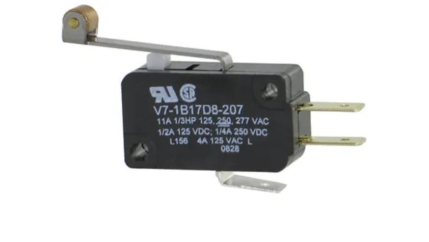

What exactly does a microswitch look like?
Old Nov 21, 2019 | 11:57 PM
lliejk's Avatar
lliejk
Joined: Mar 2017
Posts: 1,608
Likes: 468
From: Exton, PA
Something like this:
I think the below link is the switch, or something close to it, to solve this problem.
Window Drop Switch

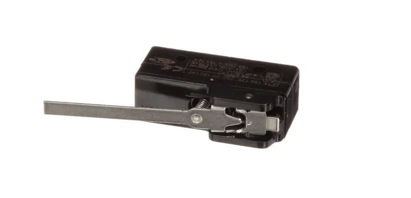

Yup, it's the microswitch for the latch, not the one for the handles. It's just like Milazzo said up above, since the latch microswitch isn't functioning the computer thinks the door is closed and rolls the window back up. This is why the window normally rolls up when you shut the door as the latch microswitch is triggered. Since it's broken it triggers the window to roll up as soon as you let go of the handle.
This is a common issue and you'll find many threads on it over in the regular (non-turbo) 997 forum. The good news is that the microswitch is cheap compared to the motor.
Old Nov 22, 2019 | 09:34 PM
PV997's Avatar
PV997
Joined: Jul 2019
Posts: 2,007
Likes: 2,058
From: Southern California
Window Drop Switch
Ed
That's the one for the handle that rolls the window down. The latch microswitch (which rolls it back up) may be the same part number but don't count on it.
