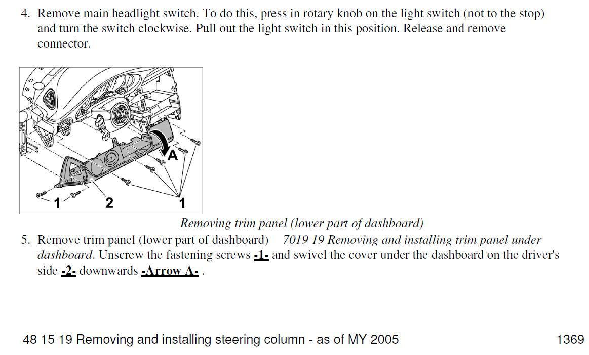

So I have this annoying rattle coming from the knee pad below the steering wheel. While the car is parked I can duplicate the rattle by gently bumping the knee pad, or pad under the steering wheel. I want to remove and place something, felt tape, rubber, anything between pieces to eliminate this rattle.
Any suggestions how to remove knee pad. And I promise I did a search before asking!

Correct, it is the part under the steering wheel.

This?

Perfect! Thanks
