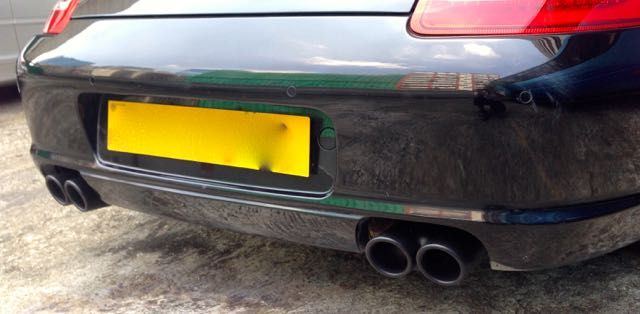

I don't have PSE, but I do have matte black tips.
As someone said in another thread, I have a "rattle can" matte black because I used hi temp paint that cost $8 instead of paying $600 for the professional tips. Have had them on the car for about 4 months and they still look freshly painted.
But to each their own.....personally I like the money I saved as I bought other stuff.

So how easy is this mod? You just take off the tips and then spray paint, and then put back on?
Also what paint is recommended? I wouldn't want to do Plasti Dip for mine.
Old Jan 12, 2015 | 12:20 PM
SoCal C2S's Avatar
SoCal C2S
Joined: Sep 2014
Posts: 1,469
Likes: 141
From: Kalifornistan for now....
Yes....it's just that easy. I think it was a 10mm socket to remove the tips.
I used Rustoleum Hi Temp (2000F) engine paint, three coats spaced apart by about 30 mintues.

Why would you do Platstic-dip? It holds up very well and you can remove it any time if you didn't like it before putting on a permanent paint.
I didn't even need to take of the tips when doing mine...
