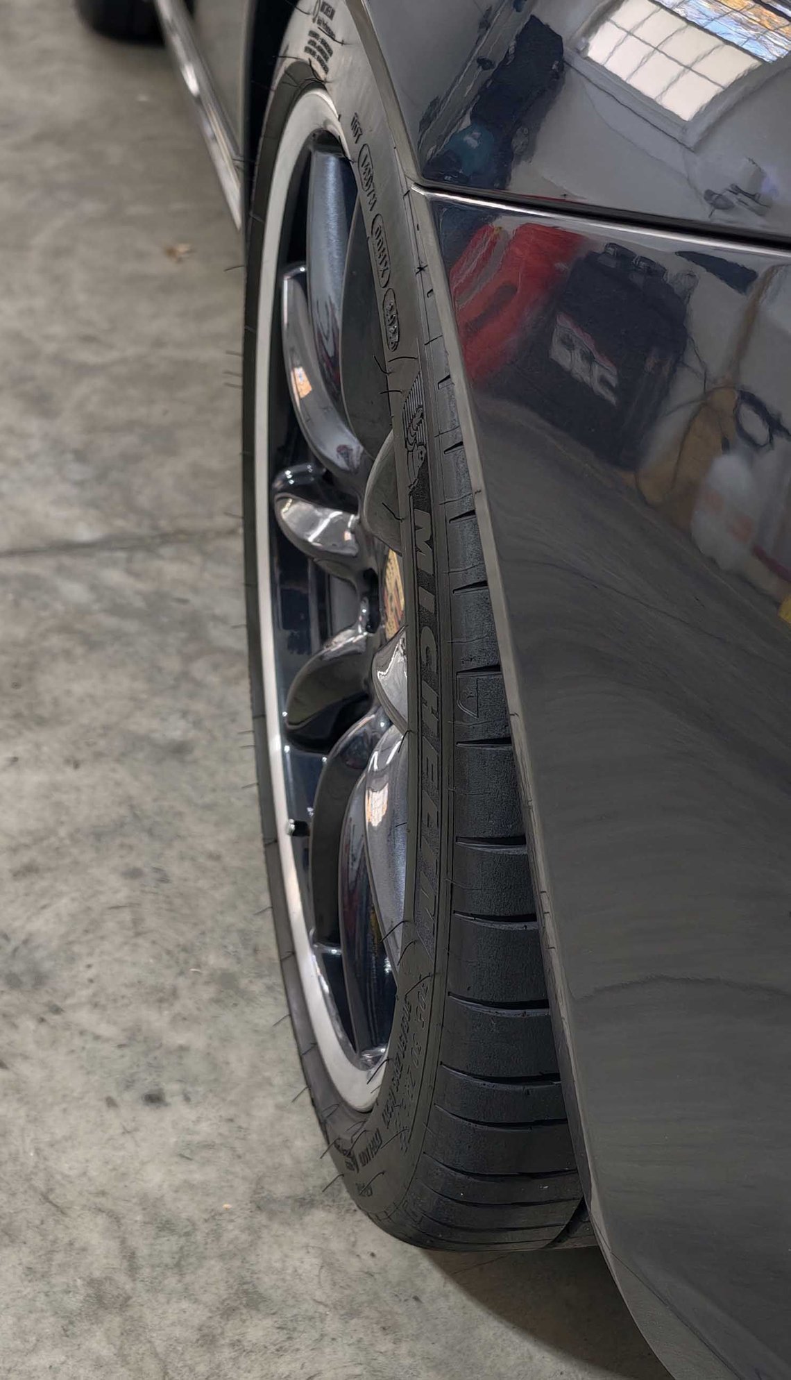

Originally Posted by kellen
Ran wide body wheels on my 997.1 S. Looked great.
If I may ask, what WB wheel did you have your 997.1?

kellen's Avatar
kellen
Lifetime Rennlist
Member
Joined: Jan 2014
Posts: 2,677
Likes: 542
From: Seattle, WA
Carrera S II
Old Oct 29, 2025 | 07:27 PM
Forgelite Wheels's Avatar
Forgelite Wheels
Basic Sponsor
Joined: Oct 2023
Posts: 360
Likes: 206
From: Vancouver
That sizing would be 4mm to aggressive we typically use 19x11 +55
But if you don't mind a slight poke and are up to lowering the car and adjusting the camber you can make it work.

Old Oct 30, 2025 | 09:11 AM
MauritsK's Avatar
MauritsK
Joined: Jun 2023
Posts: 59
Likes: 45
From: Den Bosch area
I effectively run ET 51 on a 997.1 C2S. Its with PASM, no lowering, no camber adjustments. They are "decent" aftermarket, being OZ Leggera with ET65, and a 14 mm spacer.
No poking whatsoever, no rubbing, etc. Works like a charm. I would not be afraid of ET 51 on a .1 C2S ...
