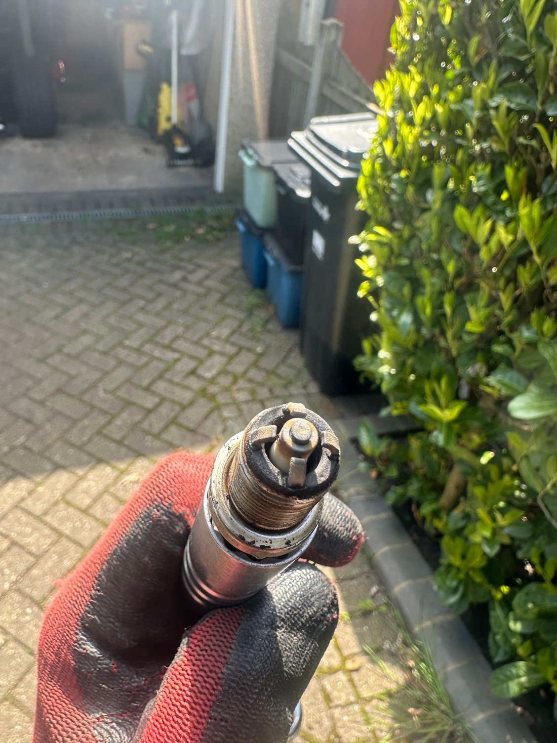

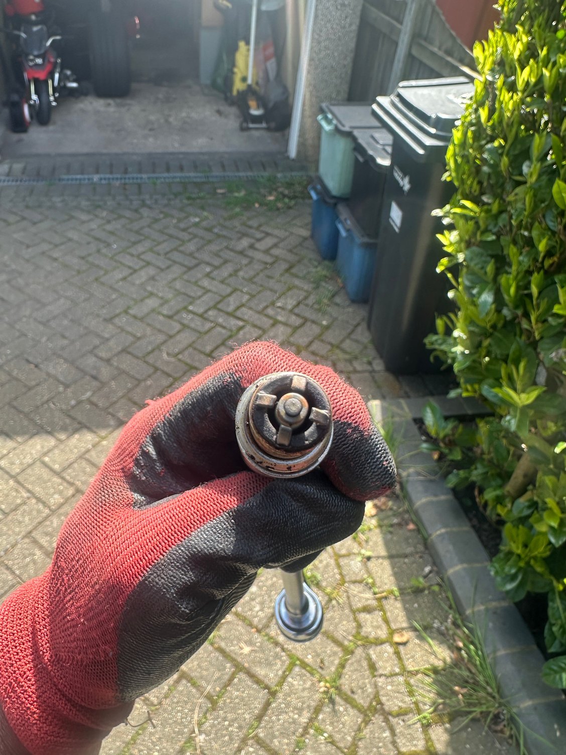

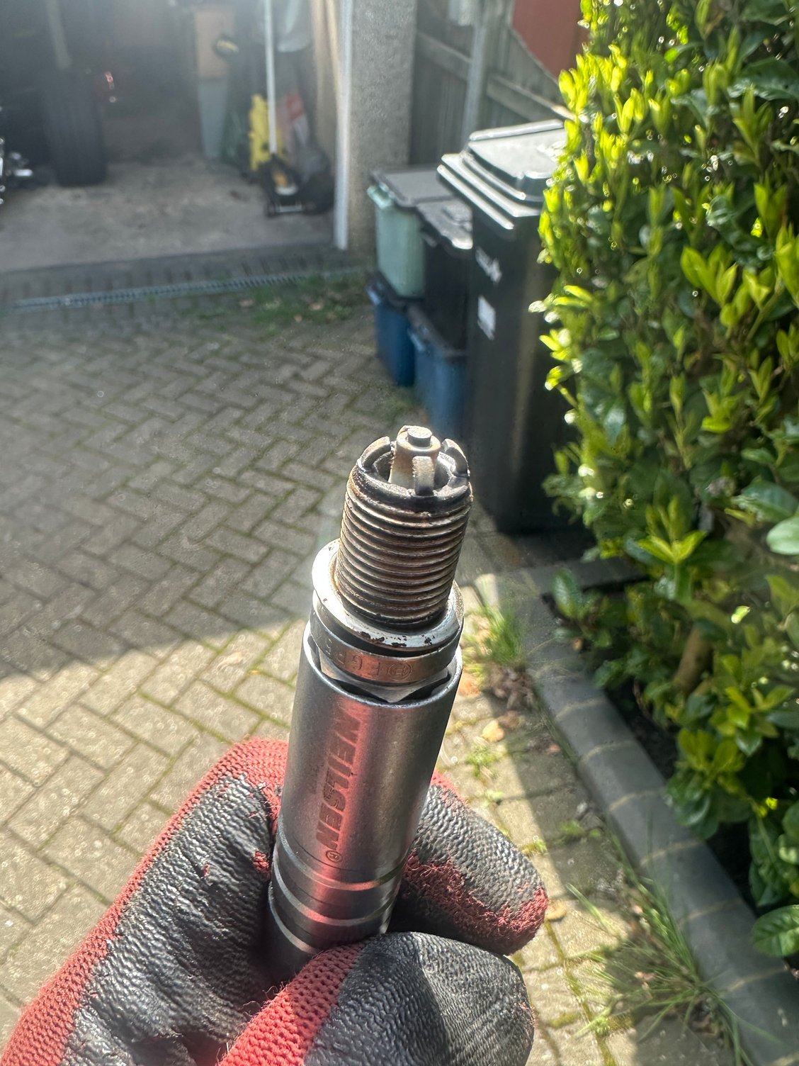

Hey,
I thought to shove a bore scope into cylinder 6 on my .1 3.6 with 138k miles. No issues with scoring or anything like that, but what does
the 35k miles plug in the cylinder tell you? Lean mixture or normal?

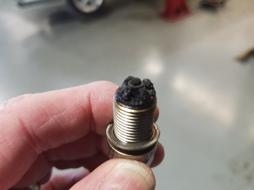

Here are mine fromm a few weeks ago: (2007 C4 3.6L @ 25K)
Old Apr 20, 2025 | 10:01 AM
BillB128's Avatar
BillB128
Joined: Jan 2012
Posts: 492
Likes: 341
Plug looks good to me with minimal but even electrode wear. The light tan deposits on the plug are what you want to see.
Seems like you've got a very healthy motor at 138K miles. Just my two cents, but I'm sure others will chime in.

Pretty good looking for a healthy motor (assuming the other plugs all look like that). Do consider changing the plugs at 30K miles ... no matter what the book says.

Originally Posted by punchdrunked
Hey,
This looks totally fine and what it should look like.

Originally Posted by Graufuchs
Normal Burn
Something may be going on with your #3
