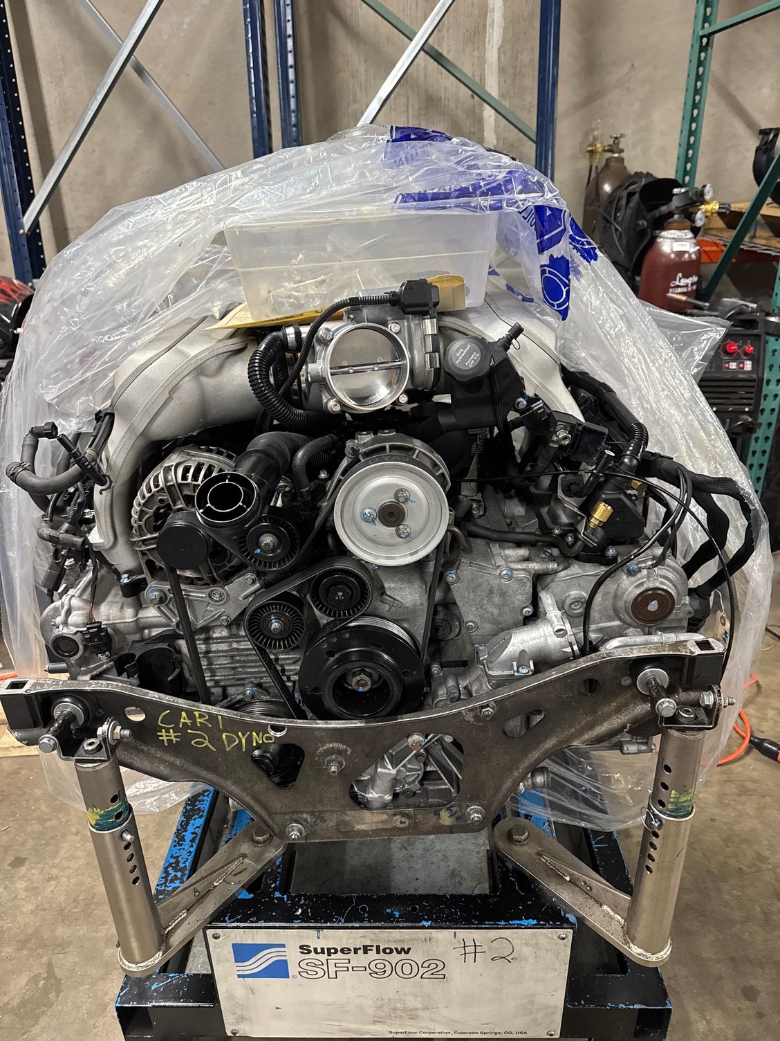

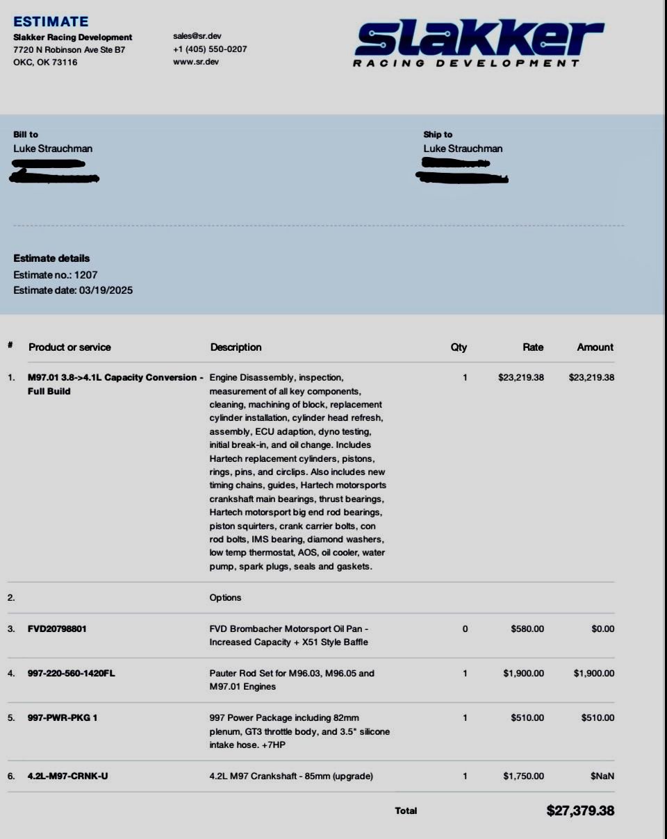

Bore score on cylinder 4 confirmed and i’ve decided to go the Slakker/hartech route. Bought my car with 60000 miles and just turned 1790000 so the motor had a hard but great life. Spoke with Brandon about a month ago to start my rebuild on my 3.8 Carrera S motor and he said that he just finished a 4.2 build and that it was for sale. It’s being shipped as we speak and will be arriving this week, so hopefully the car is up and running Very soon. Will report back with my interpretations of the rebuilt motor.

Originally Posted by cloud9blue
curious about the custom crank. i assume the bore stays the same as the 4.1L builds. additional capacity came from the increased stroke with the new crank? any reason why not just step up the displacement even more like some of the other builders? want to hear some opinions from someone who also tracks these cars, opposeed to the street /C&C builds we typically see on this forum.
Going from an 82.8mm to an 85mm stroke requires reducing the rod journal from 52.8mm to 50.7mm (1.999”), which increases displacement from 4.115L to 4.225L.
Technically, we could go to an 85.5mm stroke (4.25L) and call it as a “4.3,” but that would be more about marketing than meaningful performance gains.
The 1.999” journal size matches the small-block Chevy, making it easy to source race-quality rod bearings.
Since a large portion of our engines see track time, 1.999” is about as small as we’re comfortable going.
