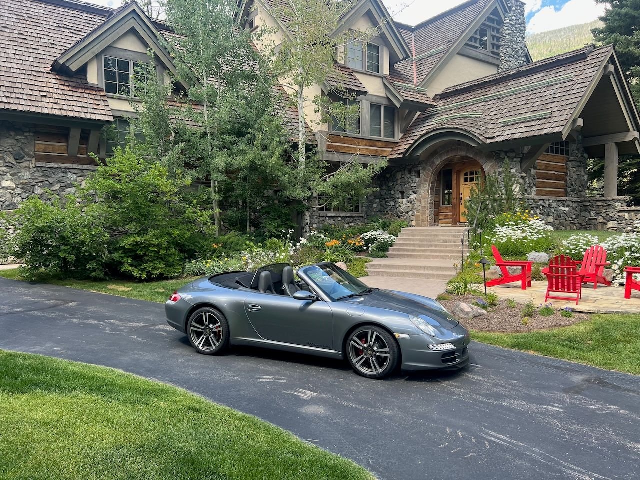

Thanks guys - here was the result - they fit perfectly! Look awesome.

They look great on your car! The black wheel accents and black top compliment each other perfectly.

Looks beautiful. Well done. I'll keep an eye out for those wheels.
