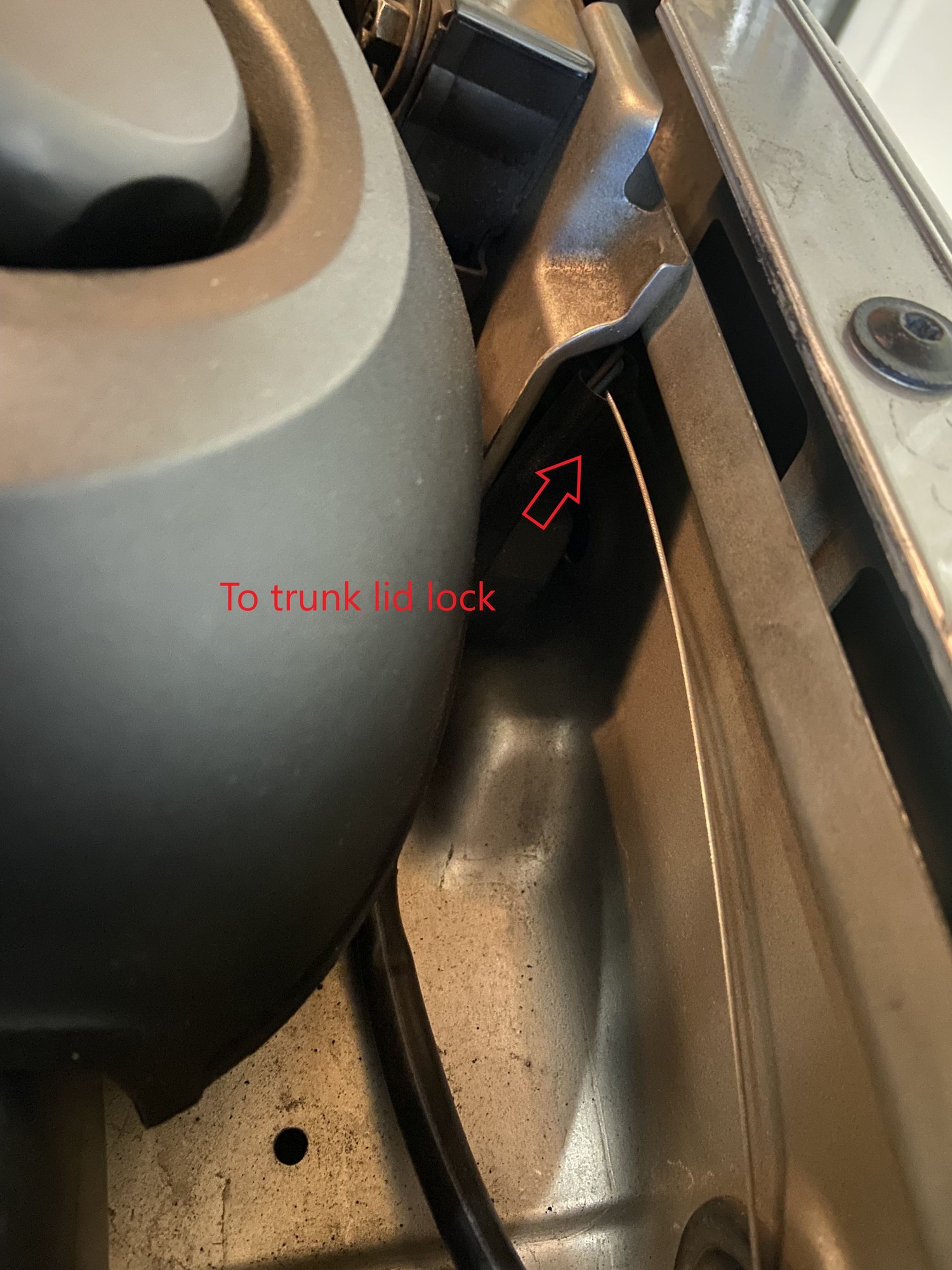

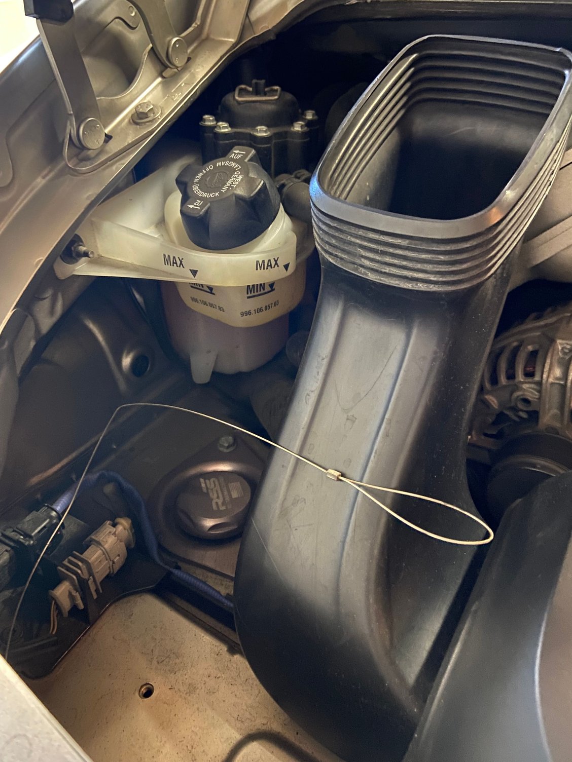

There appears to be a manual cable for the engine trunk. I located this laying loosely in the left side of the engine bay. Is there a guide that this cable should route through? I suppose you should be able to access this cable from the exterior of the body somewhere below, I do not know.
Trunk lid release cable - Where does it route too?
Cable routed to engine trunk latch

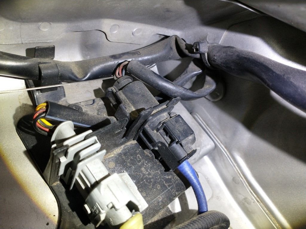

Relocated my emergency engine lid release from behind the rear license plate to Petza914's suggestion dropping it between the rear heat shield and the bumper. Extended the factory cable length with a small section of bike brake cable.
End loop of the factory cable routed to the opening just behind the wire harness in the photo below
Removed the left tail lamp assembly (two T25 torx screws), shined flashlight inside the hole next to the lower slot where the tail light mounts and you will see the end loop of the factory cable. Use a coat hanger to pull it up through the hole so you can connect the cable extension to the end loop (I used zip ties).
Feed the loose end of the cable extension back into the hole and push it down into the small gap you will see toward the rear in the bottom of the cavity. The extended cable end will appear near the left exhaust tip.
Here you can see how the cable extension is attached to the end loop of the factory cable
I wound the cable extension into a small loop and secured the loop with zip ties to keep it from unwinding then pushed it up between the heat shield and rear bumper so it can be easily reached.
Again, kudos to Petza914 for this simpler solution.
