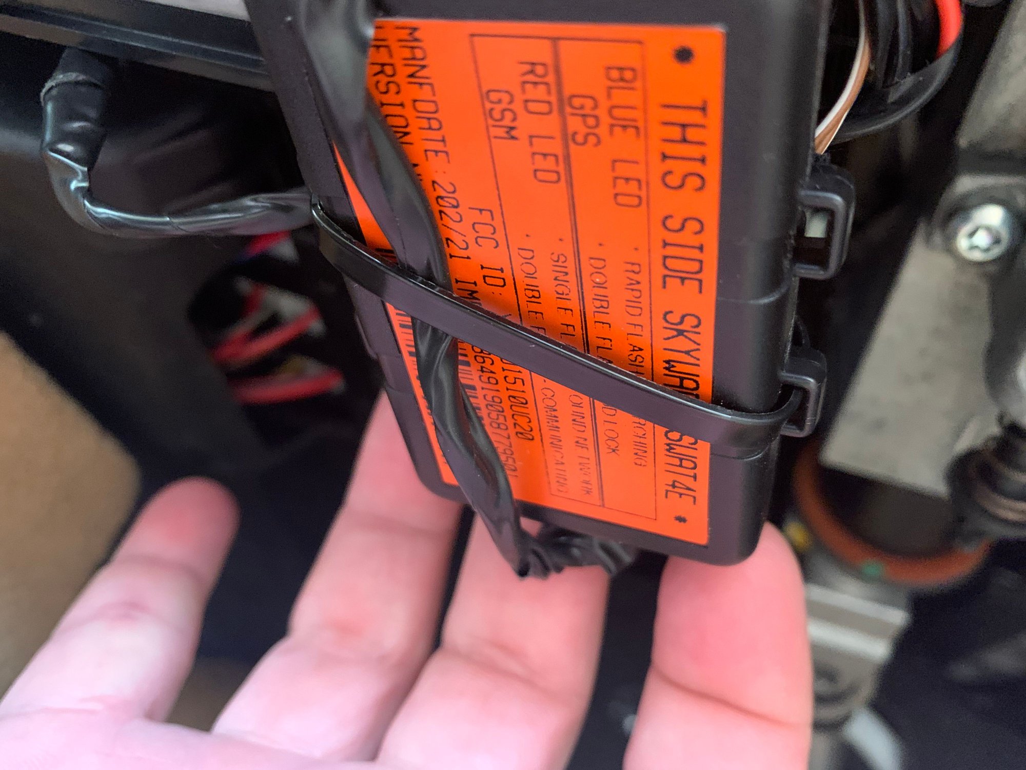

In case anyone is interested. I found the culprit. SWAT GPS tracker. Supposedly an “option” from dealer like like Lo-jack. Makes noise if not active subscription. Also read that dealers use them for various reasons i.e. insurance rates, theft recovery, and last but not least Repo!
I'm interested. Nice job tracking down that tracker !

where is/was it? Where did it get its 12volts from?
