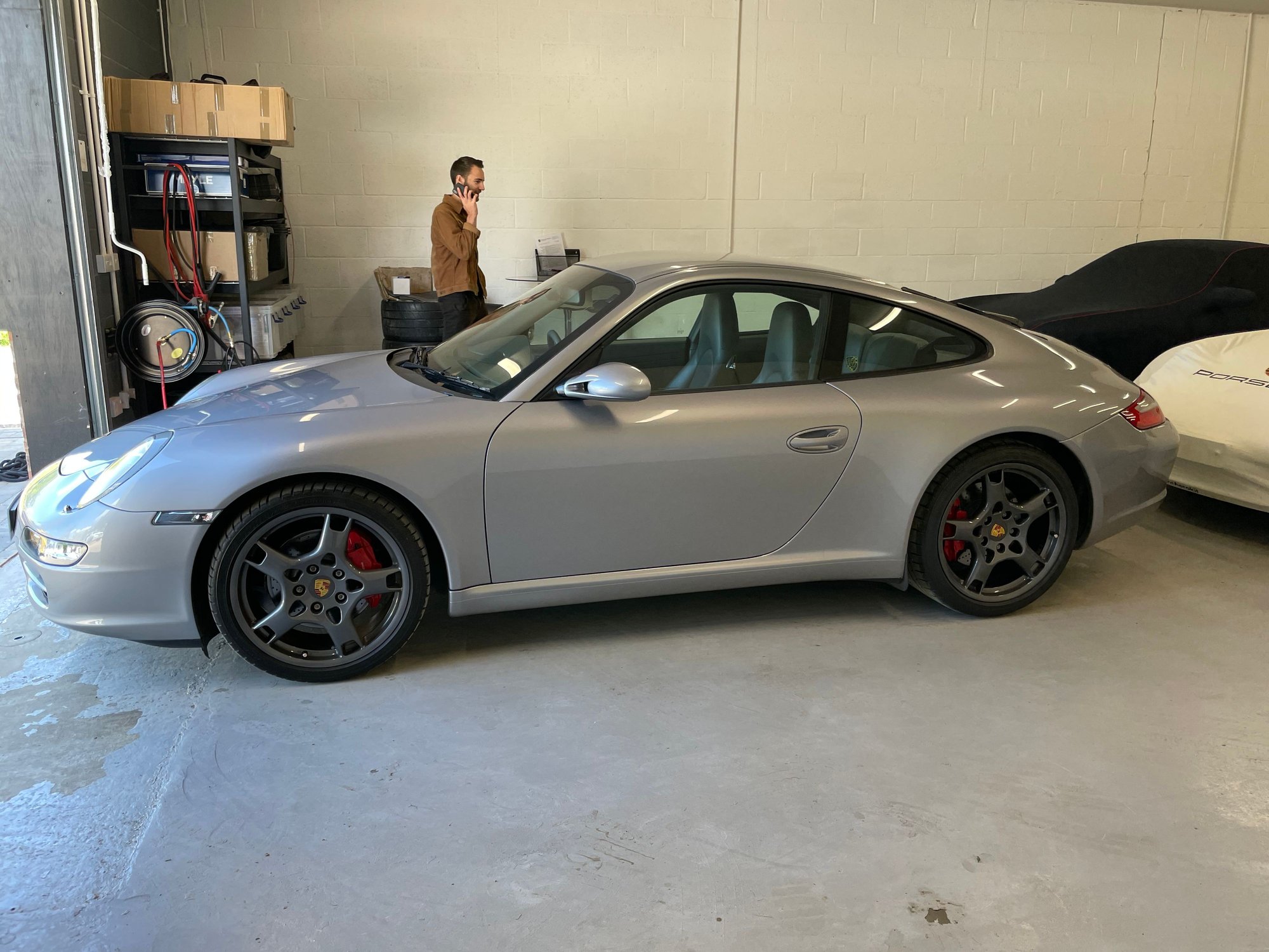

Looks good with those dark wheels. Were they painted?

Thanks! They were indeed, they were painted by the previous seller I believe. Seller (Porsche specialist) then refurbished them thankfully!

Thanks, Okbarnett! They were painted by previous owner and then the dealer (Porsche specialist) refurbished them thankfully!

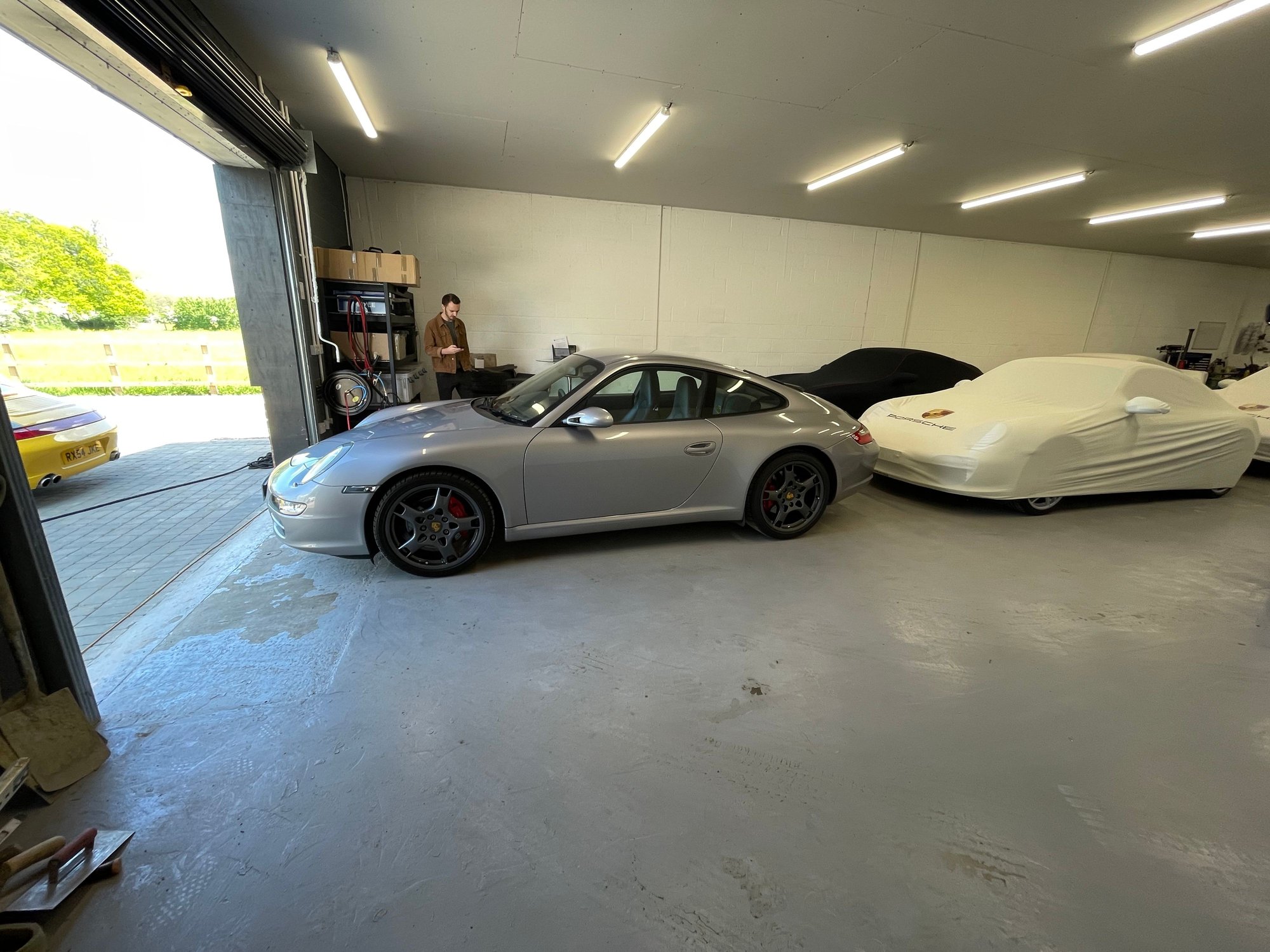

I’ve got nothing, other than your garage is epic. I’m in planning phases from a big garage that will handle a 45 foot motorhome and several cars.
O Sh*t is that the OP's garage? I assumed it was where he was picking the car up from. Either way looks like a great collection.

** I suspect this isn't OP's personal garage. There's a yellow Turbo in the corner of one shot and god knows what's under the covers.

Looks an awful lot like the Friends Green Porsche garage.
Old Aug 2, 2021 | 10:40 PM
TerrestrialFlyte's Avatar
TerrestrialFlyte
Joined: Feb 2020
Posts: 1,543
Likes: 910
From: Lone Star State
That’s what I was thinking too.
