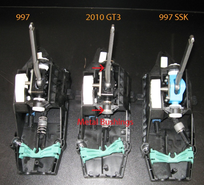

Both my 997s have SSKs in them but I don't know what brand they are as they were in the cars and identified during the PPIs. I believe the one in my wife's car is blue in color if anyone know what that is. Both cars have the OEM cables but I have a set of Numeric Cables in the closet for whichever car needs them first. Both cars have recent PTX and shift great.
I think the Blue is the factory SSK. I remember seeing blue in a picture of the 3 factory assemblies side by side before. Found it quickly. From Planet-9 forums.
Review: Factory OEM vs SSK OEM vs GT3 shifter | Planet-9 Porsche Forum
