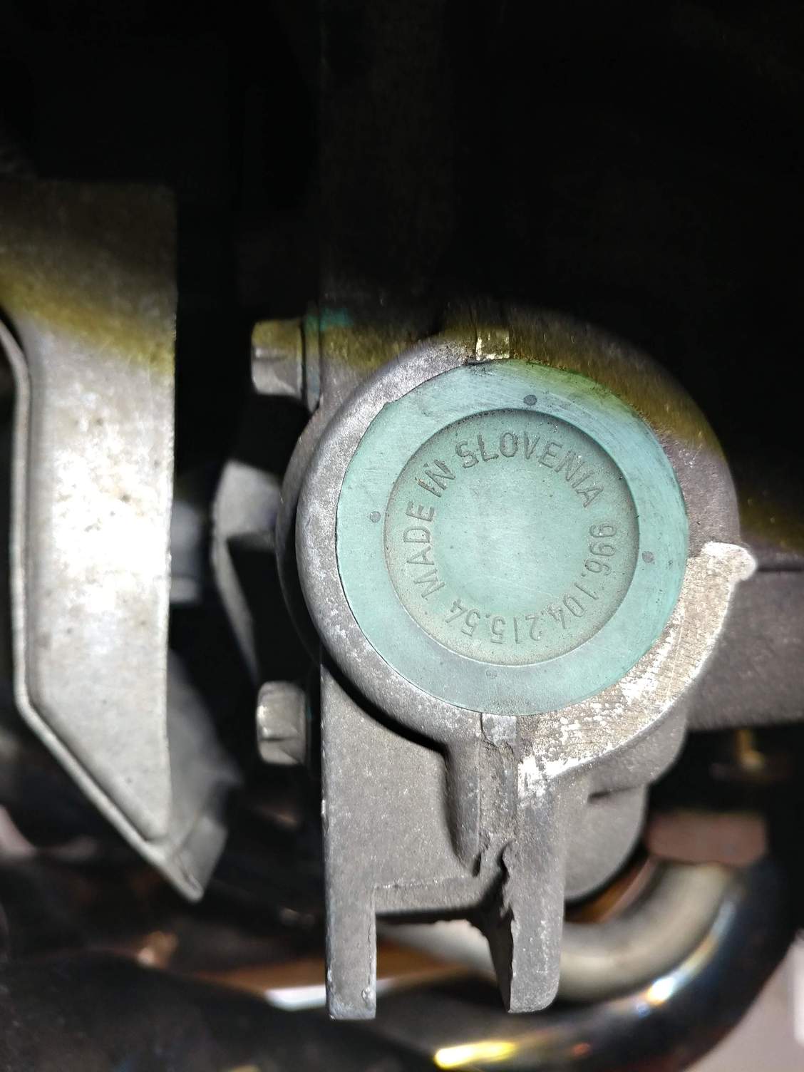

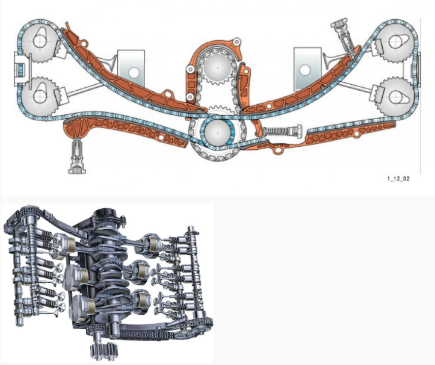

pbxtr!!, stop driving the car until you can have all 3 of your chain tensioners replaced. Bank 1 and the IMS one are fairly easy. To do bank 2, you have to remove the A/C compressor (3 bolts - not terrible but leave all the lines connected). To do this though, you'll need to pull the airbox and remove the serpentine belt - pretty easy as well.
The plastic bits you found are exactly that. Dark brown plastic is from one of the tensioner pads and black plastic from different ones. What's happening is the springs in your tensioners have become weak and when the car isn't running and the oil pressure bleeds out of them, the spring isn't holding the tension on the chain until the tensioner can repressurize. So, the chains are actually slapping against the tensioner pads and chipping the plastic away. That plastic is the only thing that keeps the chain from hitting the metal paddle underneath the pad - when that happens it's game over and you'll have chunks of metal tension paddle in the oiling system. Mike Murphy - this is the cause of the rattling noise you're hearing as well so you need to do the same - that's called the cold start "death rattle". The new tensioners will have fresh springs and no wear on the seals, so will hold the oil pressure longer so they'll pump up faster and the spring will hold the static pressure on the chain for the initial start better to prevent the slapping and eliminate that noise.
As far as changing oil. My recommendation would be Driven DT40 and it has properly high levels of Zinc, Phosphorous, and Moly where you don't need to add anything else to it. Coming from Mobil 1 where the base stock doesn't play well with that in the Driven oil, you'll need to do a flush between the changeover. Do a normal oil change and instead of going right to the DT40, use their Break In oil - either BR30 or BR40 for 100 miles, then change the oil and filter again and put in the DT40. You can get any of these oils from Summit Racing or LN Engineering. Motul xcess 8100 5W/40 is another good choice if you're worried about using an oil with A40 approval, but my personal UOA reports on 2 997.1 cars are the best with DT40 over the Motul or the Mobil 1 I had started with. I now use Driven lubricants in everything - transfer cases, differentials, engines, automatic transmissions, manual transmisison with LS, etc. The one exception is the MT in the 997 where Mobilube PTX is the absolute best fluid for our transmissions.
To change the tensioners, you need to lock the cams at TDC so you need a crankshaft pulley locking pin (a correct size drill bit will also work) and the cam lock tool. To access the cam end to lock them you'll need to pull 2 disposable plugs out so you will need new plugs to reinstall. You can get these from FCP Euro for a couple dollars each. Do one tensioner at a time - remove it, oil the new one and install that before moving onto the next one, so 2 tensioners stay installed in the motor at all times while both the crank pulley and the cams are locked by the tools.
Photo of Bank 2 Tensioner below A/C compressor and compressor mounting bracket

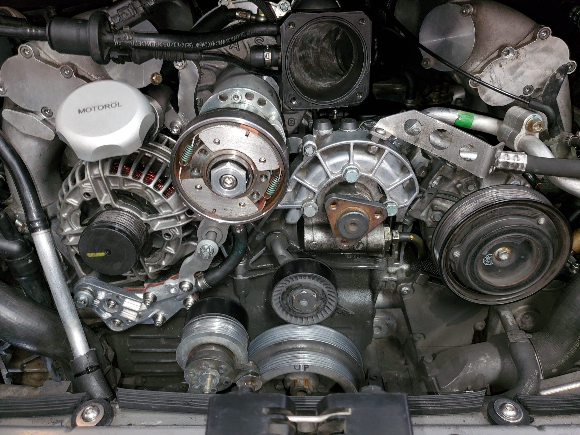

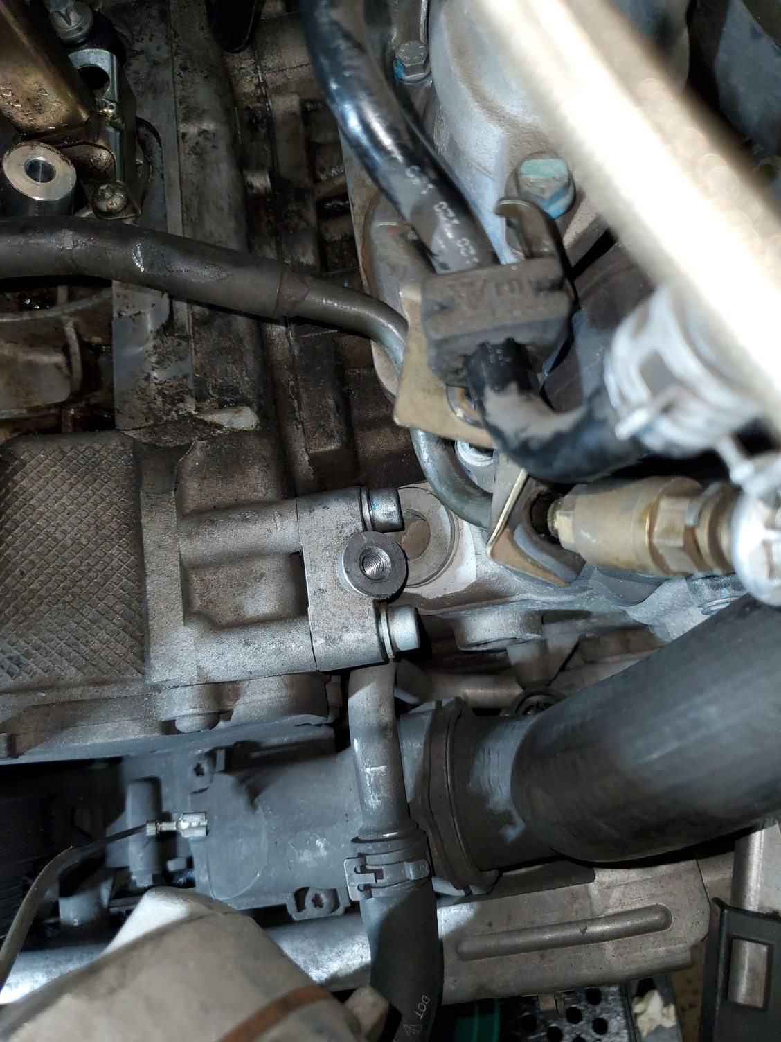

Yes, Bank 1 and the IMS one are pretty easily accessible. Bank 2 is the pain because of the AC Compressor and mounting bracket. My car has a different crank pulley because of the supercharger, so I was a little worried because there's no hole in my pulley to lock the pulley to the hole in the block. I rotated the motor, locked the Bank 1 cams and then used a clamp inside the crank pulley to hold it in that position and put a scribe mark at exactly 12 o'clock so I'd be able to tell if it moved at all during the replacement procedure. It didn't move and the engine didn't eat itself when I started it, and I have about 5 hours (1 at 90-100 MPH the entire time) on it since reassembly so assume I'm good
Clamp locking crank pulley to engine brace is visible in the background
These are the one time use cam end plugs that have to be removed to lock the cams in position using the cam lock tool. There are 2 per motor bank. Getting to the Bank 2 ones is harder, so I locked the bank 1 cam and the crank pulley and did all 3 tensioners that way - again 1 at a time.
