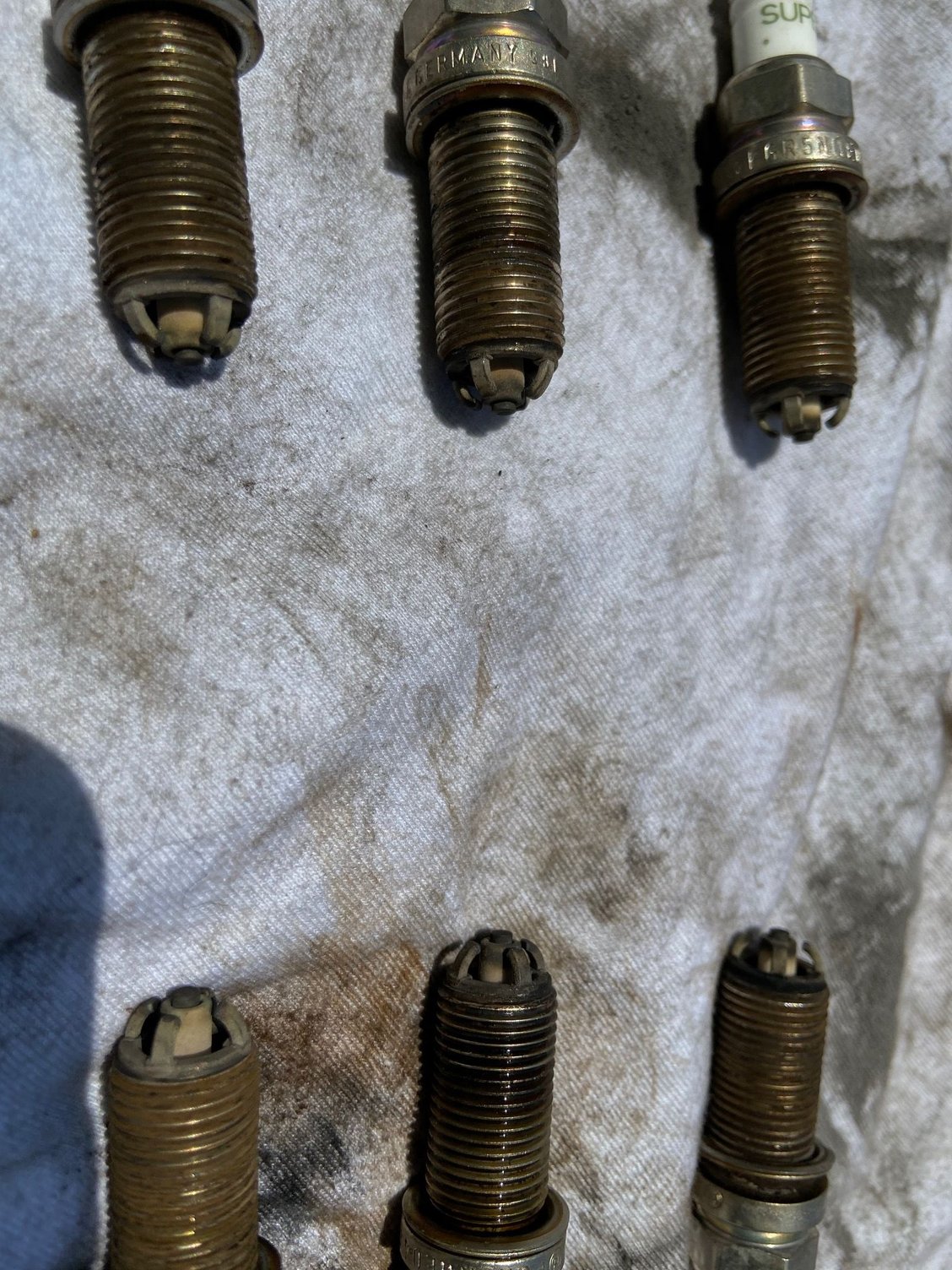

Originally Posted by Henrik964
its not the original plugs. Did a big service little more then 1000 km ago so it
should not be the plugs...
Whoa, that's odd. Here's mine at 40k miles. Damn near perfect...
It was the coils. I just let them change plugs while they had stuff away. An upgraded regular service
