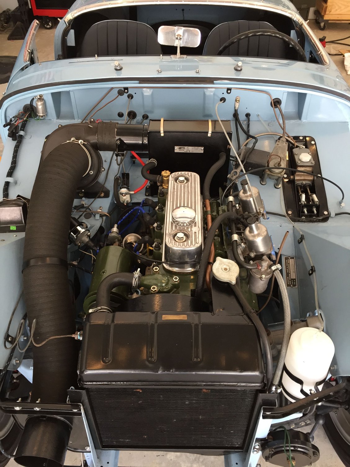

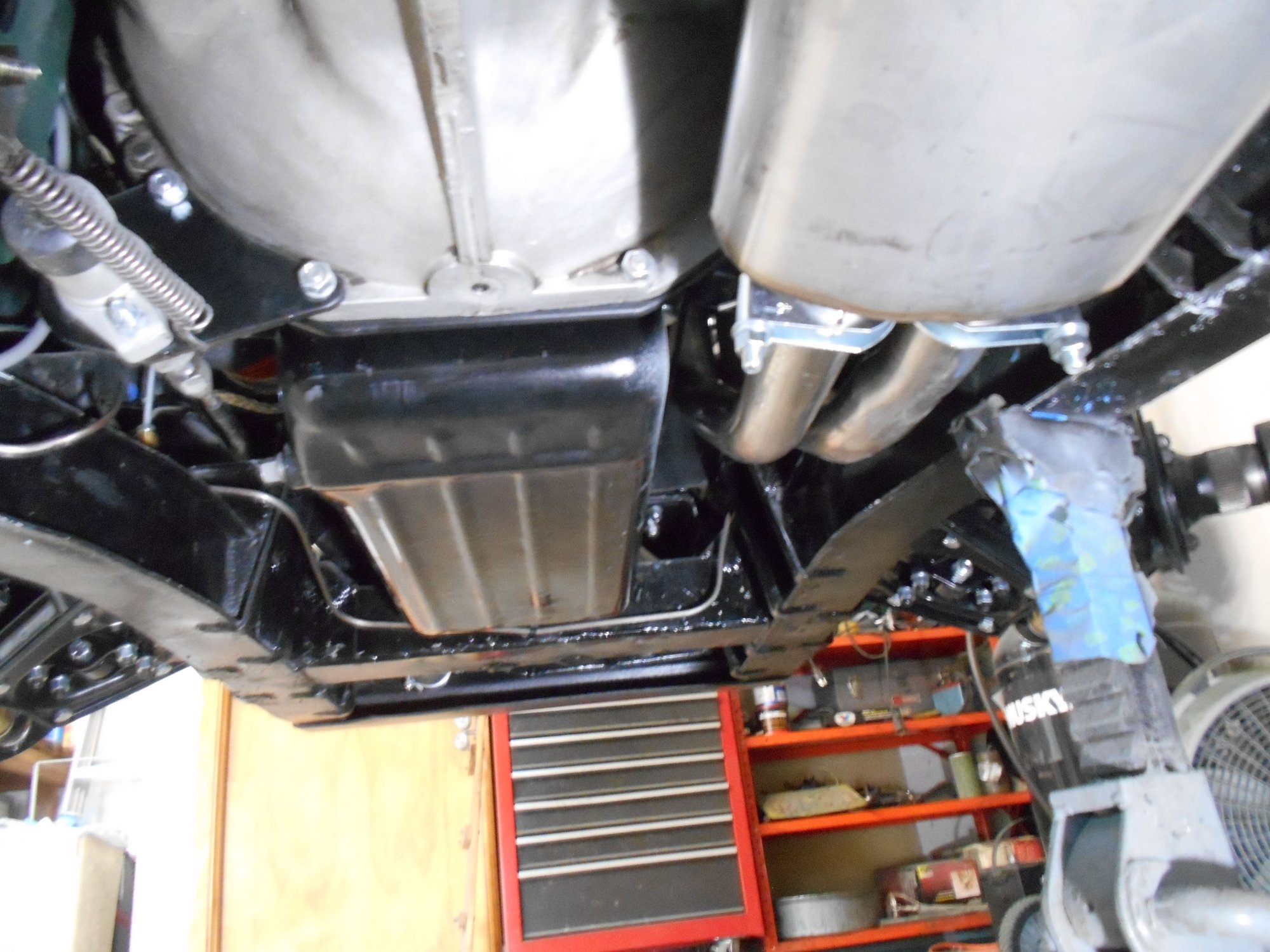

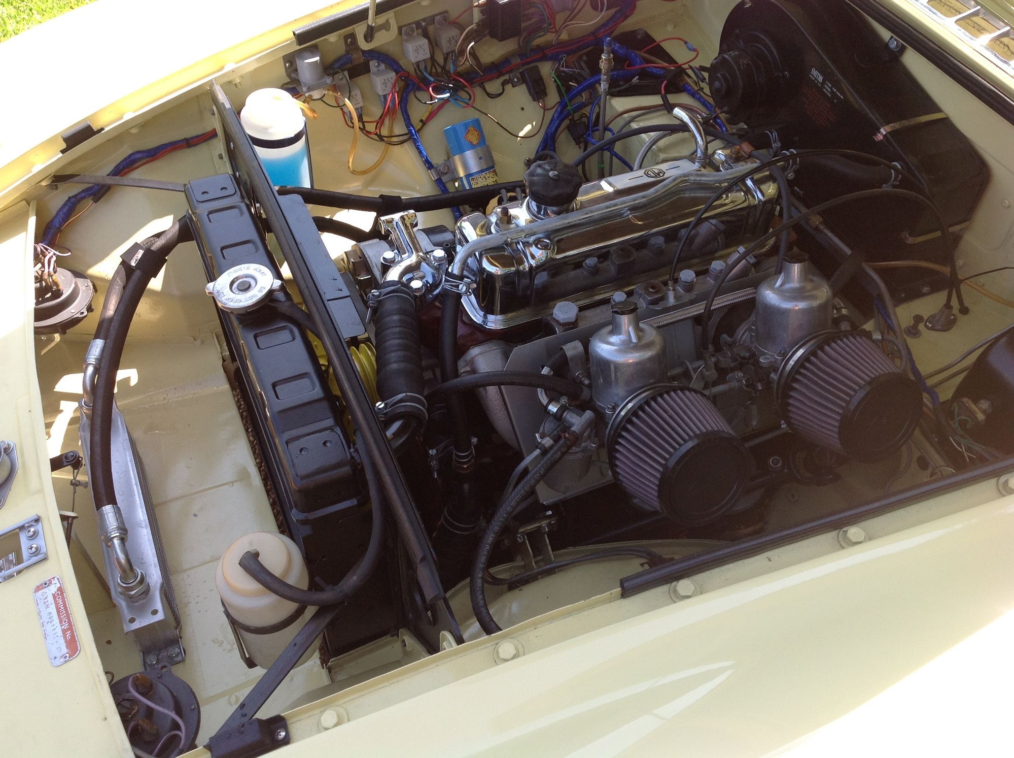

A word of warning about using products that contain sodium hydroxide, DON’T! I use a lot of SuperClean for my restorations and have a 20 gallon container that I soak parts in to degrease and remove paint. When I say degrease I mean remove 50-60 years of crud, oil and dirt buildup, etc. All of the Sodium Hydroxide products are wonderful for soaks and sprays, just not on aluminum or pot metal because it will darken them or turn them black if it’s left on too long. Buy aluminum safe products similar to ‘mag wheel’ cleaners or you may end up with discoloration after repeated use. BTW, 303 is absolutely the best thing I’ve used for protecting just cleaned parts.

I miss having this much room to work in the engine bay of an MGB. Looks cartoonishly simple compared to a modern car. Simpler times.
I love that quote because they are cartoonishly simple...not only compared to today’s cars, but to a lot of their contemporaries.
