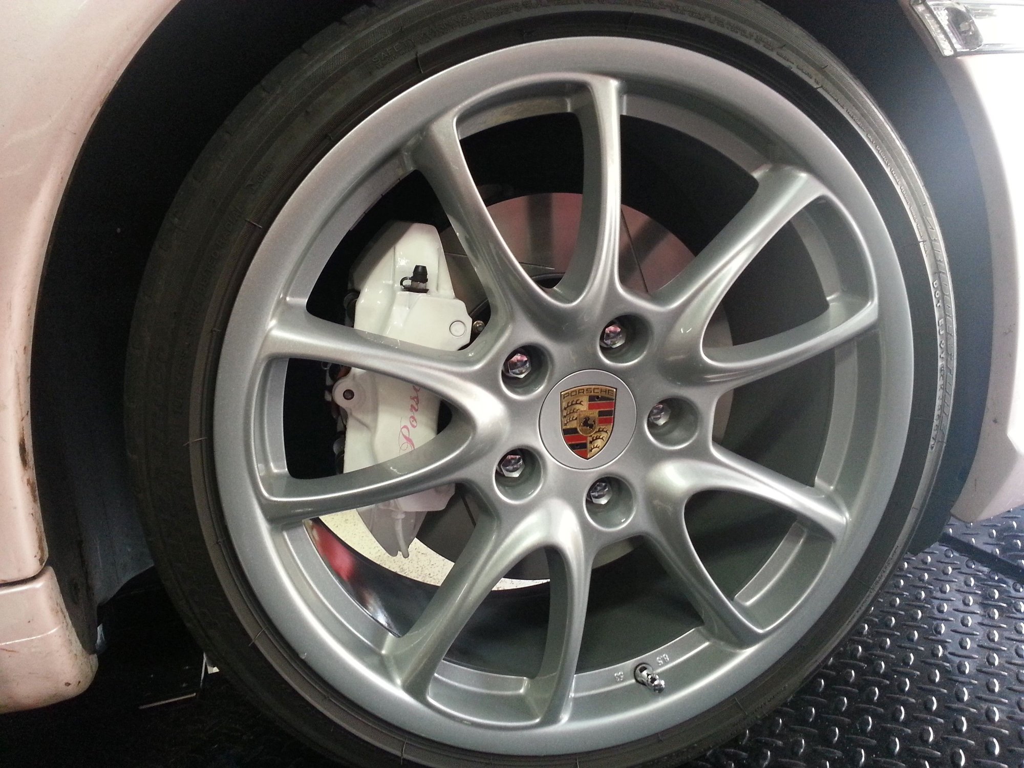

At the track over the weekend, on the last lap, my brake pad warning light came on. Just a few days prior I had the brake fluid replaced at the dealer, and I think I wore down the pads at the track. Not that happy as I've only had the car for a year, but I guess this is the price to play at the track... The car has 46,000 miles on it and it's possible the pads have never been change, but who knows. Thankfully, my tires still have some tread left. Any thoughts on changing out the brake pads, and how much it might cost?
