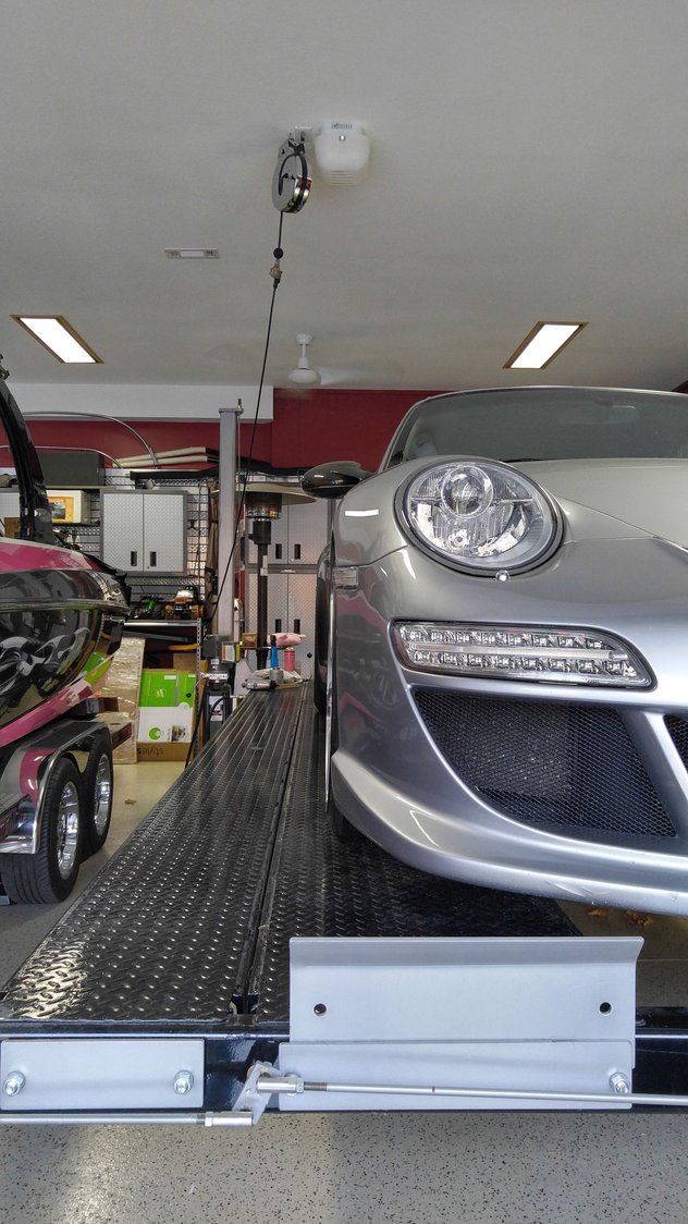

Buy a set of 997 GT3 wheels. The GT3 is a NB car and the stance, widths, and offsets are almost perfect, without needing any spacers. They are Front - 19" x 8.5" with 53mm offset and you'd run a 235/35-19 tire & Rear - 19" x 12" with 68mm offset and you'd run a 305/30-19 tire. That extra 1/2" in the rear vs all of the other OEM wheels makes a big difference in appearance, and further flattens the contact patch of the tire for possibly more grip, not that you can feel that difference. I think an offset of 50 on the front is the ideal #, so you could buy a 3mm spacer for the front if so inclined, but for that little, probably isn't necessary or worth it.
We have the GT3 wheels on my wife's C2S that looks like this. Wheel Enhancement is another good source for OEM Porsche wheels.
and here's what an et50 front offset looks like, which is what I spec'd for the custom Forgelines on my silver car.
Post up some pics with what you decided to do.

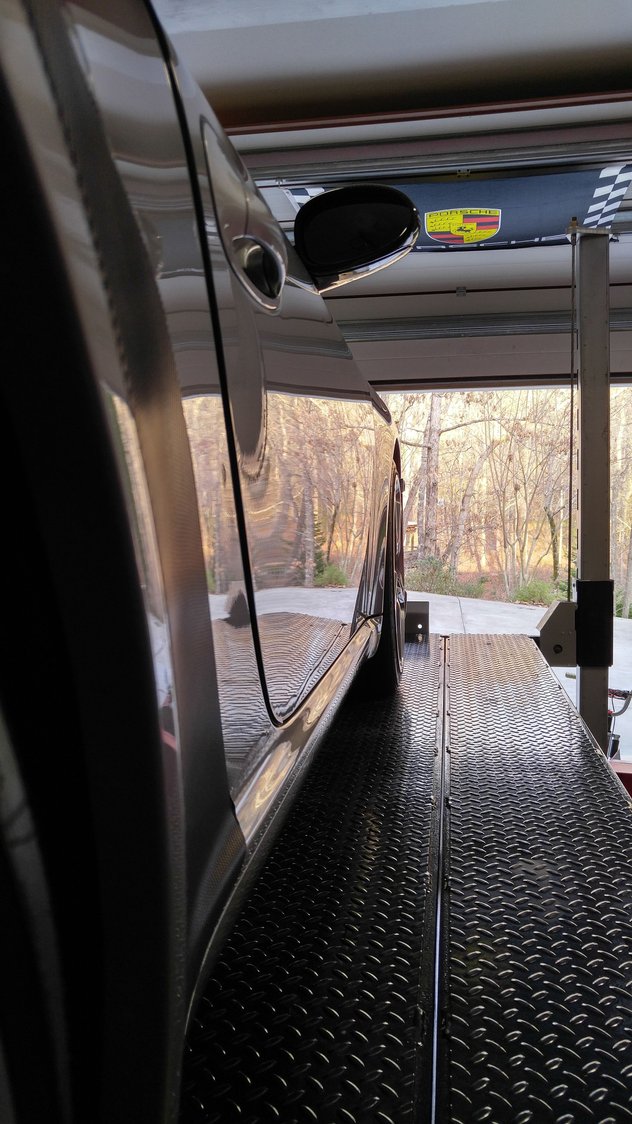

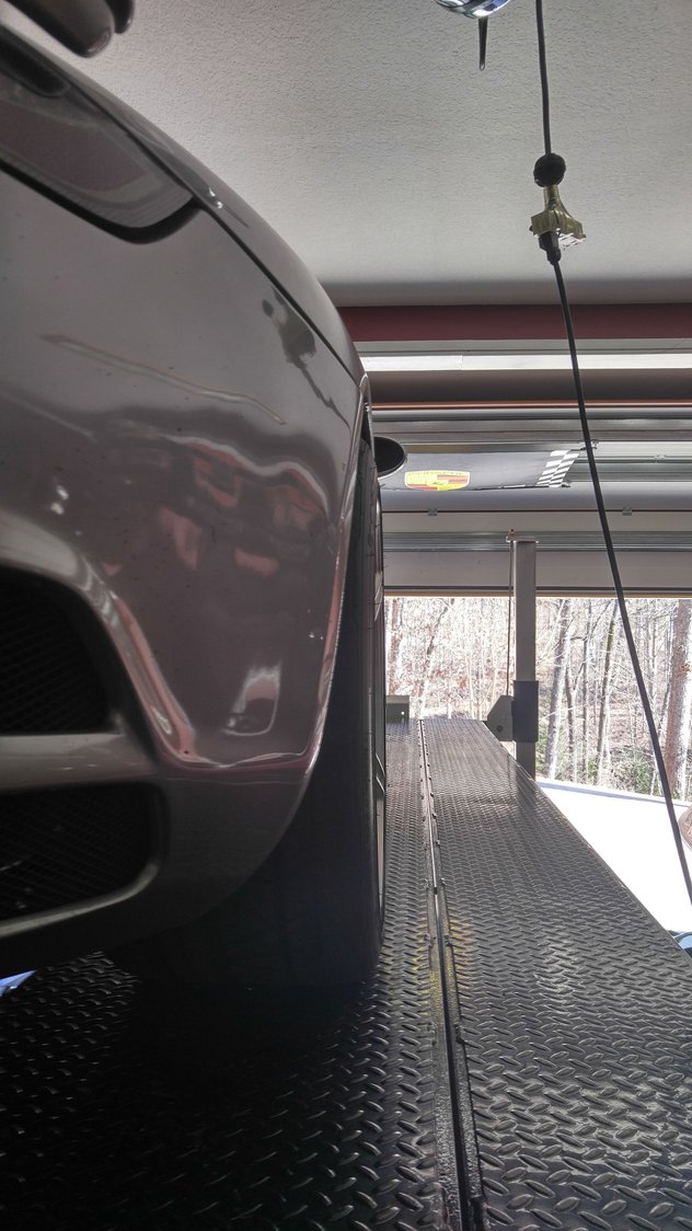

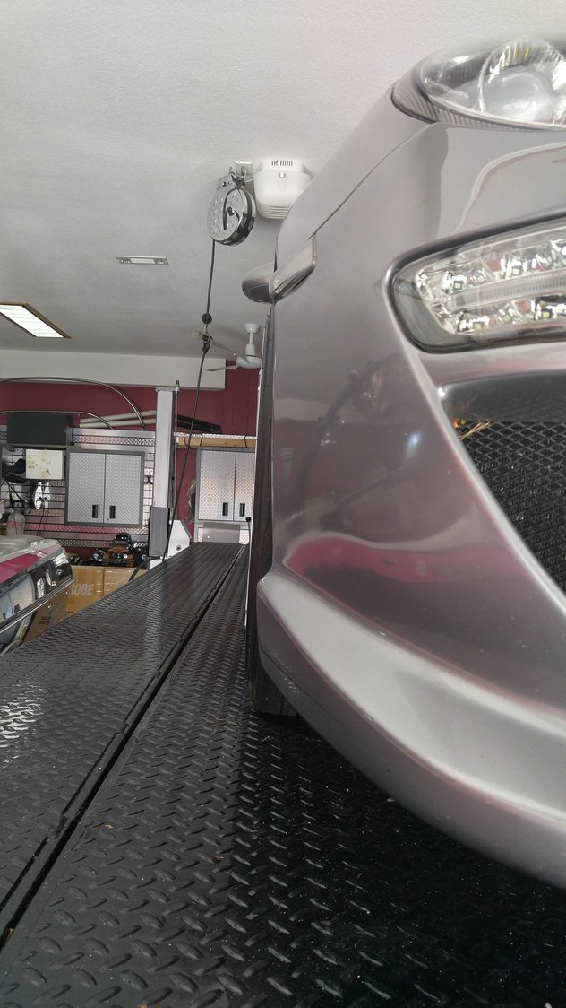

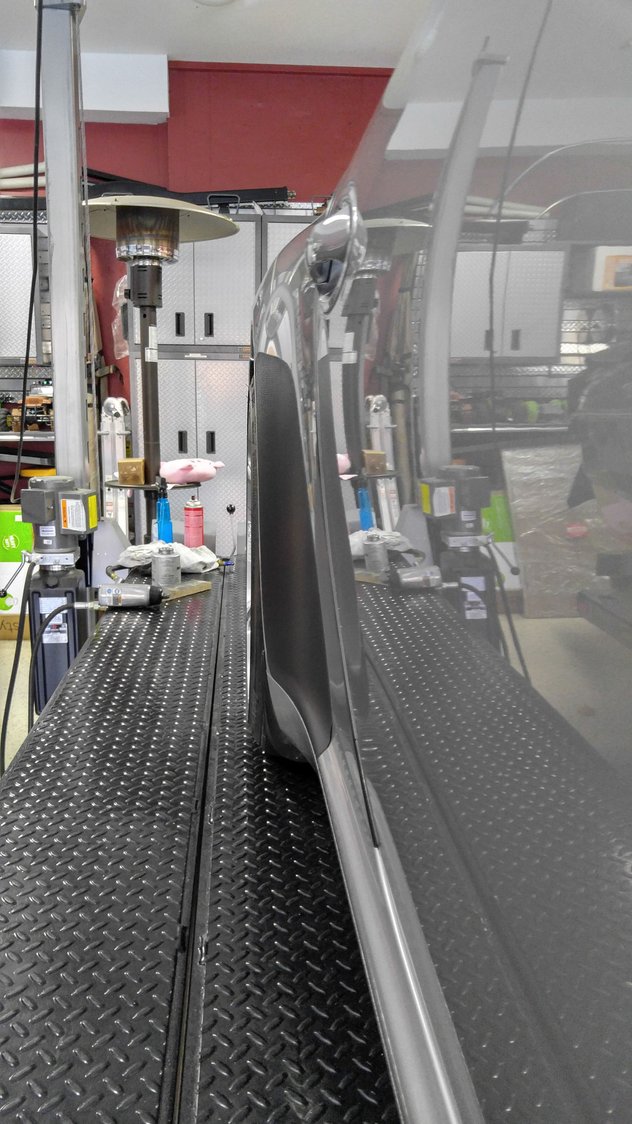

Comparing that wheel to the custom Forgelines that are on my car - 19 x 12 et 74 is as follows
Compared to your existing wheel, this new wheel will have an inner rim which is 34.7mm further away from the suspension strut. The outer rim will poke out 9.3mm more than before.
This is how the rears sit on my car so the question is whether you want 9.3 mm further out from this.
I previously had a 19 x 11 et 52 on the car and it sat like this
Which I didn't like at all, so I sold them.
On the fronts, with an 8.5" wide wheel, I believe an et of 50 is the perfect #. 2mm further out probably won't matter too much, but my fronts with an et 50 sit like this
