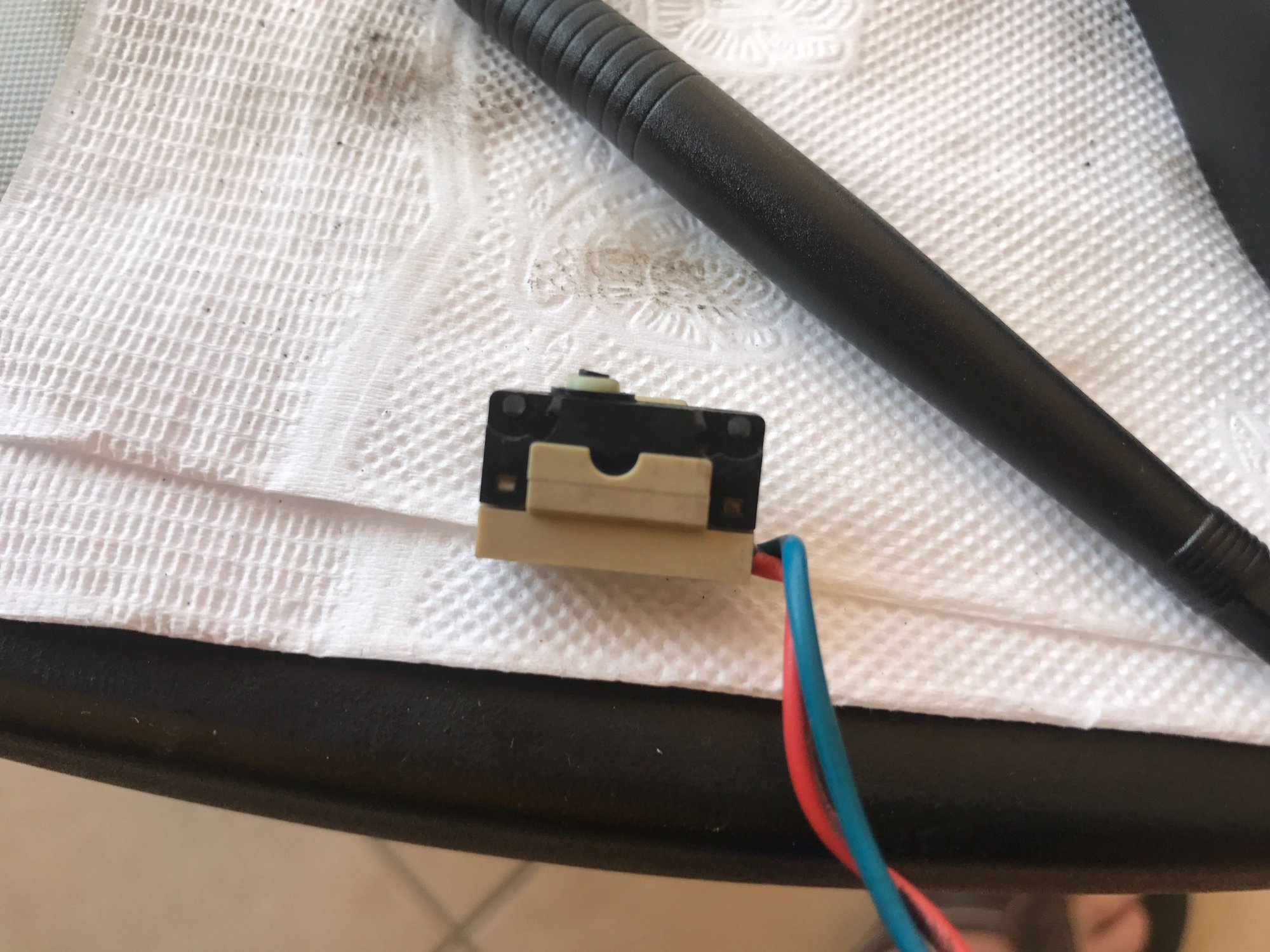

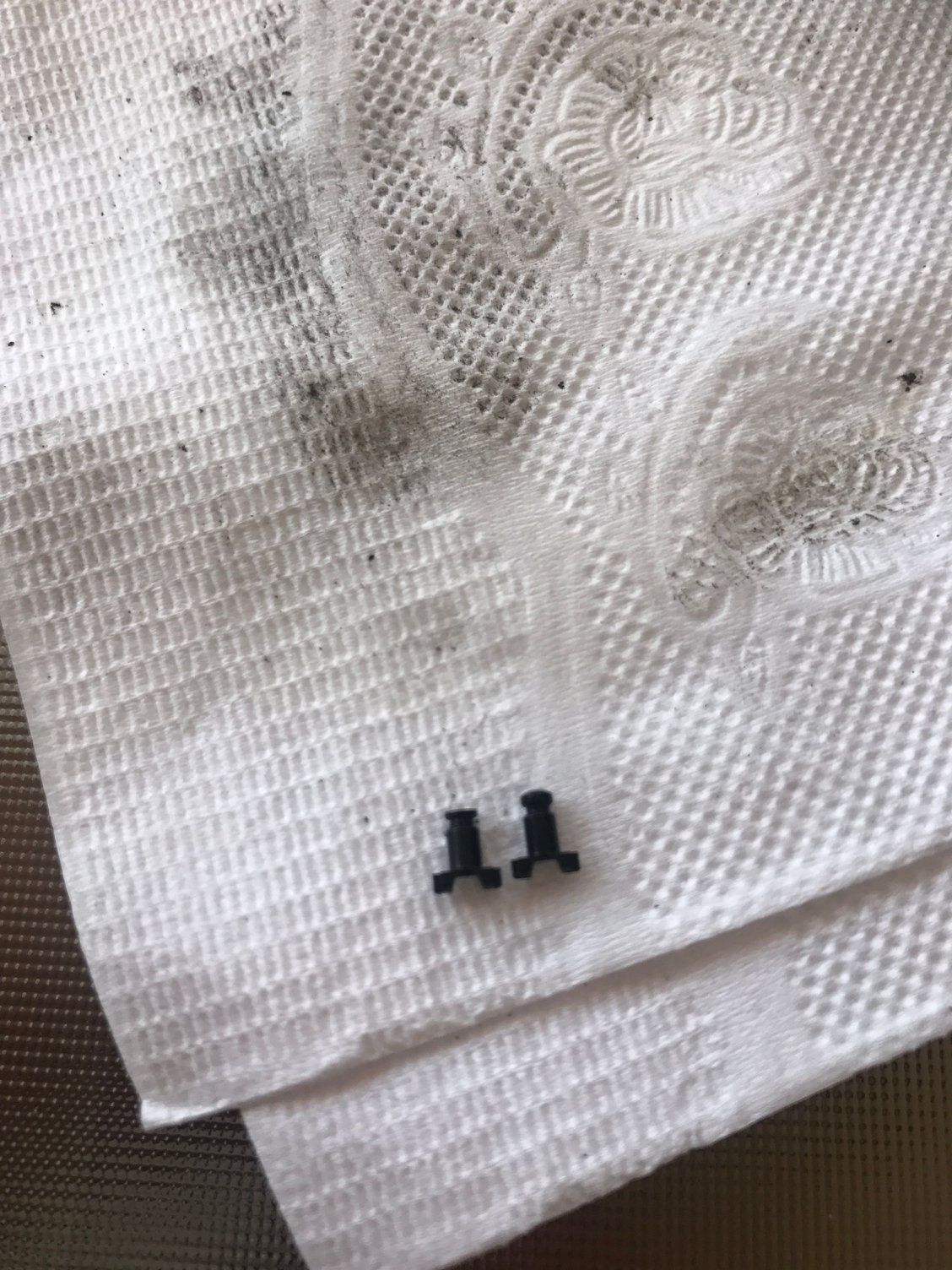

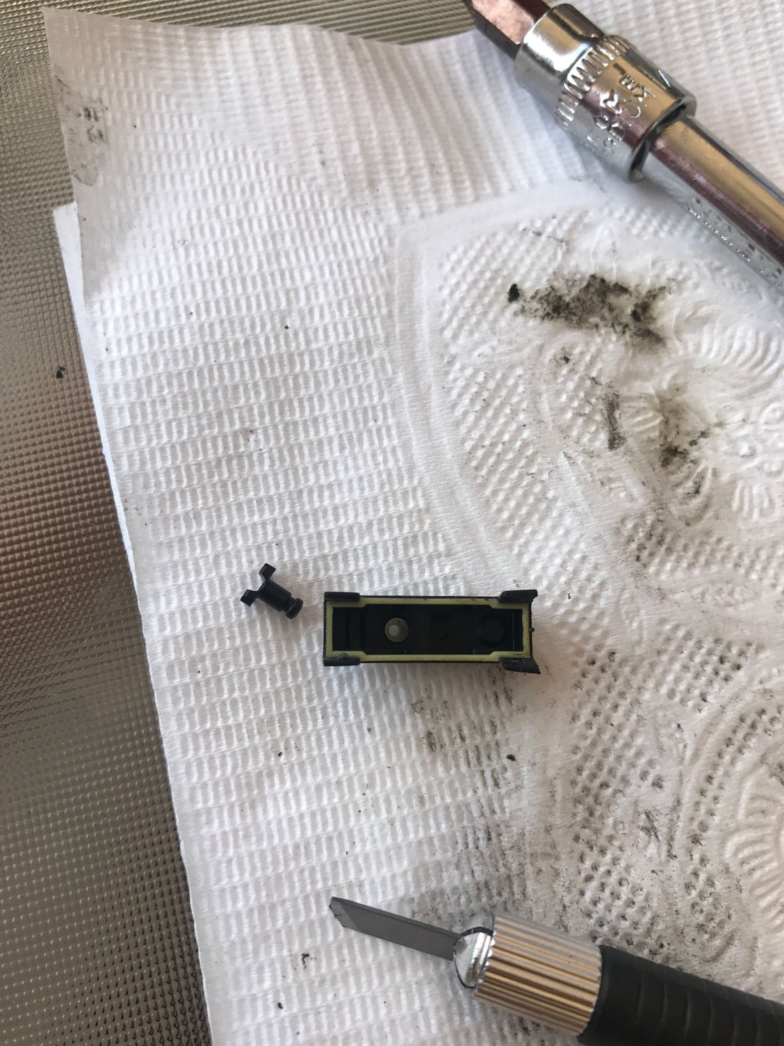

Today I opened my door and tried connecting my old door lock module and it worked fine (besides the initial problem with the microswitch and window not going down when I close the door).
Somehow, the used door lock module I got from eBay was not compatible with my car. Same with the brand
new module I bought.
While I was cleaning the door opened/closed microswitch on the old door lock module, I realized that black plastic tip that gets in contact with the door lock was very worn and that was the reason why it does not work well all the time. I opened the microswitch and replaced the tip with the same from the used door lock. Now everything works like a charm.
Still have no clue why my car refuses to work with other door locks (they have one extra letter C at the end of the part number, in comparison to the old door lock). Does that "C" mean anything?
I am attaching the pics that go with the story.
Have a nice day!
