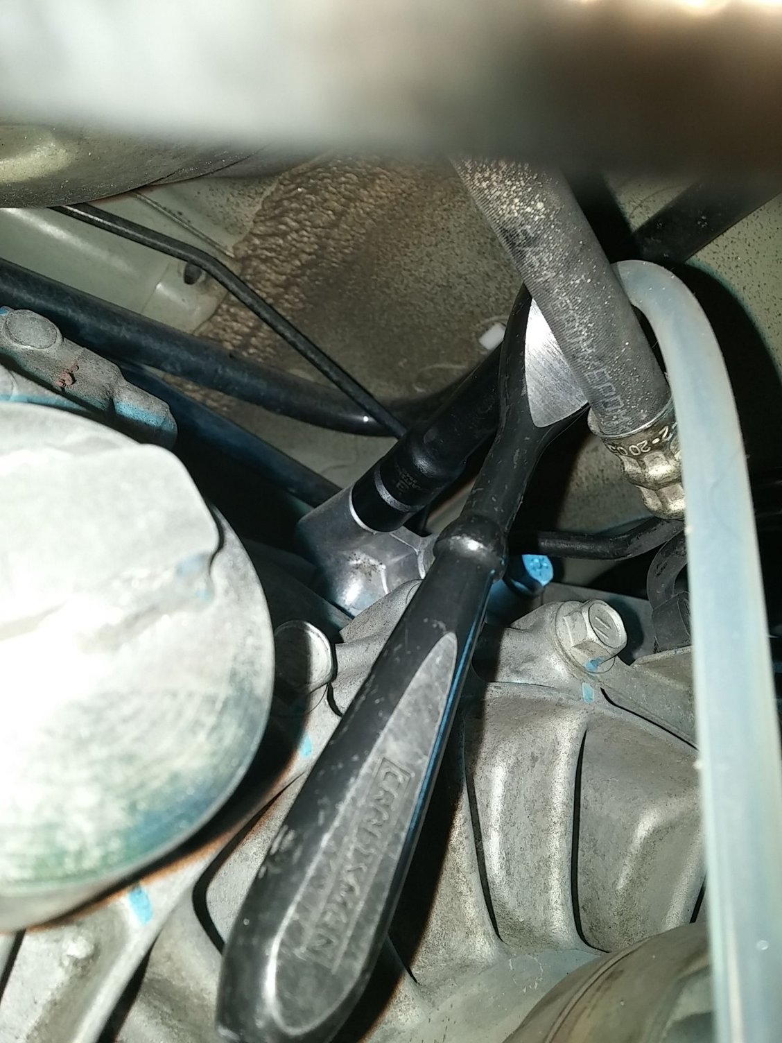

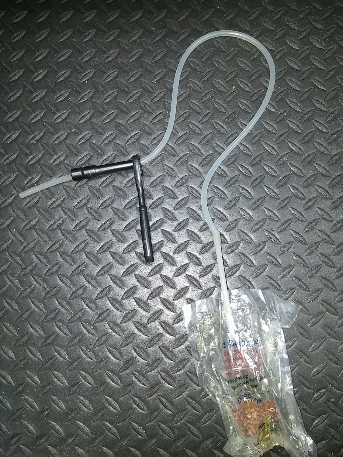

I created a great clutch slave bleeding rig using an 11mm pass through socket, silicone hose and collecting bag. Zero mess and the ratchet gives you the ability to loosen and then tighten the bleed screw without ever removing it from the fitting.

That's a sweet socket setup, definitely saves some headache and knuckache.
