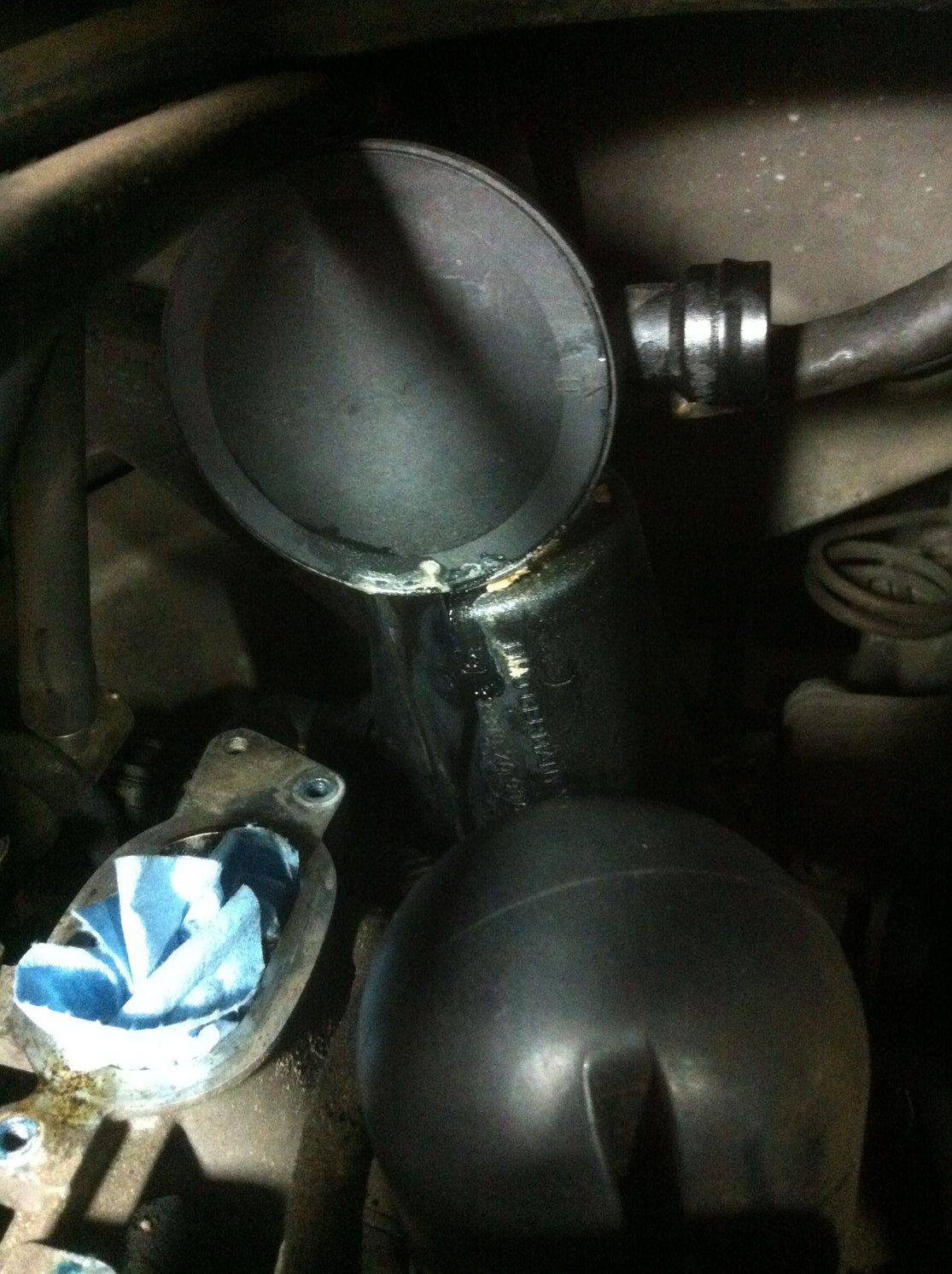

Ok. I guess I'm still on the fence about this one, I did take off the oil filler cap off while engine was running. Was quite easy to remove, not a problem at all, and the engine revved slightly higher but I wouldn't say it ran rough by any means. I'm wondering if this is a thing that I shouldn't touch if it isn't exhibiting problems. The reason why I decided I wanted to look into replacing the AOS in the first place was because I have seen white puffs of smoke occasionally on start up. And I have a bit of oil mist on the back of my car, with a VERY slight unexplained coolant loss. I wouldn't want to go through all the trouble if not absolutely necessary.
Old Mar 13, 2015 | 10:34 AM
DBJoe996's Avatar
DBJoe996
Joined: Apr 2010
Posts: 6,268
Likes: 1,497
From: Ormond Beach, FL
I did not want to discourage you but also did not want you to underestimate this project. The white puffs of smoke, oil mist and unexplained coolant loss all point to the AOS. Mine started leaking coolant to the point where there was a constant small pool of coolant under the car in the garage after a run. After getting it all apart, there was quite a bit of oil film in the intake manifold as well, but I never saw white puffs of smoke. The AOS diaphragm casing had split open resulting in the coolant drip down the backside of the engine. If you are anywhere plus of 60-70,000 miles you probably are due. It is doable with the engine in the car and there are many good write ups on how to do it. That being said, the next time I have to do this I will be dropping the engine completely. And at that point, a lot of other stuff will be getting done/replaced as well. Mine is a 99 C2, DD, with 133,000+ miles. The offender:
