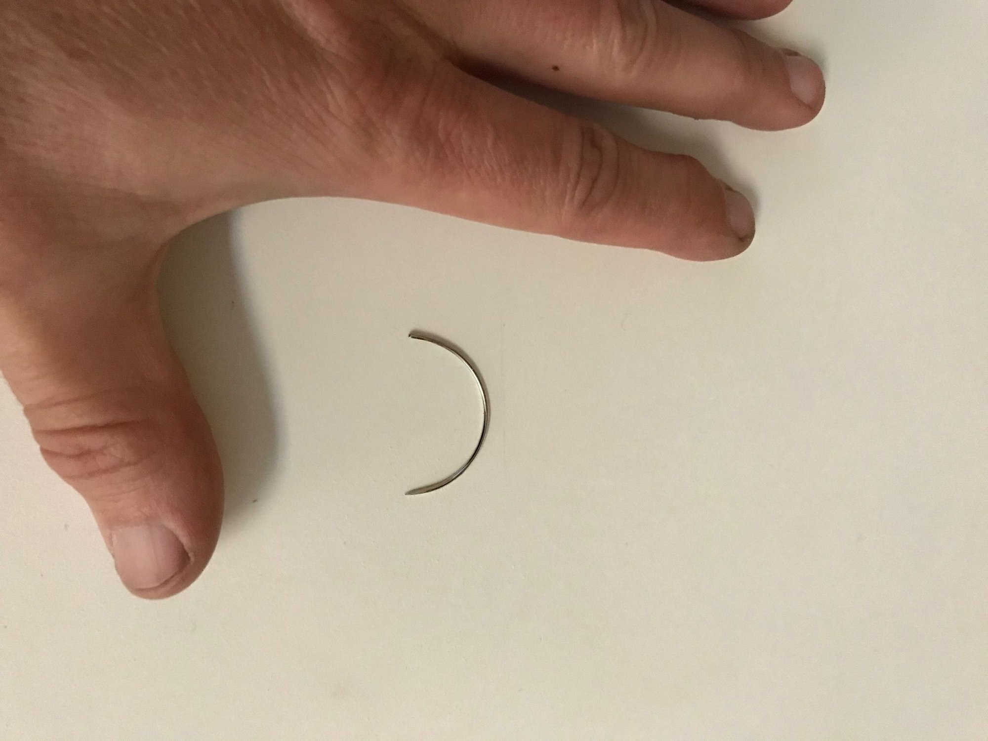

Default my fix
This is what I did
on top of sewing I also used contact cement
curved needle from walmart
synthetic thread from my wife
