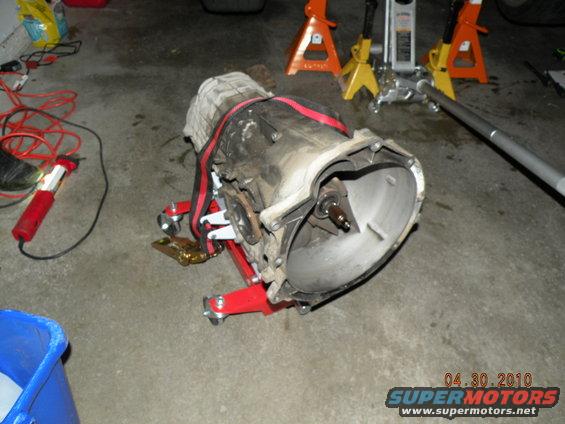

leak.....
oh crap the tranny is bigger than i thought... time to improvise...

this thing is big...

she's out...

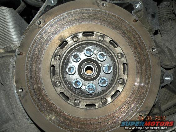

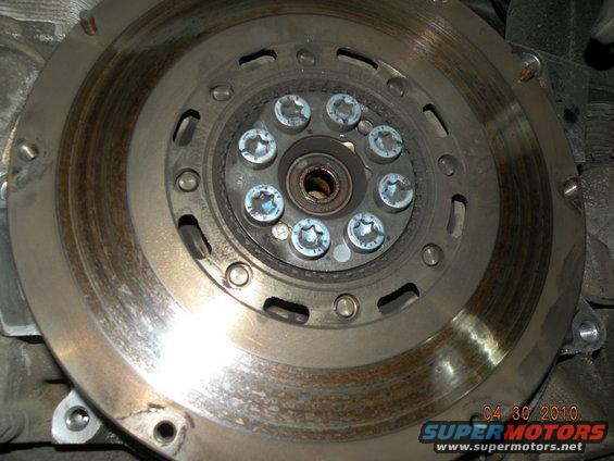

some surprises... what the heck is on the pressure plate and flywheel.. looks like little spots.. ive never seen this before...
any ideas? i dont want to buy a new clutch.. the clutch looks good... but those spots..... i definitely have a nice IMS leak...
what size torque bolt is the flywheel? im sure there is more presents underneath it that i wont be too thrilled about....
I'm thinking maybe if the car sat a long time there was bonding between the plates and flywheel. After that it was just smear the scaring is what it looks like to me. Chunks bonded and rusted to the wheel then applied friction after that. Not sure about your plates but most have metal in them. That or somebodys been frying the clutch.
Doesn't look too bad to me. Is it slipping?

Looks like normal wear to me.
