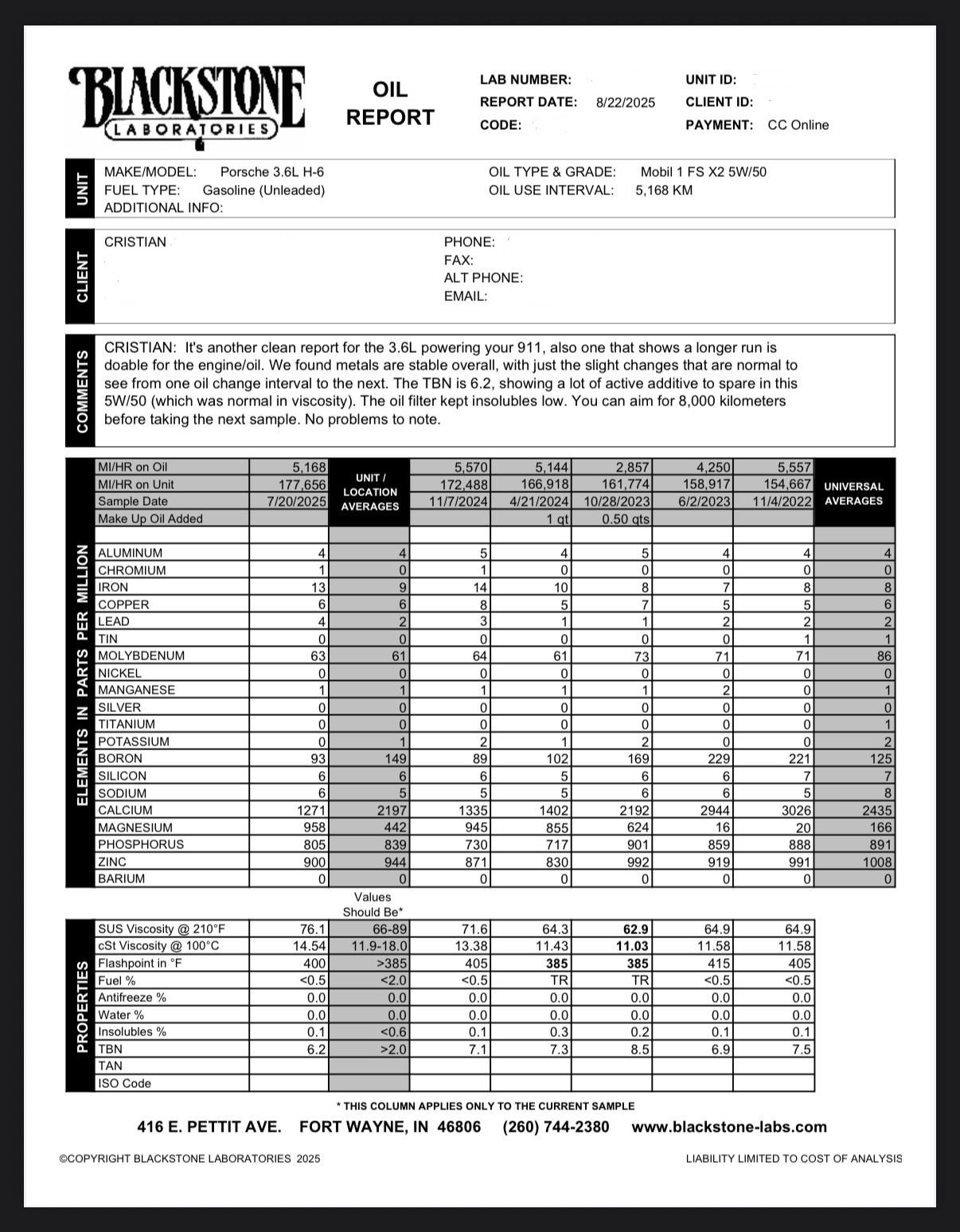

I’m wondering the same thing as I never did the bore scope when I did the PPI 4 years ago when I bought the car. I have been doing UOA religiously, is that enough peace of mind? Here’s my latest one:
That's certainly the proof in why you do repeated UOAs. Trend data. I don't see any change in AL or SI levels, so if a bore scope was clean and all subsequent samples are roughly the same, that you don't have a problem.
The fuel % is a calculated figure with BS, so you have to take that with a grain of salt. But if you see that go up over 1%, I'd start looking for injector issues that would lead to bore wash down.
Thank you for the feedback. I haven't done a bore scope yet, so right now I'm going to continue monitoring all the vitals regularly.
