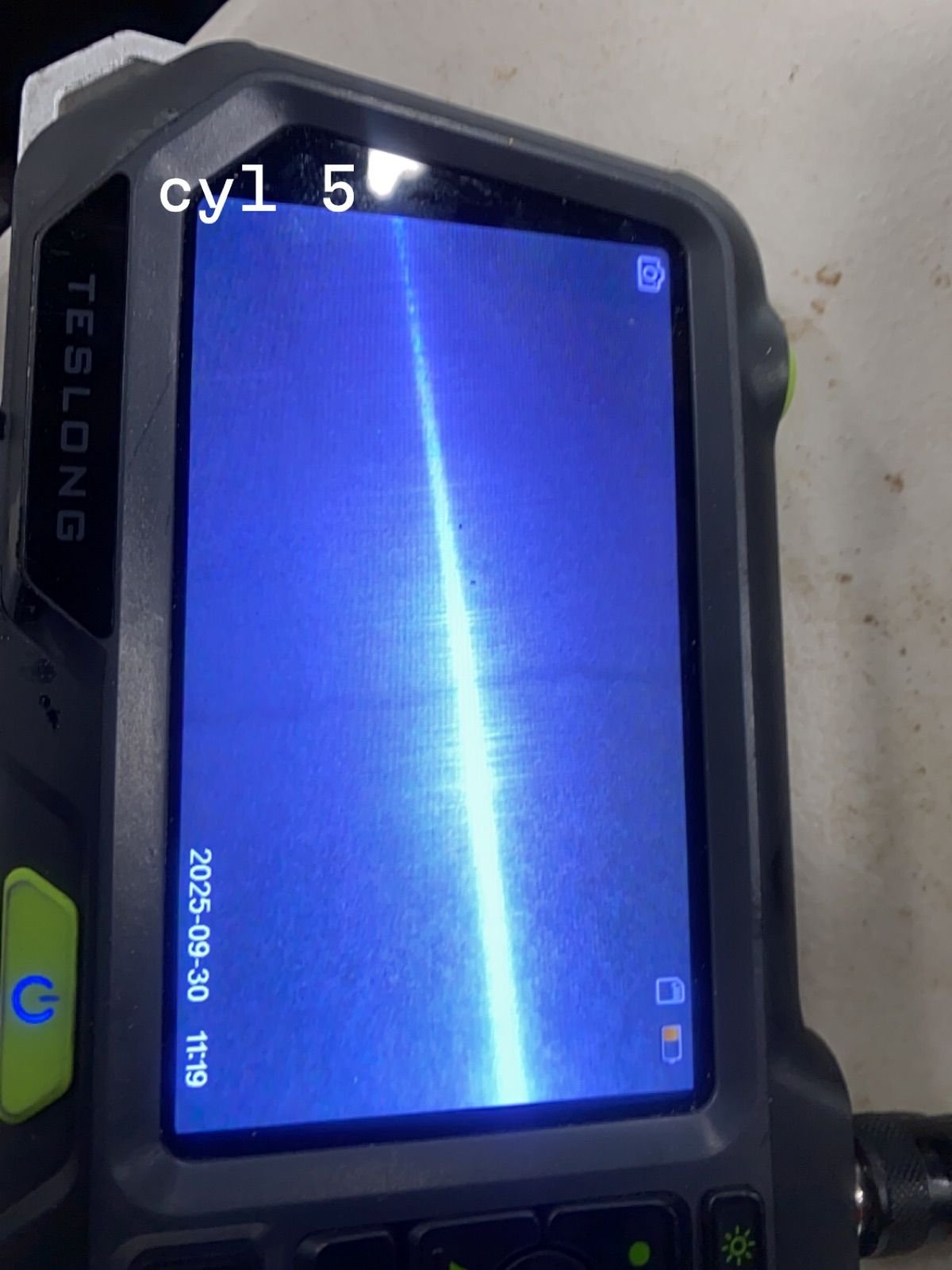

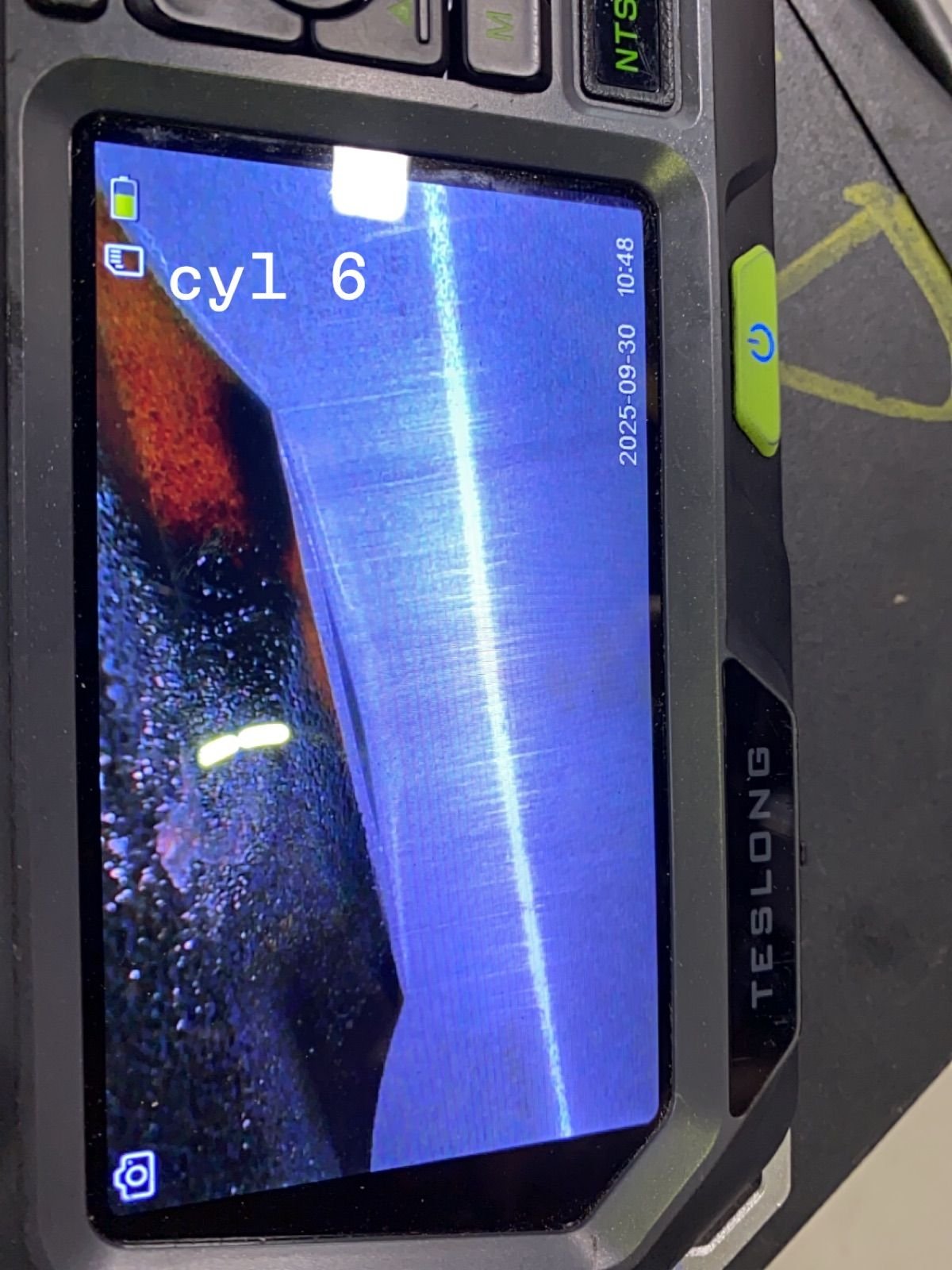

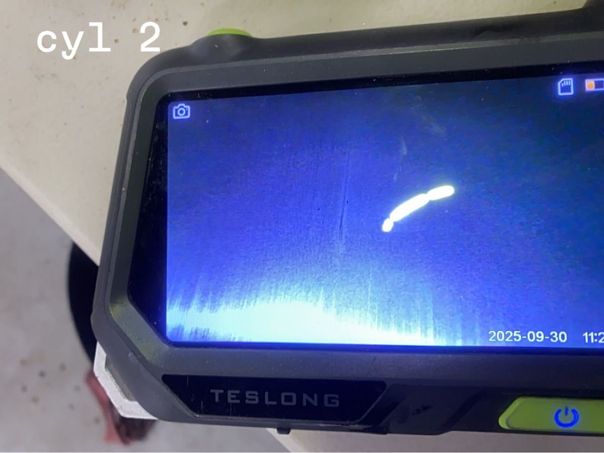

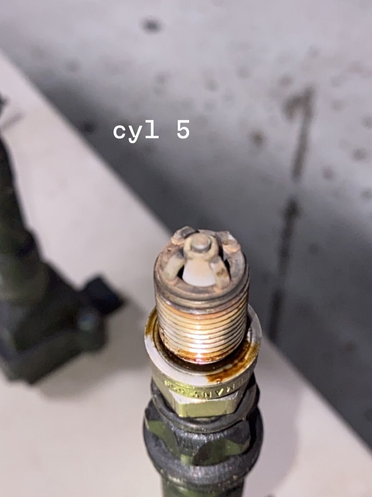

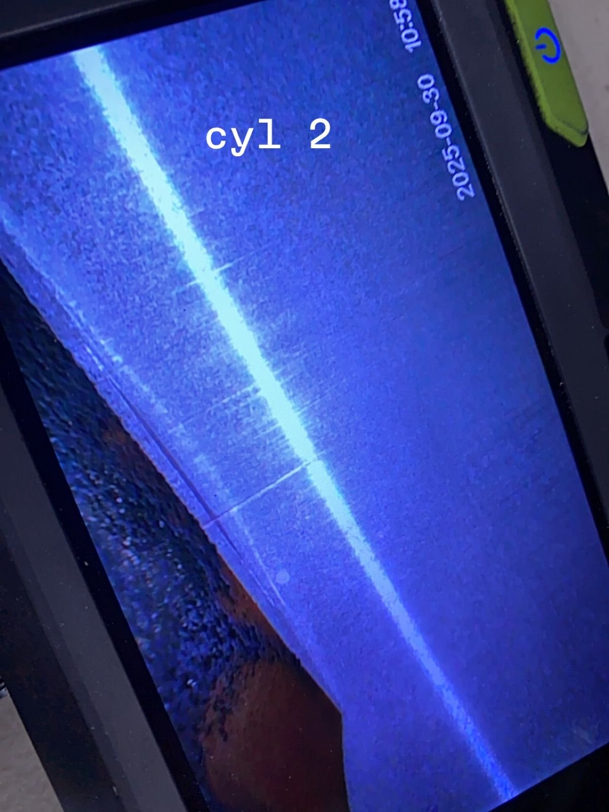

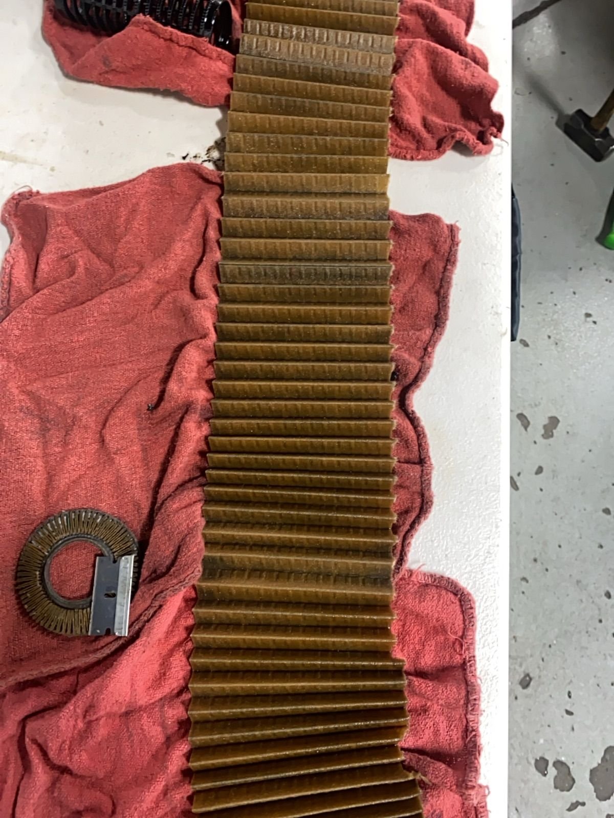

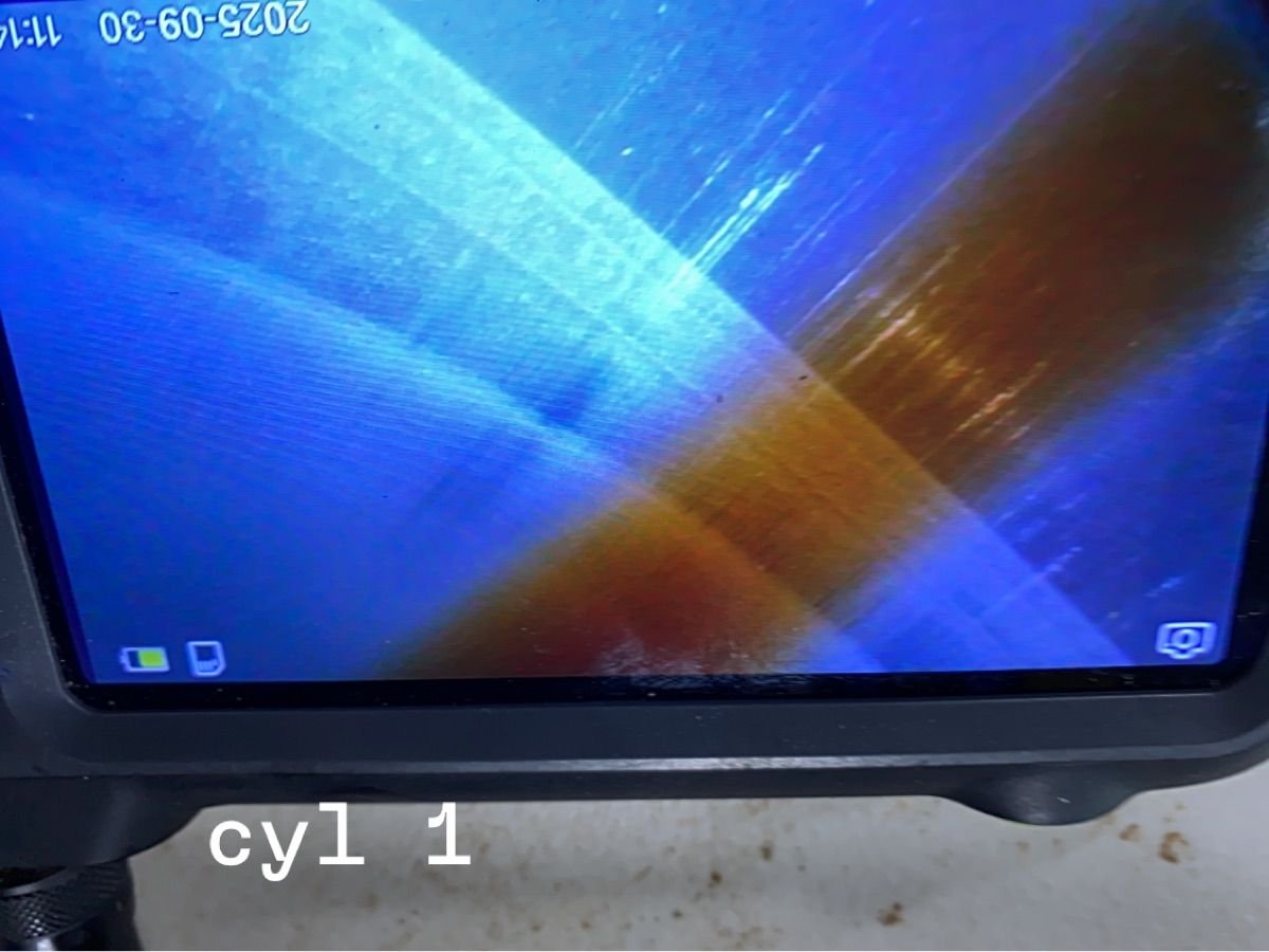

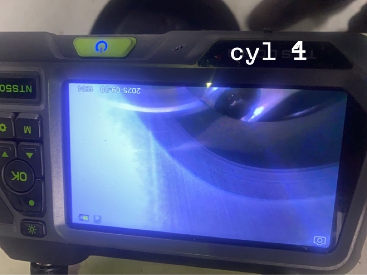

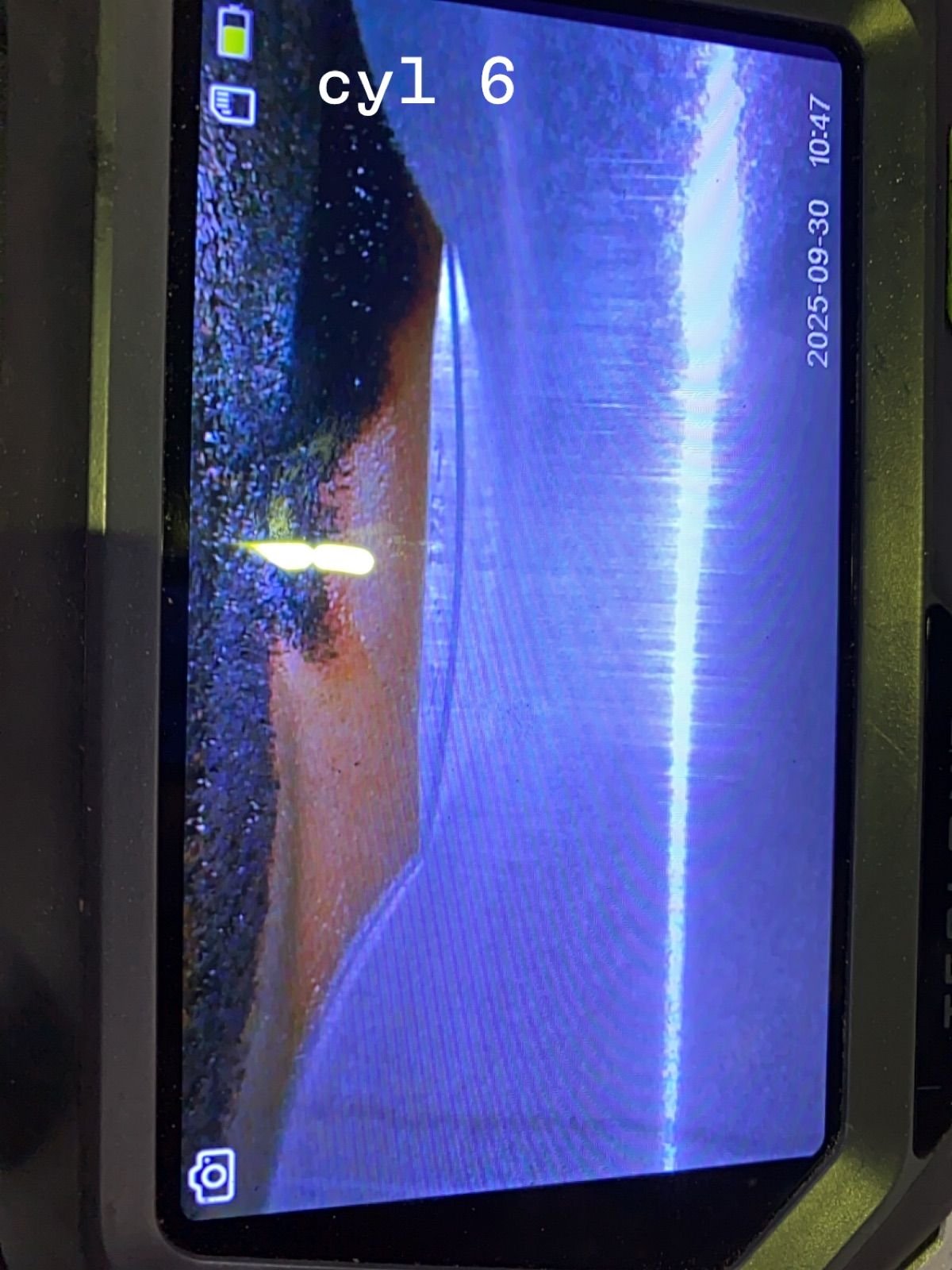

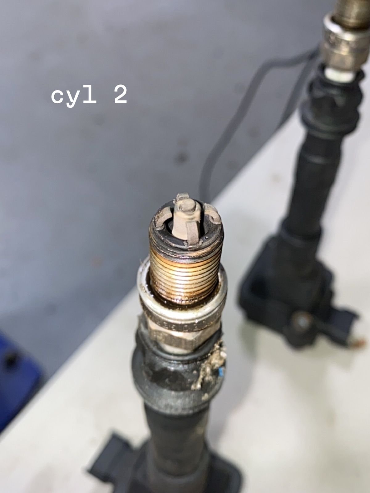

I had a car scoped today that I'm considering purchasing that has a 3.6x51 engine with ~35k miles. There is some light scoring on 1,2,3, and 5 from what I can see. The worst looks like cylinder 2. With cylinders 3 and 4, I'm not sure if that's light scoring or normal wear and streaks.
The filter and sump looked alright, nothing too large in there. The oil was too fresh for an analysis so I held off on that.
What are your thoughts on how these look?
I haven't scoped my own car yet which is a 2002 c2 with 68k miles. Oil analysis so far is good, but I'm looking to scope it soon.
A lot of photos, but TIA.

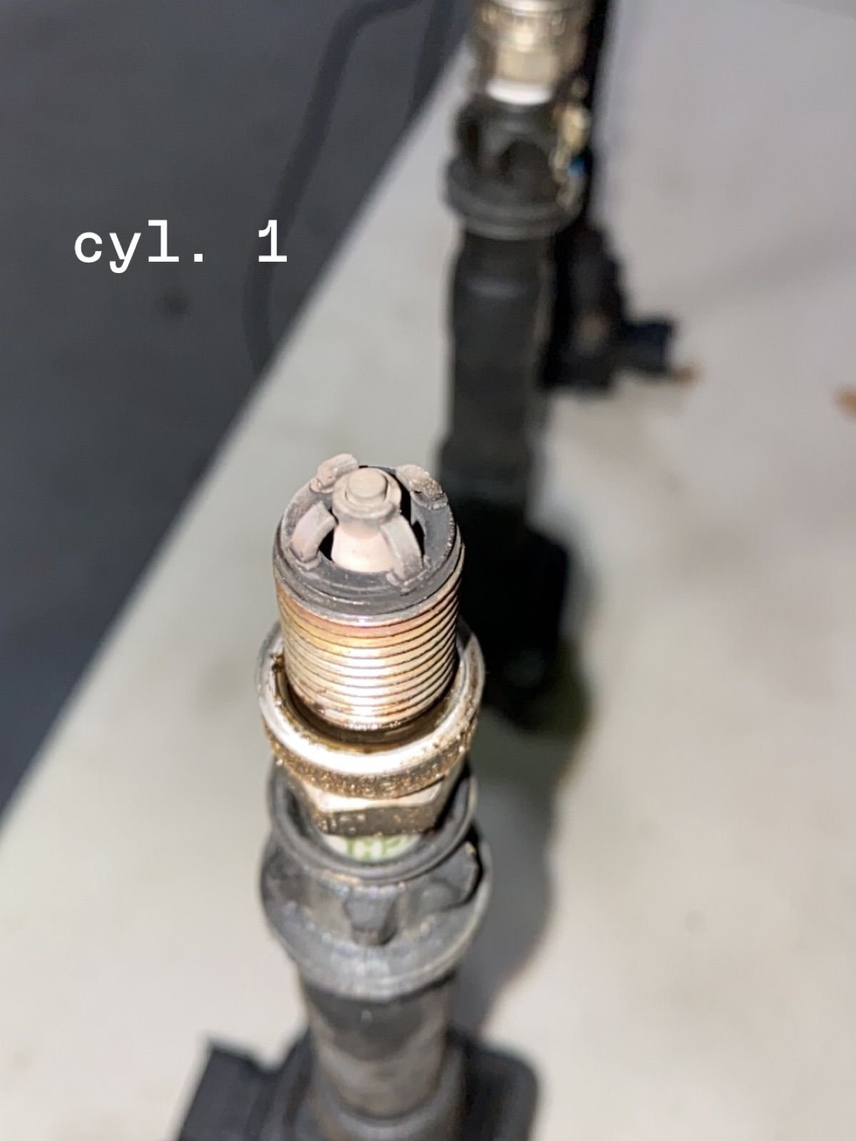

2002 C4S with 130K km; from my service last December:
BORE SCOPED ALL 6 CYLINDERS AND THEY ALL LOOK VERY GOOD!
Car has had the IMS solution for a few years now too; so I'm pretty relaxed about it.

Were the cylinders checked from the oil sump up, or through the spark plug holes?

spark plug holes; which i realize is less "100% conclusive". I was getting a little bit of misfiring due to the plugs and ignition coils aging out which is why they were in there. Even so I was happy that it was "good news".
Actually, spark plug hole bore scoping is 100% accurate contrary to some opinions. Hartech/Slacker, probably the biggest m96 builder conglomerate on the planet, agree and recommend spark plug hole scoping.
For those that disagree please show pics of m96 cylinders that only have bore score below BDC. Asked for these pics before and no one seems to have any.... Thats got to tell you something. Pics have been posted on this forum showing how spark plug hole scoping shows up all bore score engines.
But by all means don't believe and get under your sump, get oil dripped in your eyes and camera while trying to thread a scope thru convoluted wrist pin holes while turning the crank to get the perfect piston height to allow the scope to thread thu.... good luck with that.... many a scope has been pinched/crushed doing this unneeded procedure....
If no bore score seen from spark plug holes, you have none, you're good to go for sure...

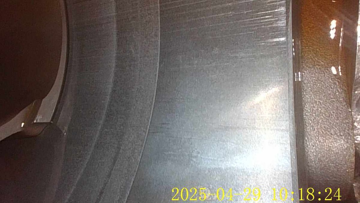

We just had someone who is looking at buying a used 2002 Porsche 996 just emailed us with this. The seller had these photos from a PPI done by a "specialty Porsche shop". The PPI stated “small stuff, nothing too scary” - but that's not true. I will say good on them that they scoped it through the sump, but this is very early bore scoring and something that you won't see from the spark plug side. At this point, it's going to fail from bore scoring - it's not a matter of if, but when.
The whole point of scoping through the sump is make sure that it hasn't started at all yet. Through the spark plug won't tell you that.

Don't know why Hartech thinks all borescoring can be seen from the sparkplug holes, when it starts at the bottom of the cylinder walls. Doesn't matter, I'll stick with recommendations from Charles.
When it comes down to it, it's your car/potential car, and your money. Do what you're comfortable with. I'm on the search from my next 996 and when I find a car I like I'll pay to have the sump dropped and the cylinder bores scoped from the bottom. up so I have peace of mind.
As for no one sending Allcool pics of borescoring below BDC, Charles just did. The vast majority of 996 owners are not on this site, and those that are may not be paying attention to his post so no reply's doesn't mean it never happens.
