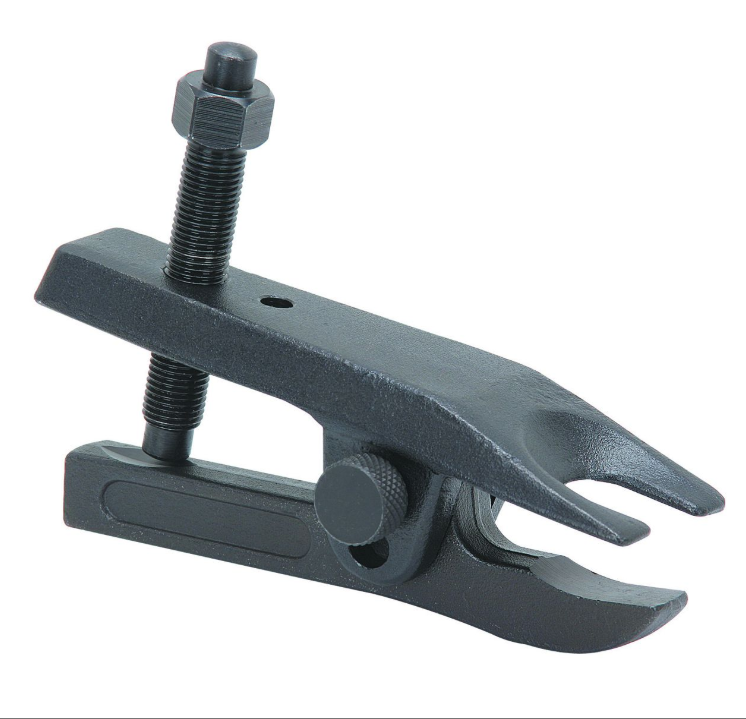

You need one of these:
Ball joint separator
There are lots of manufacturers.

Thanks for the reply. I have one but you can’t use it on the rear LCA. You need to use a pickle fork

Why cant u use the tool? Up bolt the shaft and slide the upright out. Its more work but its how its done.
thanks I’ll give it a try. Both the FCP Euro video and the 101 project book say you need to use a pickle fork.
