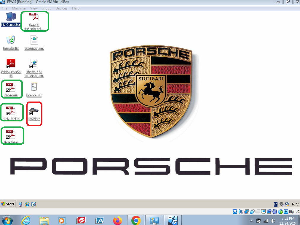

If you are wanting to learn this is a great opportunity to learn .. Here is picture of the PIWIS VM home screen... The green Icons are PFD's with information on how to use PIWIS tester and the capabilities of it.. There is literally thousands of pages of Info..Once you get the software installed on you Laptop you can read all the info..
Even after reading all the info you will not know all the possibilities, so if a particular scenario/question in mind just ask...
One very unique and helpfull feature on the PIWIS Tester for wiring diagrams for 997 and up is the " Interactive Wiring Diagrams " that are in the Tester. They allow you to highlight a particular wire/circuit or multiple ones and change colors on them to easily trace the circuit in multiple branches on multiple pages... Too bad the 996 wiring is not included in this..
The PIWIS software also contains all the programs for all the Control units on all Models...So the old control unit can be "read" and the info "written" to the new control unit .. or the new one can be programmed with the program in the Tester if the old one is unable to be "read" ..( the old control unit will contain coding specific to the VIN, whereas if the old control unit cannot be "read" the new control unit will be programmed from the Tester and the "coding" will have to done manually to the options of the VIN )
The Icons circled in green or info/how to files in the Virtual Machine , there is more info in the PIWIS program.....the icon circled in red starts the PIWIS Tester...
Load it up and enjoy !!
