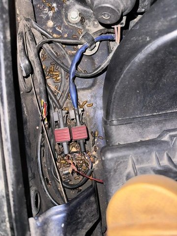

Help! I have a 2002 996 C2 with rat damage. What do these red connectors go to so I can order some new wires?

O2 sensor connectors.

Except the wires gojng to the 02 (after the plug) look fine. U need to either repair or replace the harness section. Places like DC Auto or LA Dismantlers can sell u a used section of harness to splice in.

To the OP, the wires look long enough to splice them back without buying anything. Good luck.

When I first got my 996.1 had similar problem. Had a slew of dash lights on, this was 1 of them. Just spliced wires back together with butt connectors. Was going to solder them at a future date after taking care of more pressing problems, but its been over a year and o2's been working great since my butt connector repair...
Even if you need to remove damaged factory connectors and neatly/correctly splice wires together with male/female butt connectors, o2's will work fine.

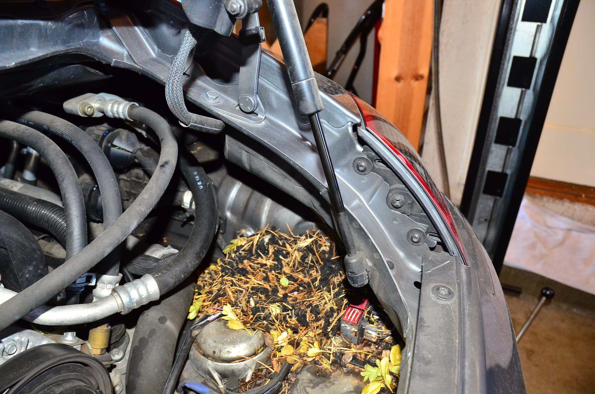

LOOK FAMILIAR, guessing those o2 wires are especially tasty....
